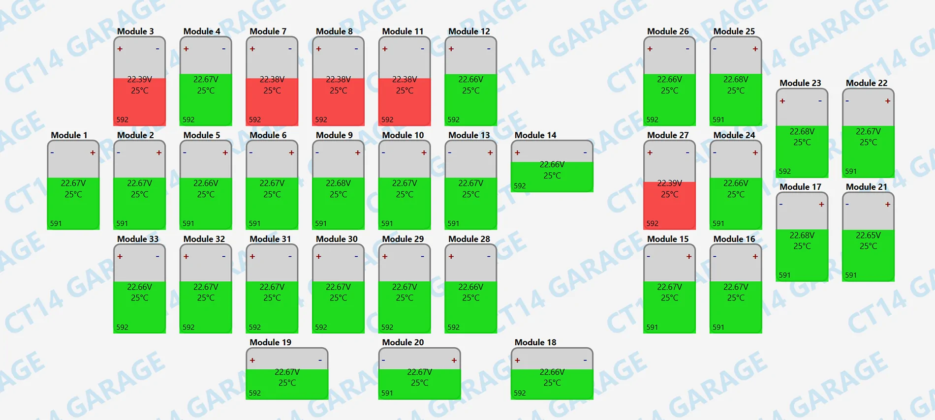

I had a little free time today so I hooked up a scanner and clearly they replaced 5 modules. I also verified that they upgraded the PCM software to v3885 (not part of the battery work but because I asked them to upgrade it for better stability).

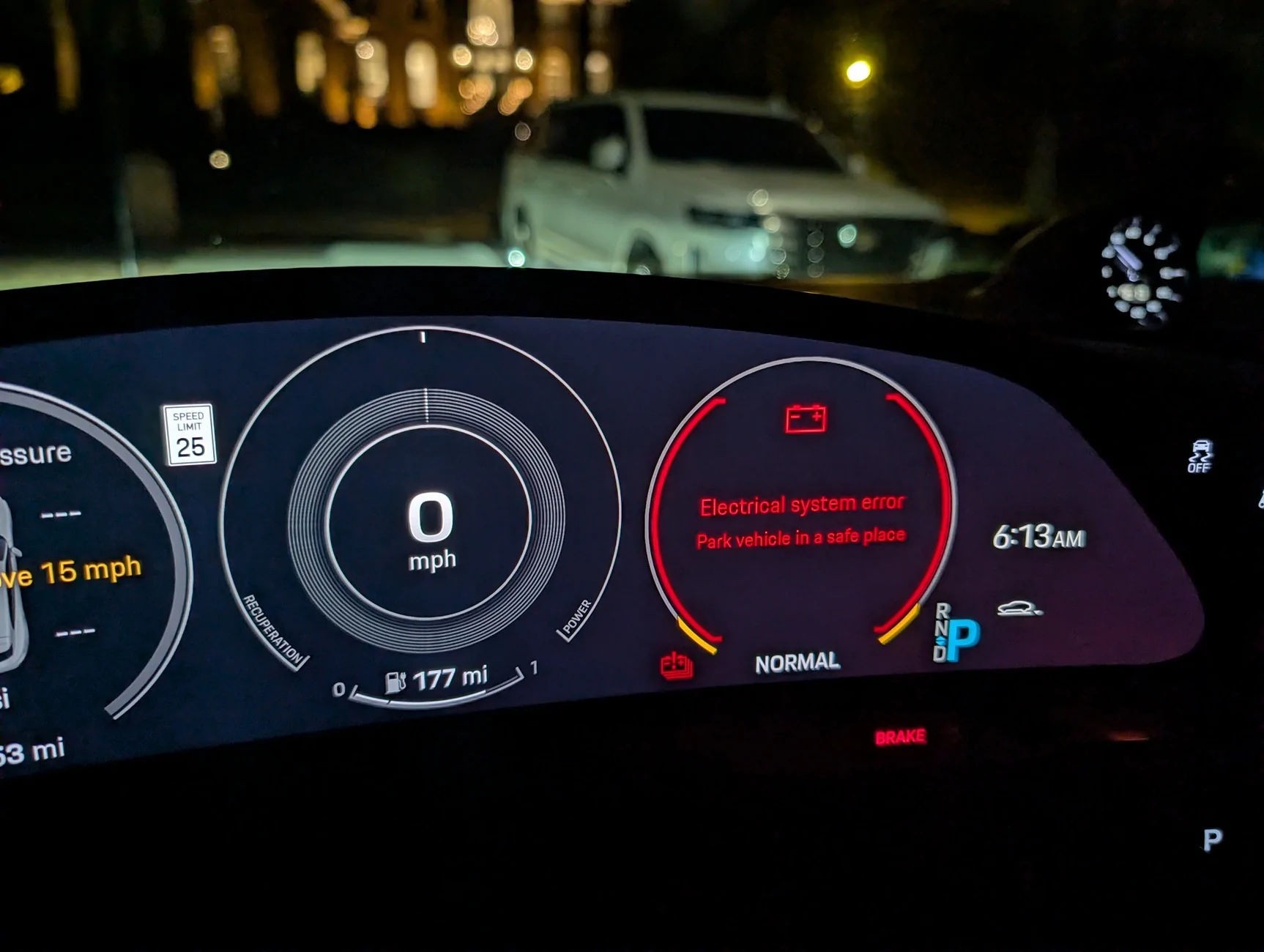

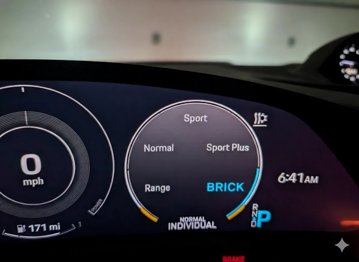

Well, two months after getting the car back I woke up to the red circle of death again. Seems I must have shifted into BRICK mode by accident 🤷‍♂️. Did the whole turn it off and back on thing and it did clear after some time. Schedule for next Friday to take it in. It's not clear right now what the next steps are though. The first time around when it was in the intermittent phase the diagnostics found no issues and they couldn't take any action other than to hand me back the keys. It wasn't until it fully bricked that they could diagnose and repair.
So, here's to a week of German roulette.
