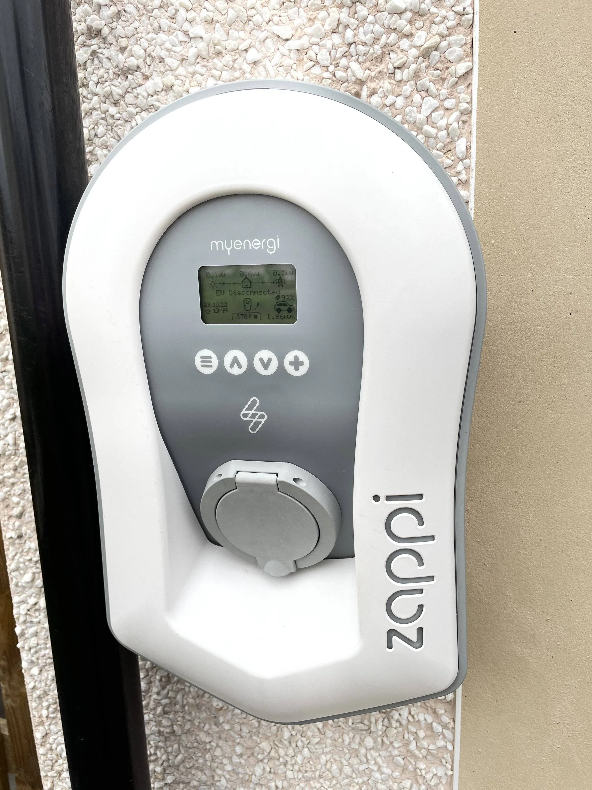

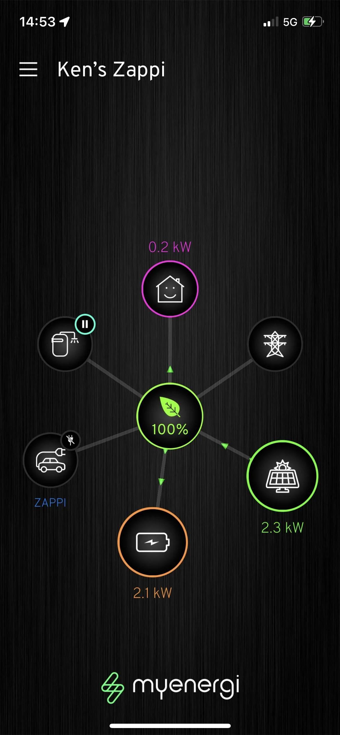

I have a Zappi but the untethered version
I just didn’t want the cables hanging I’m a bit ocd but you can put a pin in to lock it if u need
fantastic charger very easy to use and quite satisfying on eco plus during the day charging for free from the panels or overnight on fast charge
Ap is simple to use
