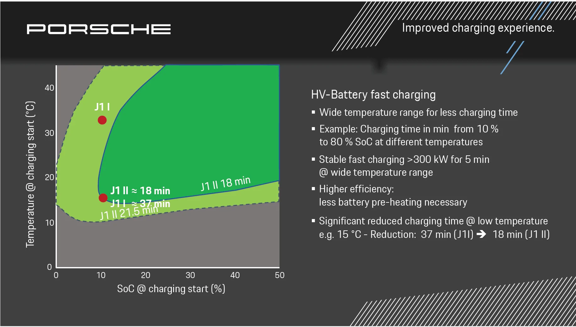

This explains it with data to support the fact that J1.2 has lower starting temp for optimal charging.
Porsche Taycan “Battery Prepared for Charging” 1765327403532-z0

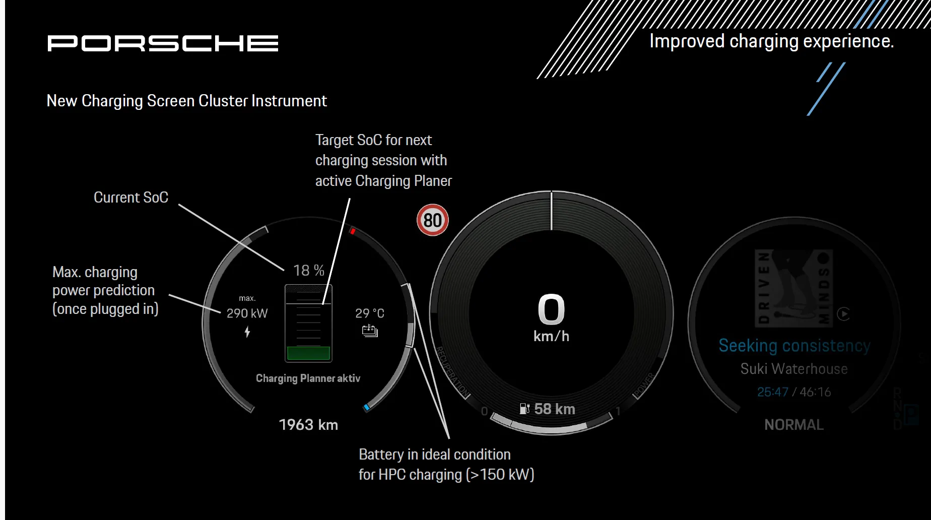

Also, lucky you J1.2 owners you have this new gauge that we J1.1 owners only can dream of.
The car tells you if the battery is in ideal condition for charging - 3 o'clock area on the left tube.
Then if the car does not get the max power from the charger it can take - 9 o'clock area on the left tube, it will issue a blame the charger message. This is just awesome!
Porsche Taycan “Battery Prepared for Charging” 1765327539345-2j

Thx for the replies. I have been looking at the gauge and thinking that ”battery is prepared for charging” meant that the temp would be in that 3 o’clock range before I plugged in, but it wasn’t—quite a bit lower. But, if it is working as designed, maybe the idea is that it knows it will get there quickly once charging starts so doesn’t try to warm it beforehand and use all that energy.
