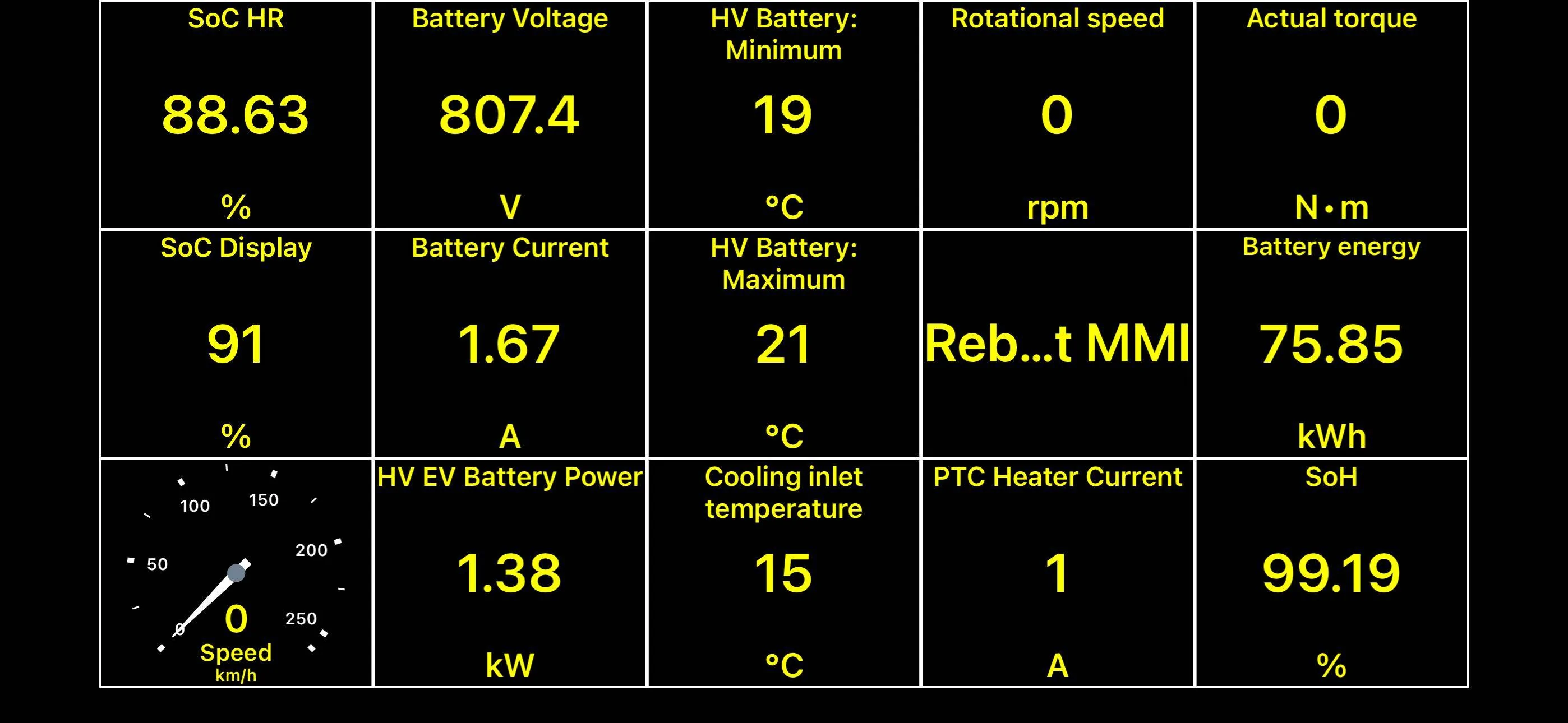

For some real-world data, I've been charging at home at 35-40 Amps for the three years and 33,000 mi I've had my Turbo S. Charging pretty much every day to 85%. Very rarely charged to 100% (maybe a dozen times), and only 20 or so 'fast charges' at Electrify America over that time.
I had two bad cells identified and both modules replaced a couple months ago. My battery SOH is 92.6% as measured by the specialized battery technician they flew in from Atlanta - so I believe this is a good number. If you take out the 2/33 modules that are effectively 100%, that gives 92.1% SOH of the other cells. I think this supports the method of daily at-home charging to 85%.
As you may recall, I also had two modules replaced in my battery in September. I have not been able to get a proper reading by a Porsche specialist or the center where the battery was repaired as yet. I have observed a similar pattern at lower SoC (50%) as you have shown, where the new modules have a higher cell voltage than the older ones. Not very significant as yet but will check when I can get a Low SoC. My SoH is still over 99% which can not be correct. Mileage is 36,370 miles (58,550 km).

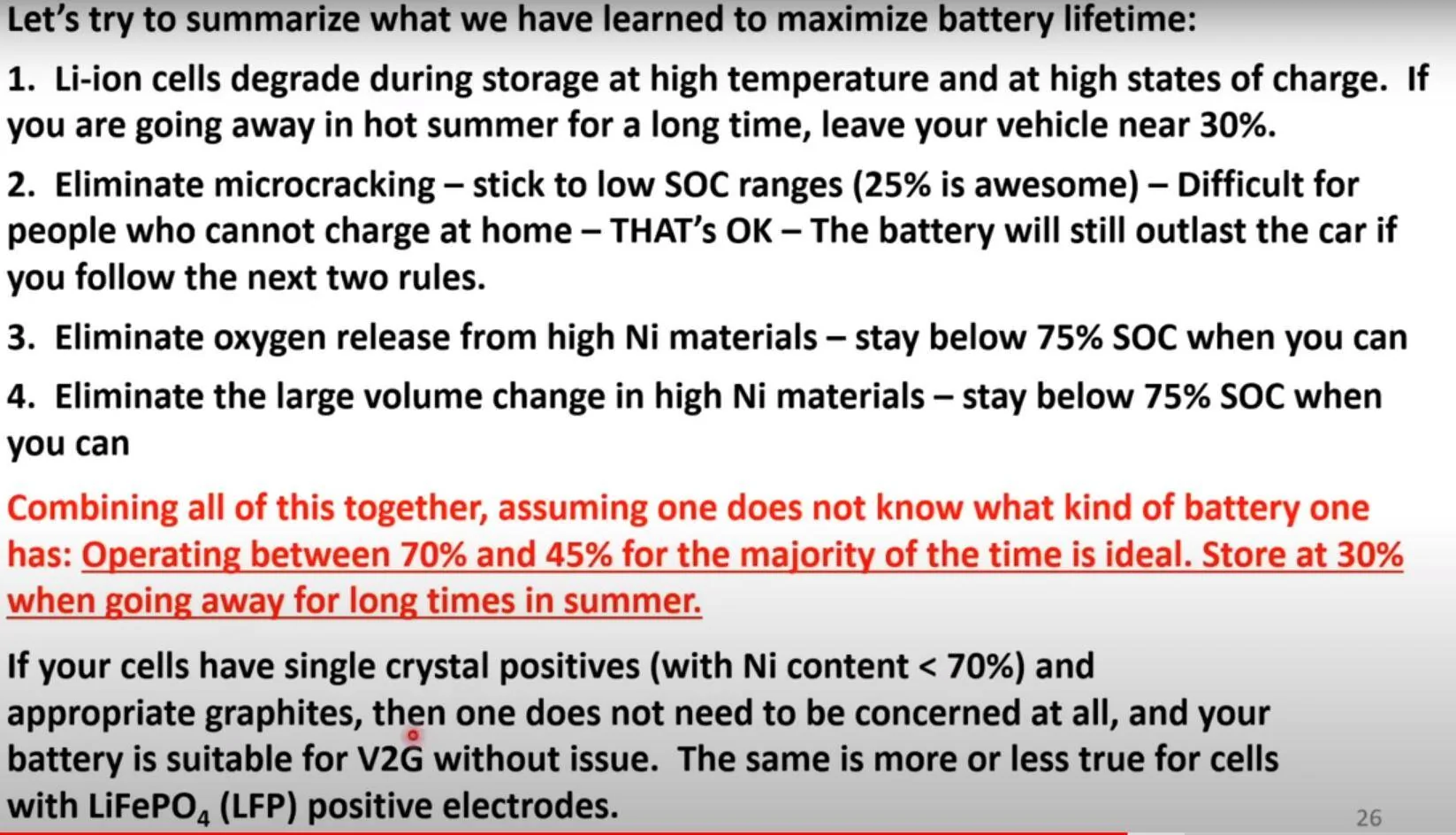

@Scandinavian Thanks for sharing an excellent video.
Summary of his recommendations:
Porsche Taycan "Best practice EV charging for longer battery life" - video 1700326401702
His summary starts at 41-minute mark. But it is well worth watching the entire video.
After watching the video, questions in my mind:
--For typical Taycan owner and use case, will following Dr. Dahn's charging recommendations have any noticeable effect on battery performance, compared to sticking with Porsche's charging recommendations?
--What kind of HV battery does Taycan have: Ni content, single crystal positives, etc.?
Dr. Dahn's advice seems to agree with that of the YouTuber in post #1 above.
