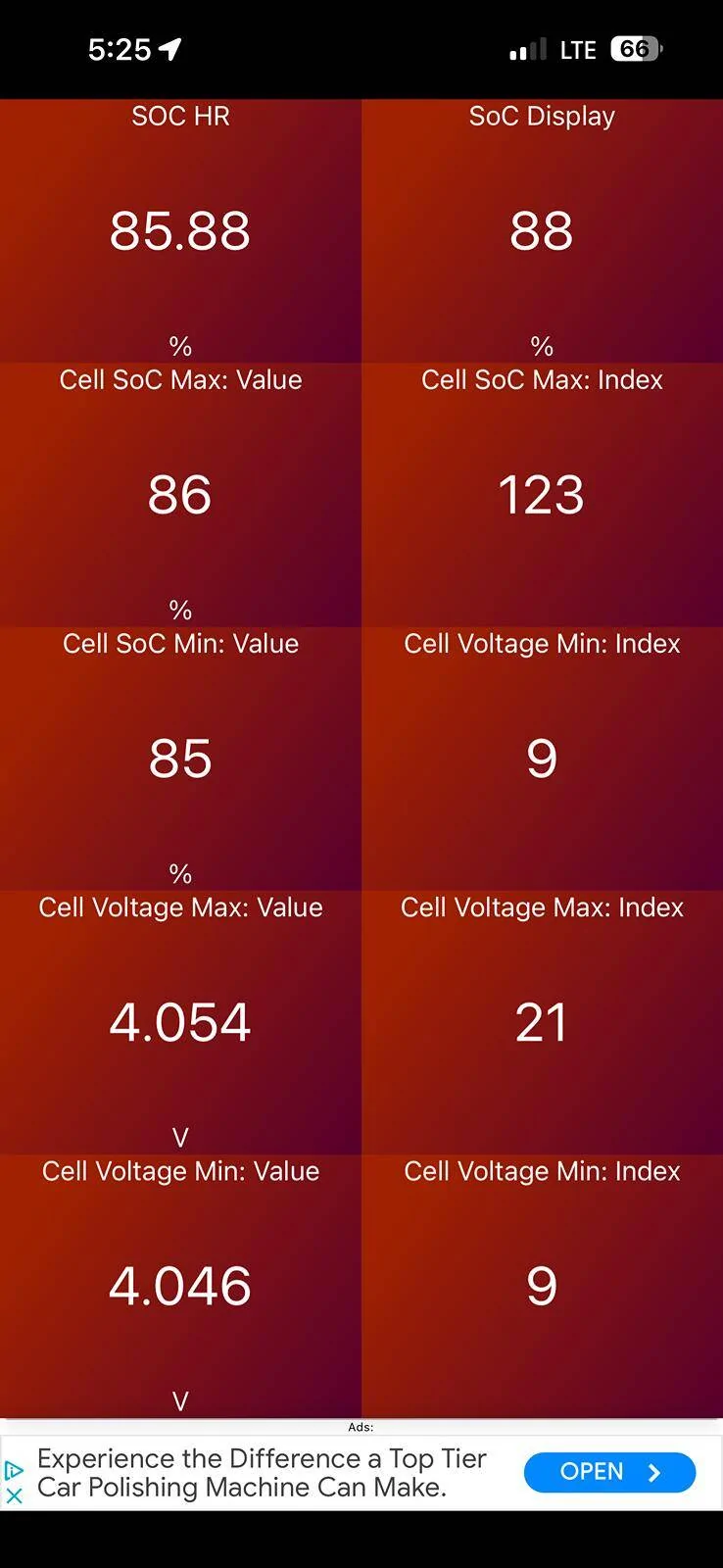

So he says 75% AND/OR limit to 4.06V. I'll test 75% on my car and see what the voltage looks like.

Ok, I overcharged because of a timer anomoly. :(.
At 86% my cell voltage is below 4.06v so 85% charge is probably fine for my vehicle.
