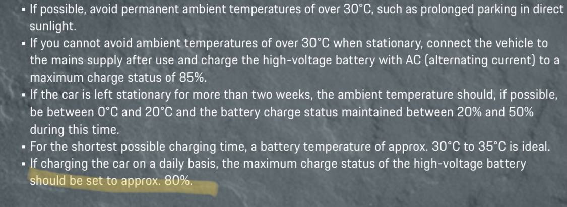

I read the manual as it being a max of 80% maximum charge for daily operation unless the ambient temperature is above 30C when it increases to 85%.
Am I interpreting it wrong?

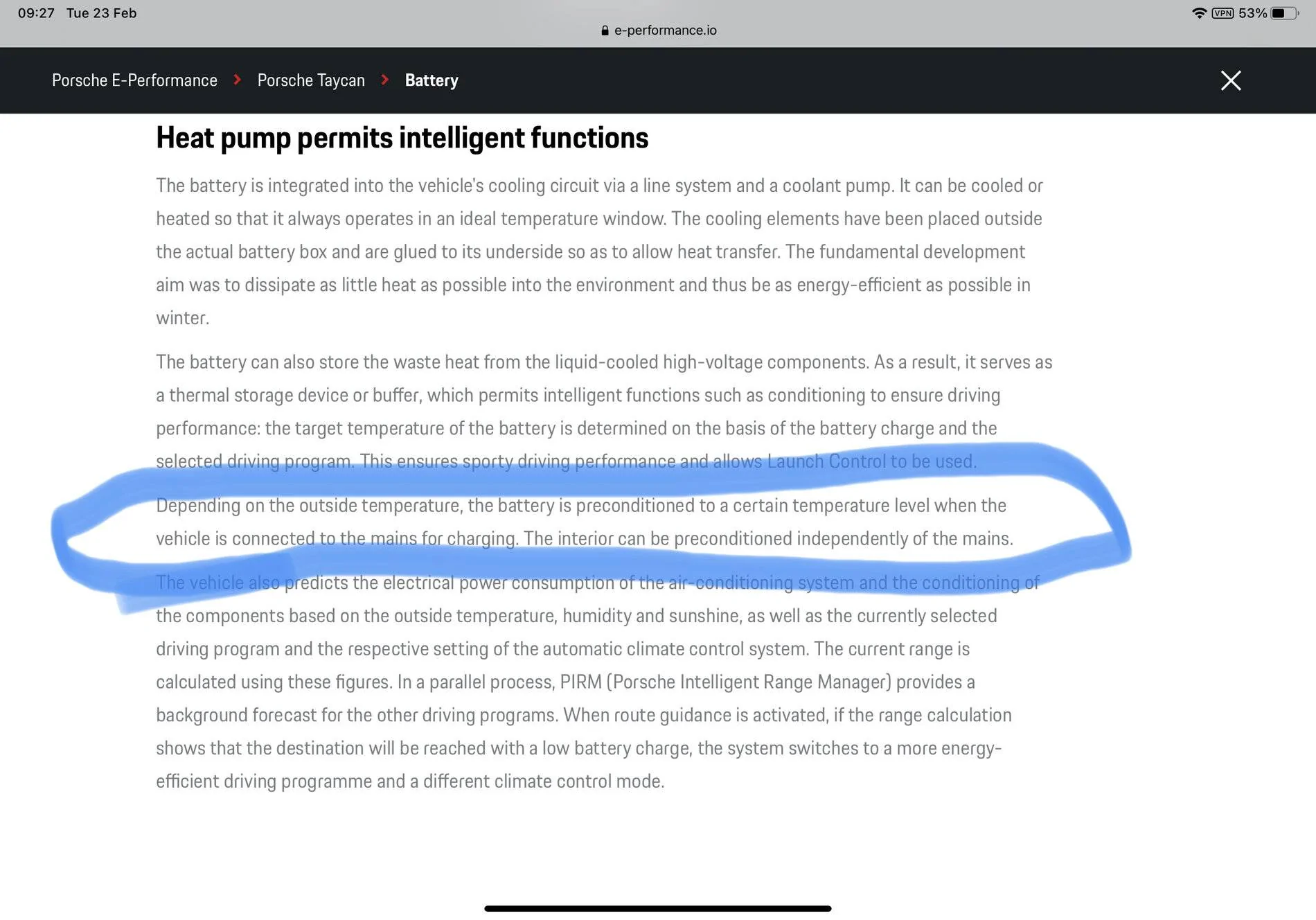

You are wrong about your statements regarding preheating when plugged in. The battery is prewarmed as well as the cabin if you are plugged in with enough power for the charger. Of course this all depends on the outside temperature if it is needed. There is one thread here where the facts are very clear. They measured both the increase of the battery temperature as well as estimated how much power was used for battery heating or charging.
It is also clearly state£ in the Good to Know app as well as the Technical documents.
https://e-performance.io/en/article/taycan-battery

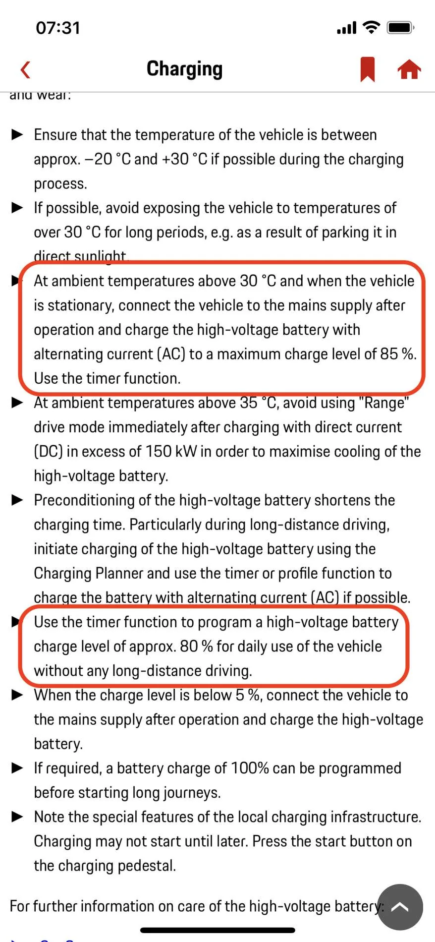

I am sticking with 85% max, except on the day itself of a longer road trip. I got my Taycan last year when the recommendation was 85%, but did Porsche not lower that recommendation to 80% this year (2021)?
yes, from what I've read porsche is now recommending an 80% max for daily usage. it is ok to charge up to 100% for a trip, just don't let the car sit at 100% for a long period of time. in addition, I don't know the exact SOC but it is not advised to allow the car to sit for a long period of time at a very low SOC either. in the tesla it was 20%. try to charge the car when it is at low SOC.
No I agree with you and in another thread posted some other Porsche fine print that said 80%.
My owners manual says 85%. My buddies both charge to 90%. But none of us will have these cars "long term" and they don't really care as long as the battery is good for 3-4 years.
