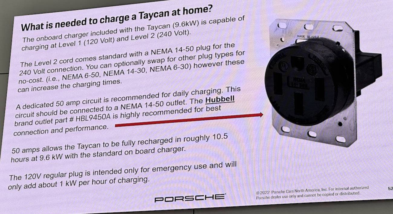

Update Dec. 2022 - Porsche now recommends the HUBBLE industrial/commerical grade NEMA 14-50 (or 6-50) plug sockets. I agree 100% with this recommendation and in my opinion it is a requirement, not simply a recommendation - you would be wise to follow their (and other EV vendor's advice) and specify the Hubble NEMA plug socket to your electrician - do not accept lesser alternatives.
