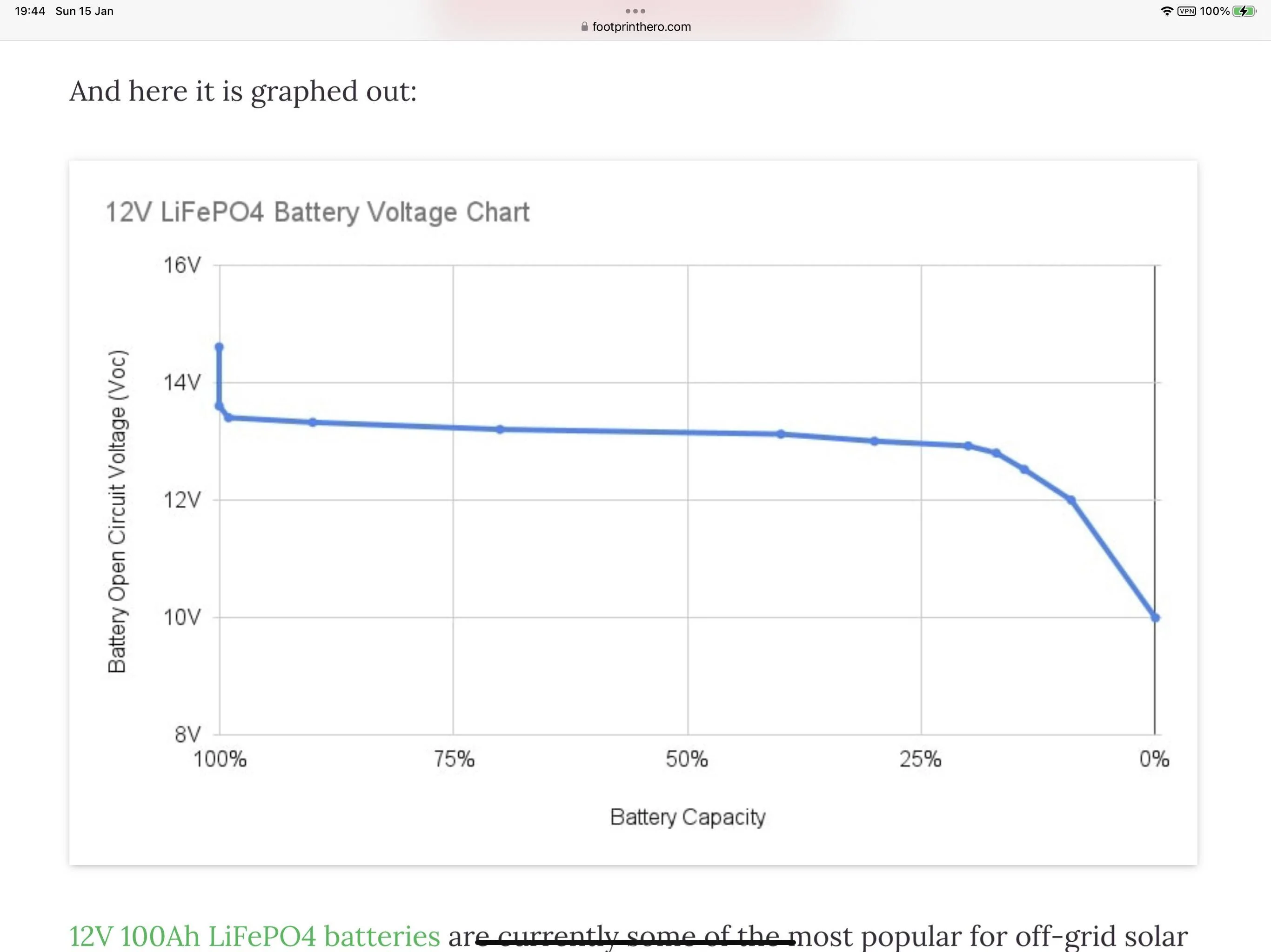

If you look at the discharge curve of a Lithium battery it certainly suddenly falls off a cliff edge.
Could this be triggered by a sudden drop in temperature?
That roll off discharge characteristic is just the nature of the beast with lithium batteries and why the BMS is so crucial so it know precisely where it is on / before the cliff edge.

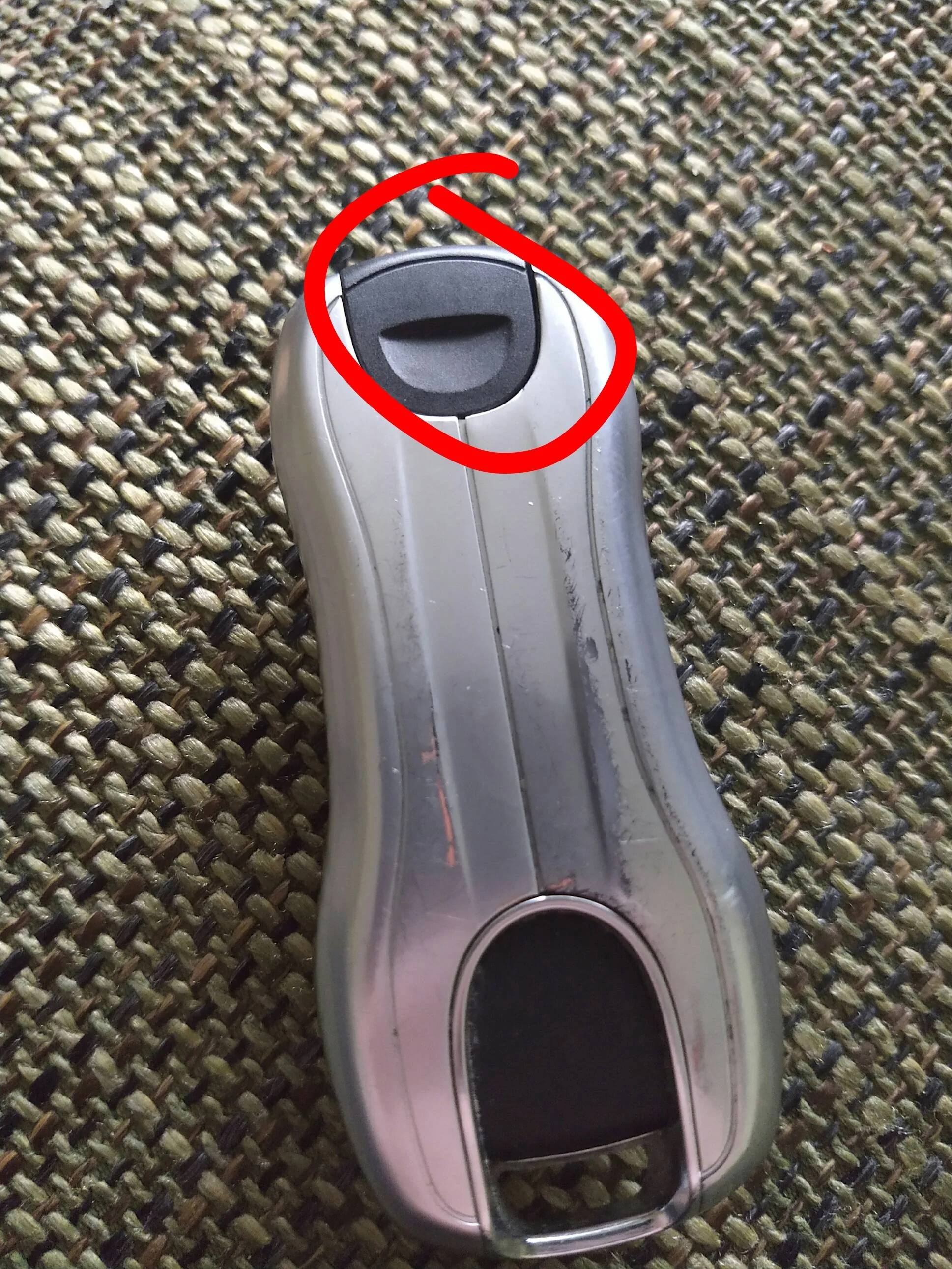

Stupid question: where is the physical key And where is the physical lock hidden?

ThnX found both.
