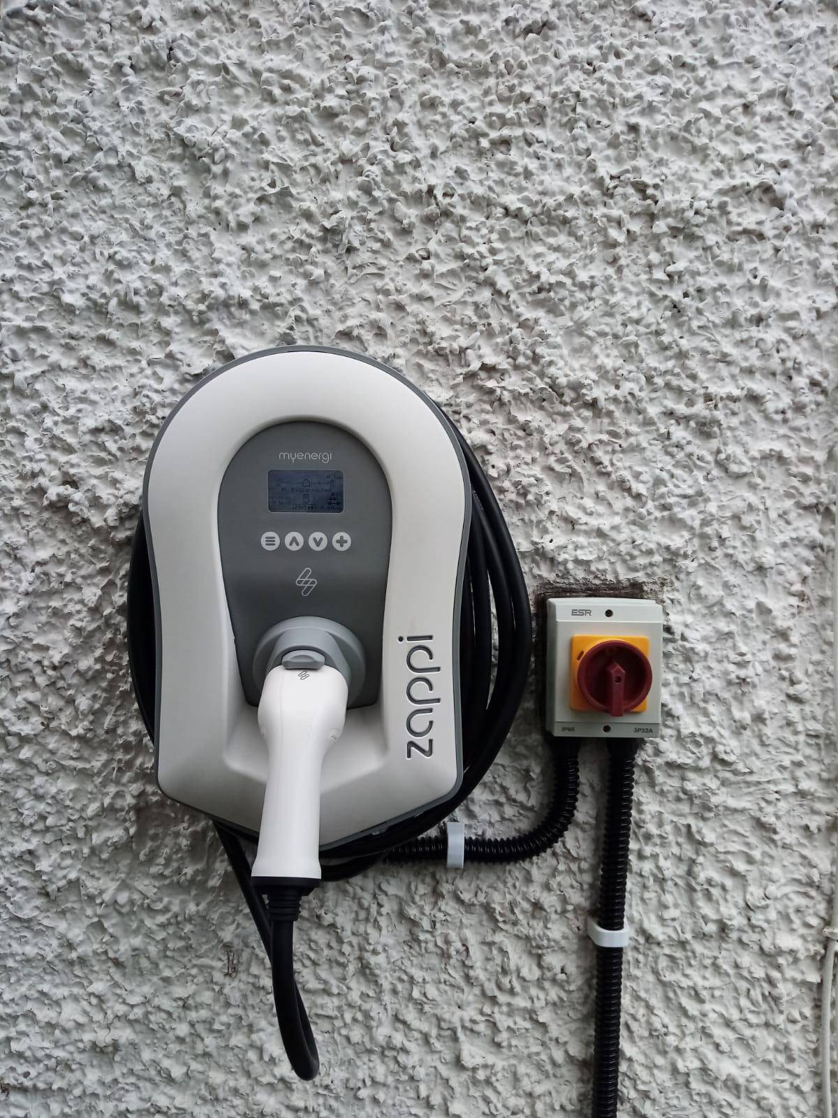

Here in Ireland electrical regulations state that all EV chargers over 3kW – must be:
  1. Hard-wired back to fuse board.
  2. Have its own dedicated circuit that is RCD protected.
  3. Have an emergency shut off switch (ugly) within reach of the charger.
  4. Have the exact charging installation – including pictures – registered with the government regulator (called Safe Electric Ireland).
Doing all of the above does have the advantage of getting you a €600 government grant towards the cost of the installation/charger.
Typical installation:
