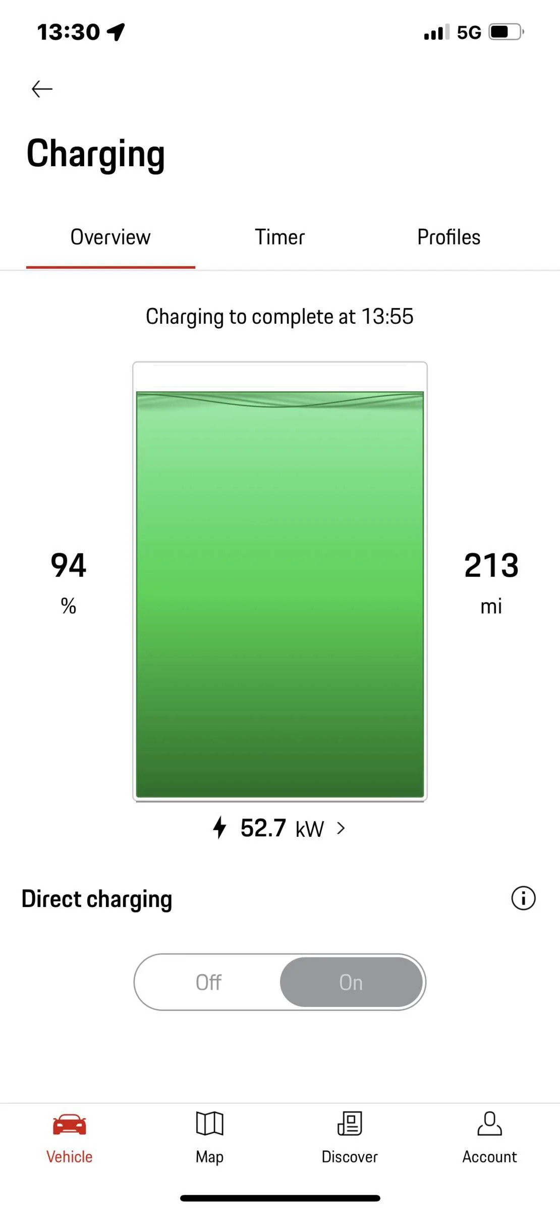

yeah - but in reality the taycan spends very little time above 200 kW - but can spend most of it's entire charging level above 50 kW (the key limit being discussed in this thread) - based on my 2020 Taycan at local 150 kW/800V EA chargers - my Taycan rarely dips below 50 kW until well after 93 or 95% SOC…so for well over 90% of the entire charging cycle the Taycan can and does charge at a rate more than 50 kW…
one charging session @ EA station in Aptos, CA near my home I was still charging at 52.7 kW @ 94% SOC - and didn't dip below 50 kW until 96% (see picture)
so the taper curve of the Taycan will charge the battery at more than 50 kW until about 95% - viewing kWh as "area under the charging curve" [which is fact what it is] - 2% to 95% range where you could be charging at more than 50 kW will save a LOT of time at a charge…I mean if the charge rate was below 50 kW at like 70% SOC (like my Model 3) yeah that's not as much as a savings
but my Taycan can certainly charge at more than 50 kW for virtually all of it's battery's charging capacity…but if I'm limited to 50 kW - well then that's going to take quite a bit more time.

oh and 10 points to house @DerekS - yeah that's exactly what that option does - but only compromises the charge rate for the early 30% and capping it 200 kW is still way higher than the 150 kW limit we're talking about here - so charging at 150 kW is both good for the battery (based on optional porsche's 200 kW limit) and faster than 50 kW…
but yeah - you caught me - you win - like I said 10 points to house @DerekS
so the taper curve of the Taycan will charge the battery at more than 50 kW until about 95% - viewing kWh as "area under the charging curve" [which is fast what it is] - 2% to 95% range where you could be charging at more than 50 kW will save a LOT of time at a charge…I mean if the charge rate was below 50 kW at like 70% SOC (like my Model 3) yeah that's not as much as a savings
