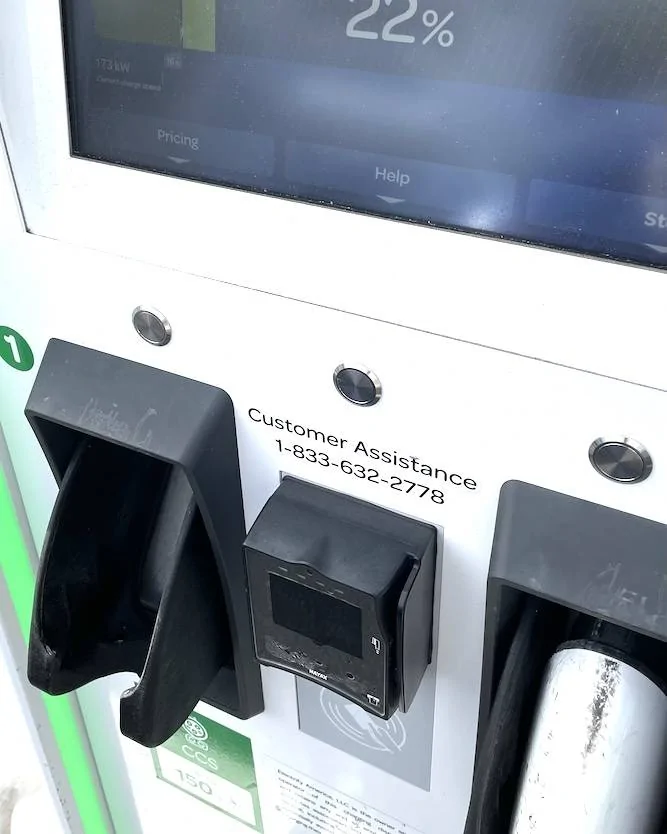

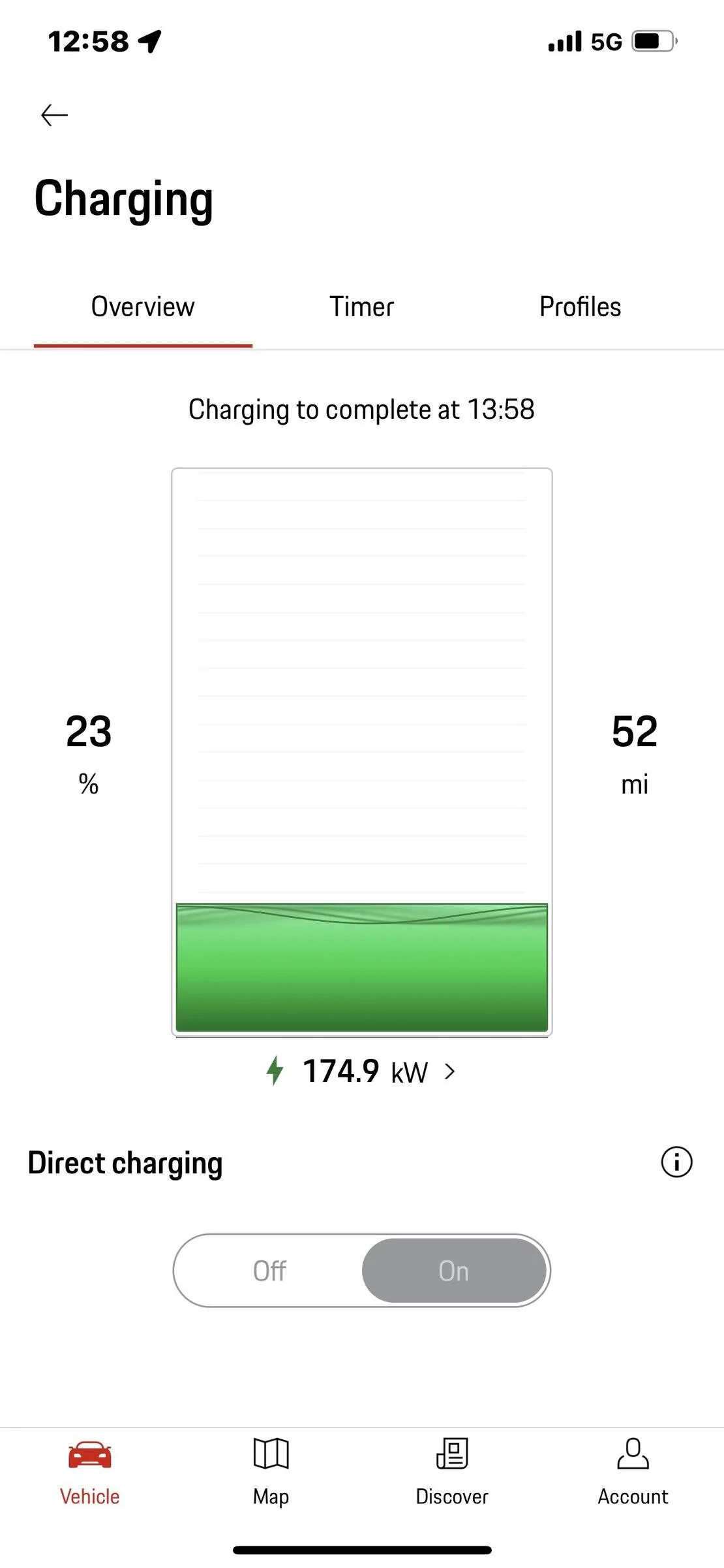

screen shot below is from a charging session Feb. 26th, 2022 @ EA 150 kW charger in Aptos, CA
charger and car showed virtually identical kW ratings…in this case 174.9 kW - while the charger itself is rated/advertised for 150 kw.
