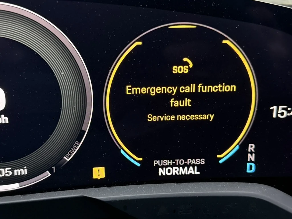

2025 ST Turbo, now has 29k km (18k m). They had to replace the communication module because Porsche connect services sometimes worked a few weeks, then a few weeks not. Since the replacement nothing else.
Mine is in to be looked at tomorrow. I think it is communication module on mine. Came up with an emergency call fault and no longer updates in the App. Tried all the resets and now cannot log into the car, everything else is perfect.

I dont know if it is the same fuse on a .2 but A11 should cause a hard reset of comms module and may clear it.
Silverback
Ian
Apr 20, 2020
73
49
Taycan GTS, Model Y
Thanks. I just handed over the keys just now and sat in the dealership, otherwise I would have given that a go. Will update on what the fix was if I can find out.
