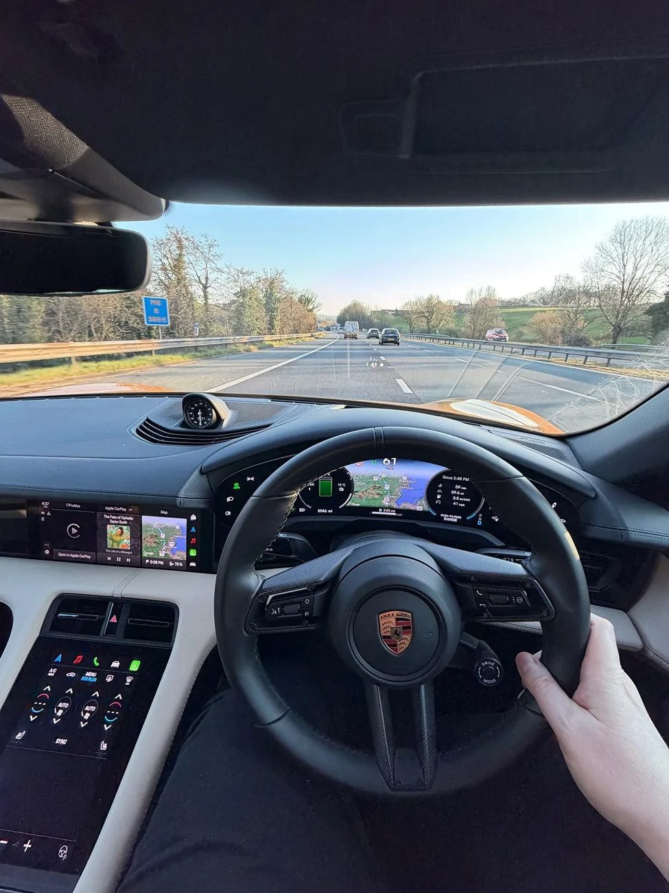

Nothing bar an intermittent rattle somewhere in drivers door. So minor I can’t be arsed booking it in to OPC
