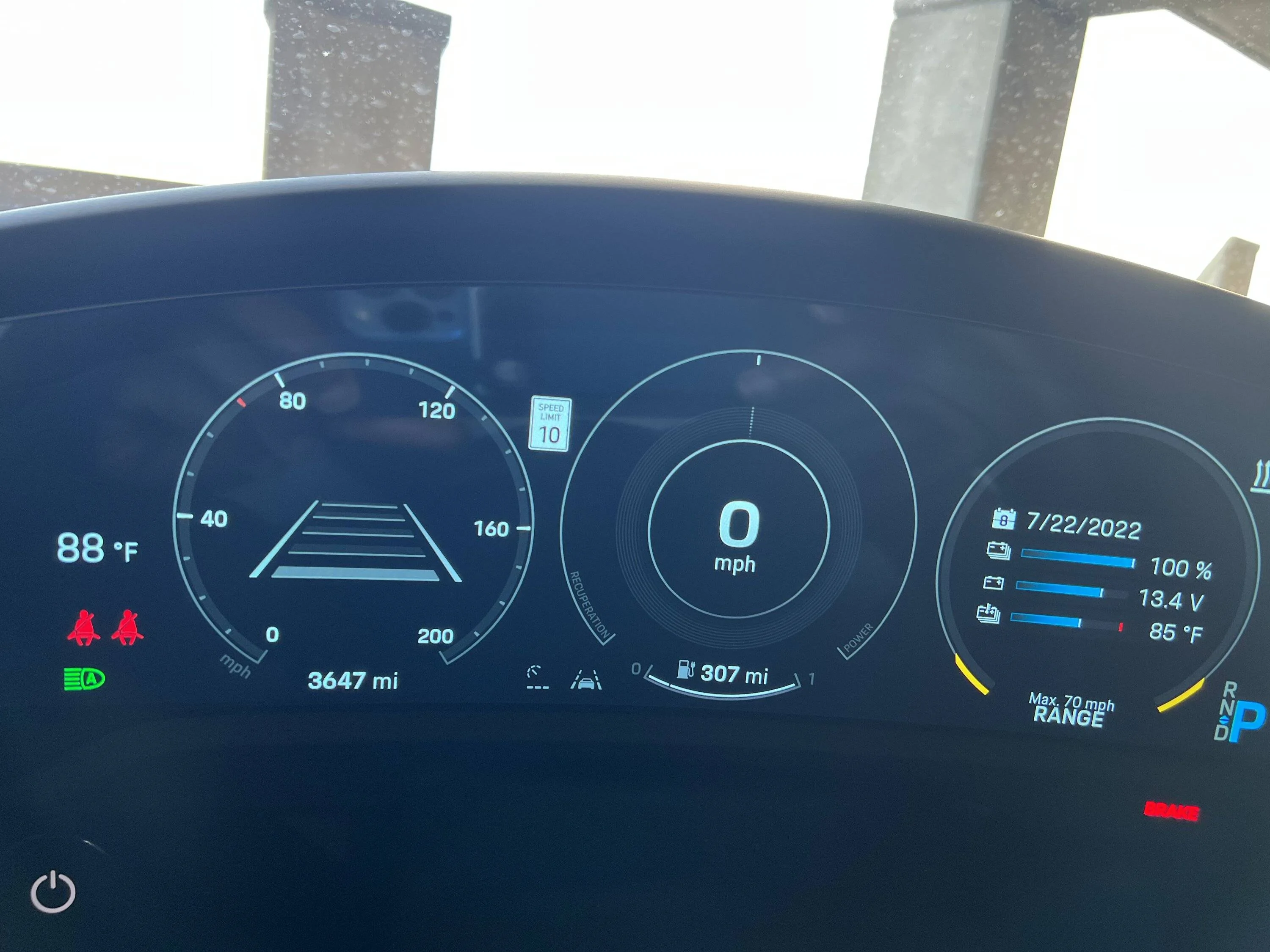

The most I have ever achieved, which was earlier today, was 307 miles with both range mode and Eco+ on.

The high potential range is misleading as a) the battery is warm from a charging session, b) ambient temp is mid 20s, c) the car doesn't know how or how far you are going to drive, d) assume Performance Battery Plus for the highest ranges..and no doubt a few other things besides.
AC off will add miles for sure.
Range mode will add a few but not many.
Trip readings for a single journey will give you a consumption figure - short journeys the number will be low and longer ones higher (typically).
Total Trip Since will give you an average since you last reset it. If you haven't then the consumption figure will be a good average for the life of the car.
The main Porsche Taycan website has a range estimator which is quite useful as you can tune to suit your use case more or less.

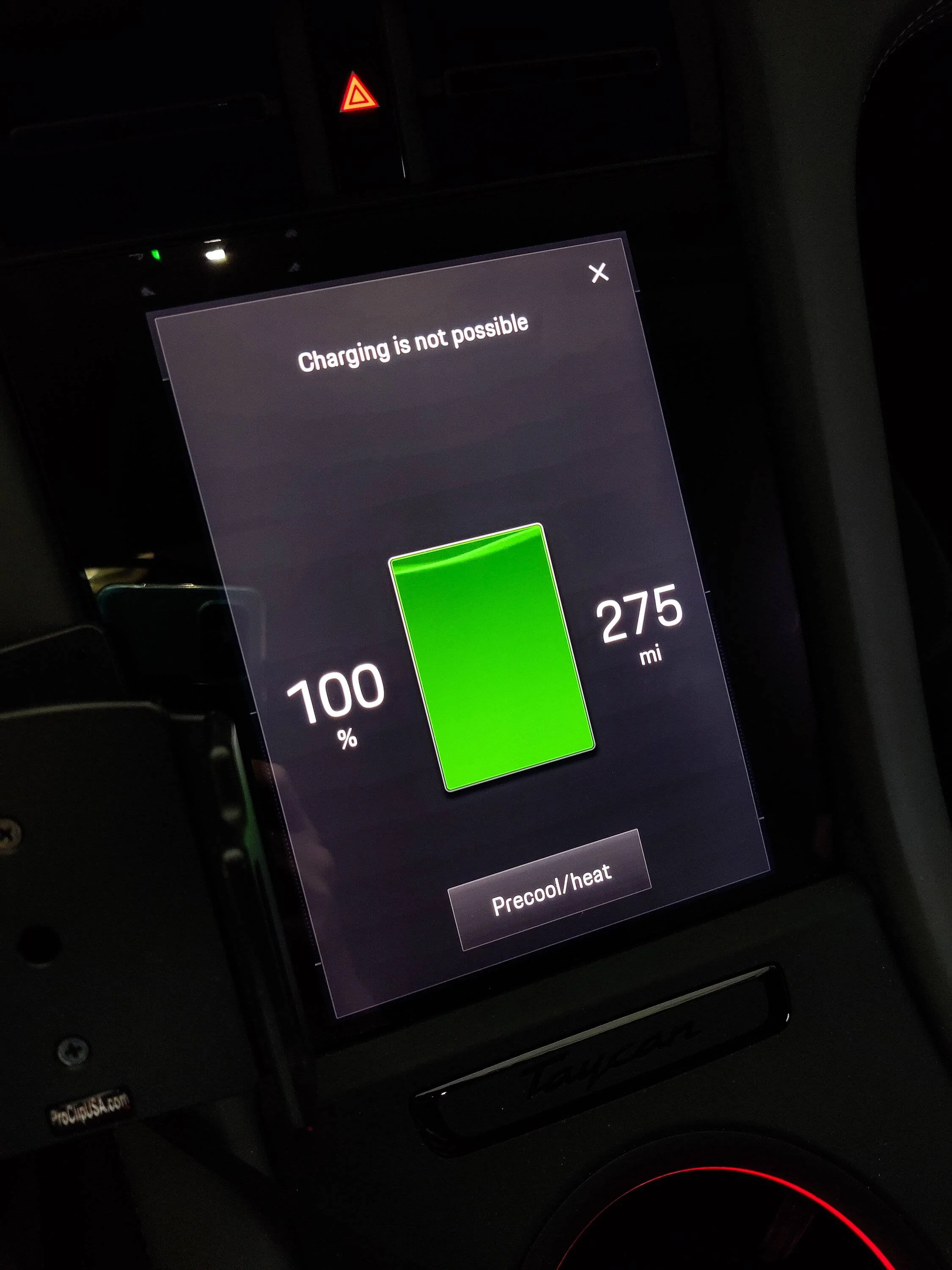

Porsche Taycan 271 miles!  100% charged. What’s your range shown? F55E09E5-03C3-4538-BE26-B111A4264C41

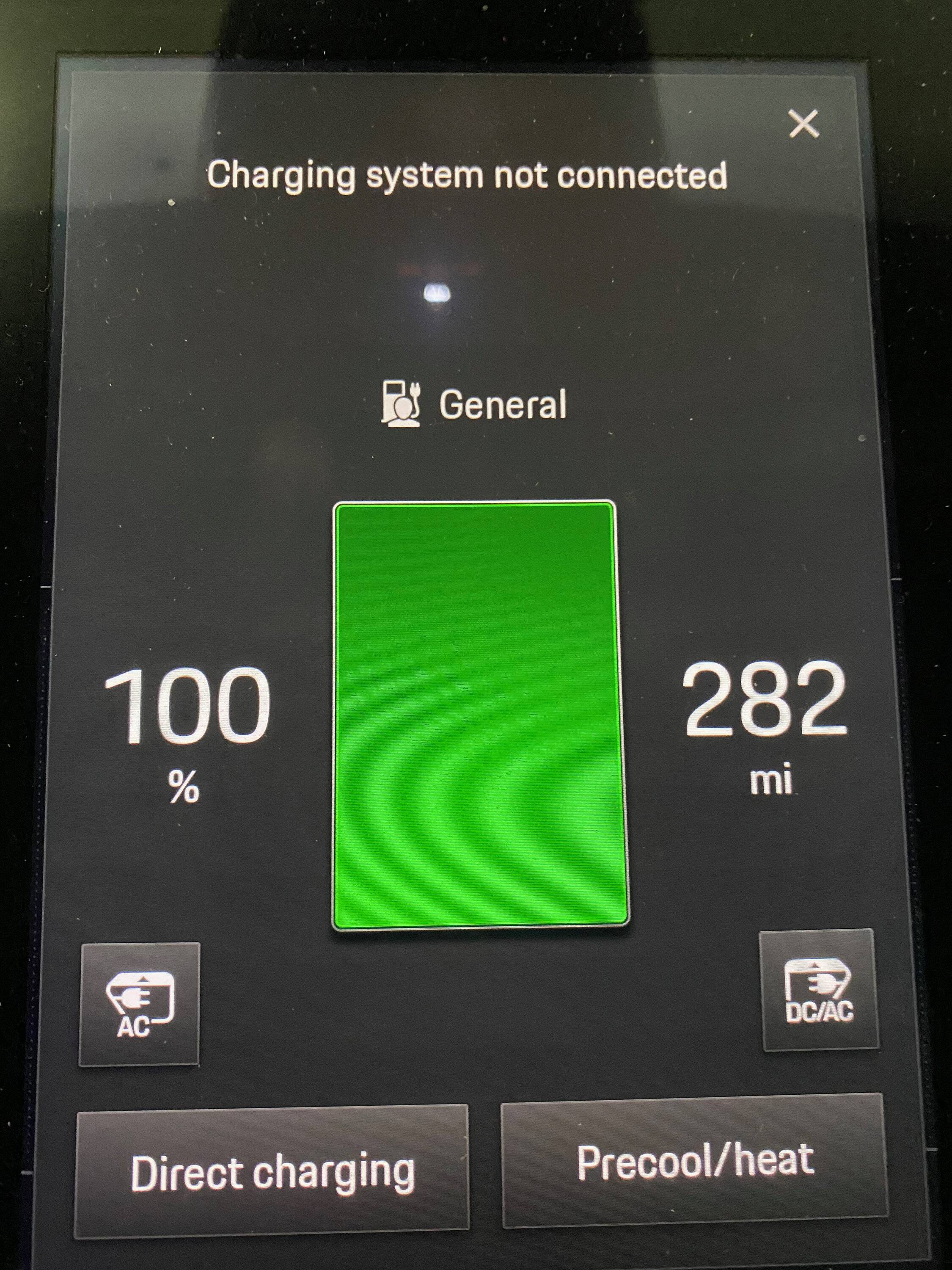

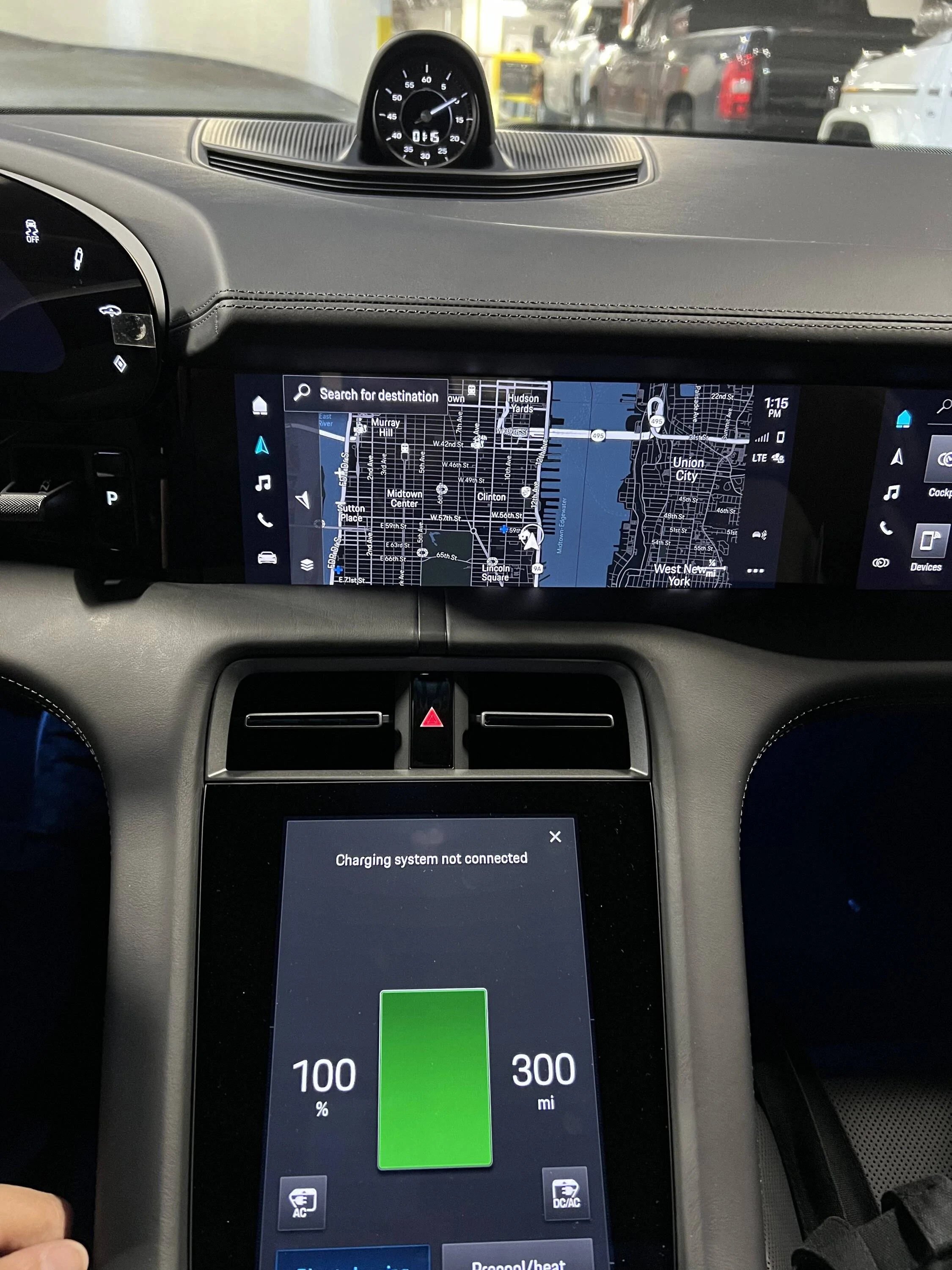

Latest full charge estimate max range, not shabby, can't complain ??
My latest full charge up showing a nice improvement of estimated max range.
Porsche Taycan 271 miles!  100% charged. What’s your range shown? PSX_20220726_064625
This is on a 2021 TCT 4S (PB+ included of course)

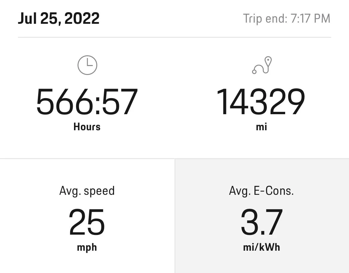

Had a long road trip this morning with my wife's 22 CT4, charged to 100%.
Porsche Taycan 271 miles!  100% charged. What’s your range shown? IMG_2707

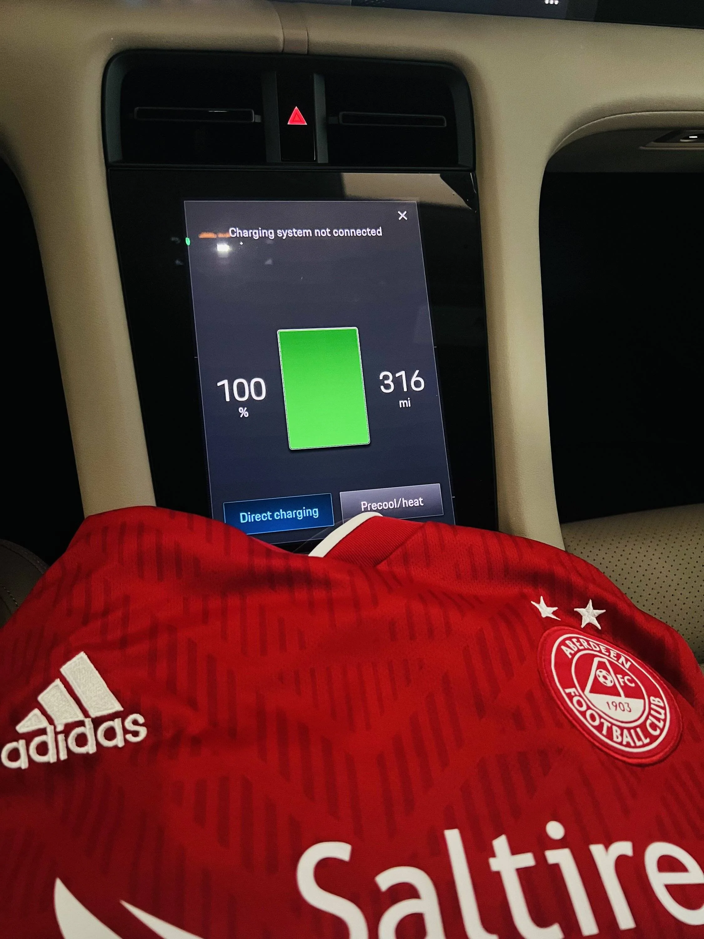

Wow I have a used 2021 4s I just picked up 2 days ago, the consumption tells me 31kws/100miles but the screen tells me 153 miles with 71% battery left… I hope it updates, I don’t have performance battery but with only using 31kws/100 miles that should be at least 250 miles

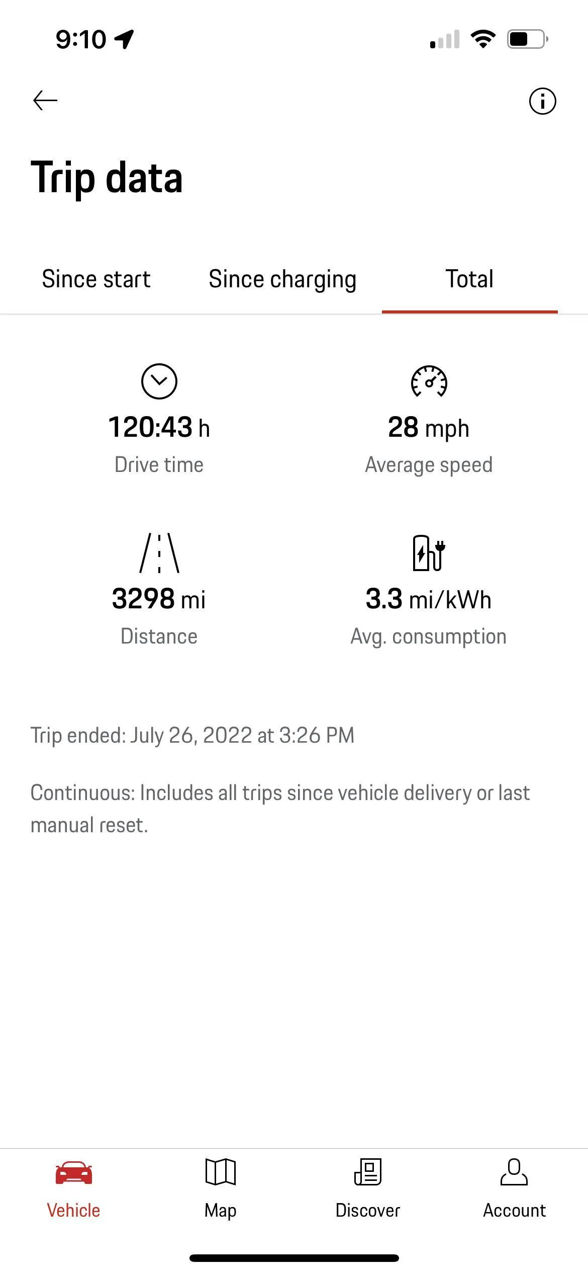

Porsche Taycan 271 miles!  100% charged. What’s your range shown? 0A2108F4-78A0-46E1-A99F-6EAC36204691
RWD with performance battery plus and mostly using range mode. I never charge past 85% but 3.3mi/kWH (multiply by 93.4 battery capacity) = 308 miles of range
Sorry but you don't have access to the full 93.4 kWh due to battery protection. Do the math on 83.7 kWh.
