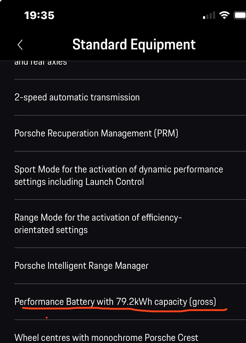

Ok so thanks to “PRJ” for checking my vin number which he said confirms. 93KWH batt. Although just blooming strange how the log book doesn’t state this when other folks logs book do state 93KWH.
I guess I need to put it to bed and leave it alone !

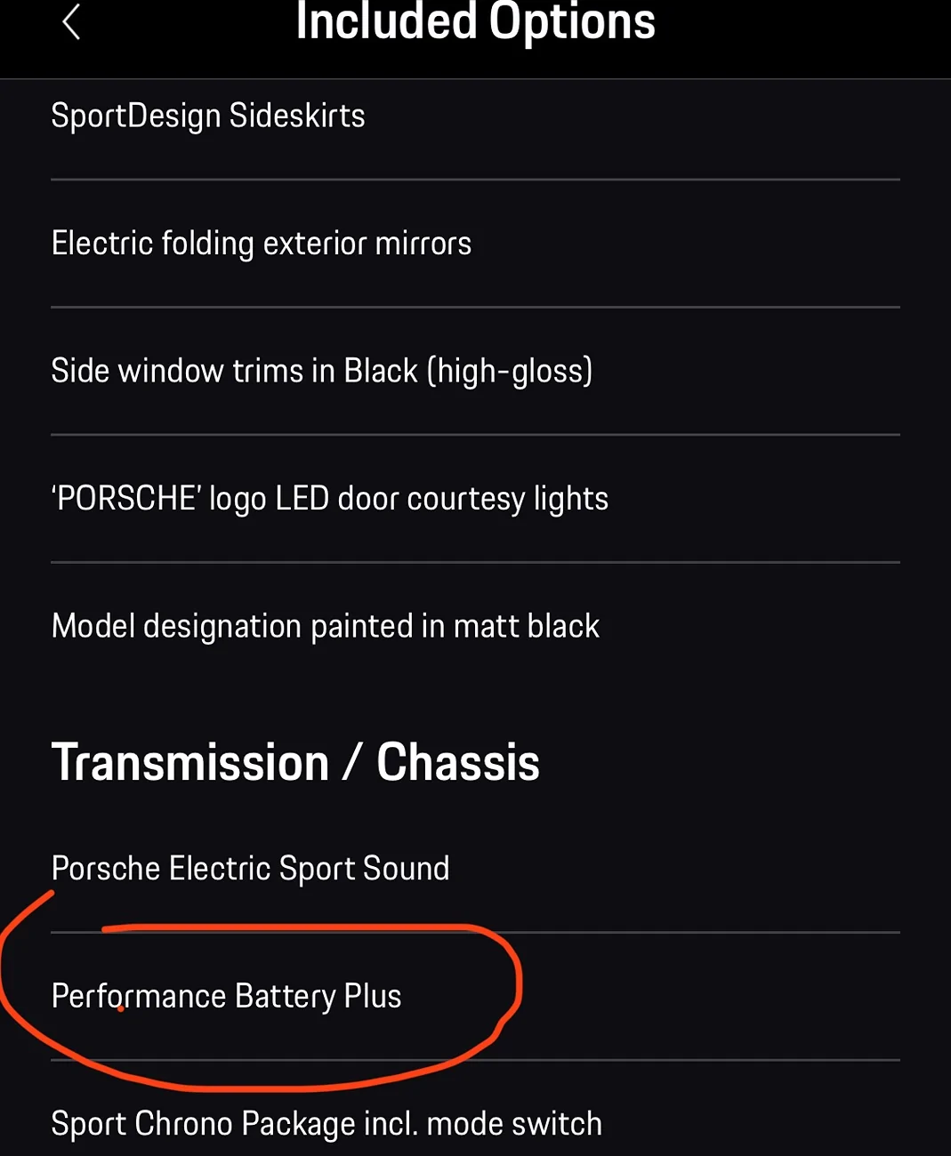

Ok so thanks for the advice to check the garage icon In the app, as it does state PBP see screenshot / but it also states 79KWH. Could do with some decent advice here - See screenshots-
Don't compare the standard spec to the actual spec as they will always be different particularly where standard options have been upgraded such as the battery.
220 mikes is close to the mark give or take and the PB would be lower still.
This appears to be an admin error when the car was first registered.
Ask the garage to check your battery status of health and if around 90% will explain the reduced range.

Check your My porsche app. go to my garage - more details - included options. if it has PBP it will say it there.

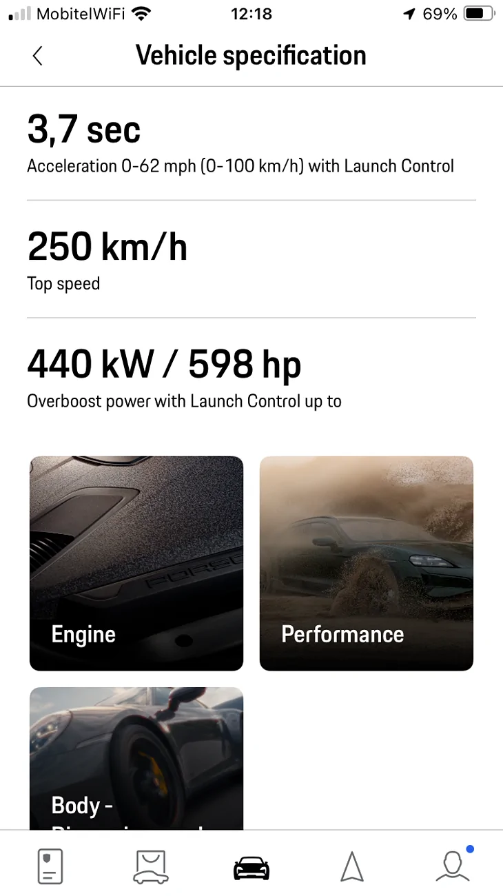

I have 4S, MY25, but i don’t see “included options” under “more details 🤷‍♂️
On 'More Details' scroll down and tap 'Technical Details' and there should be a tile labelled 'Included Options'.

Don’t have such option 🤷‍♂️

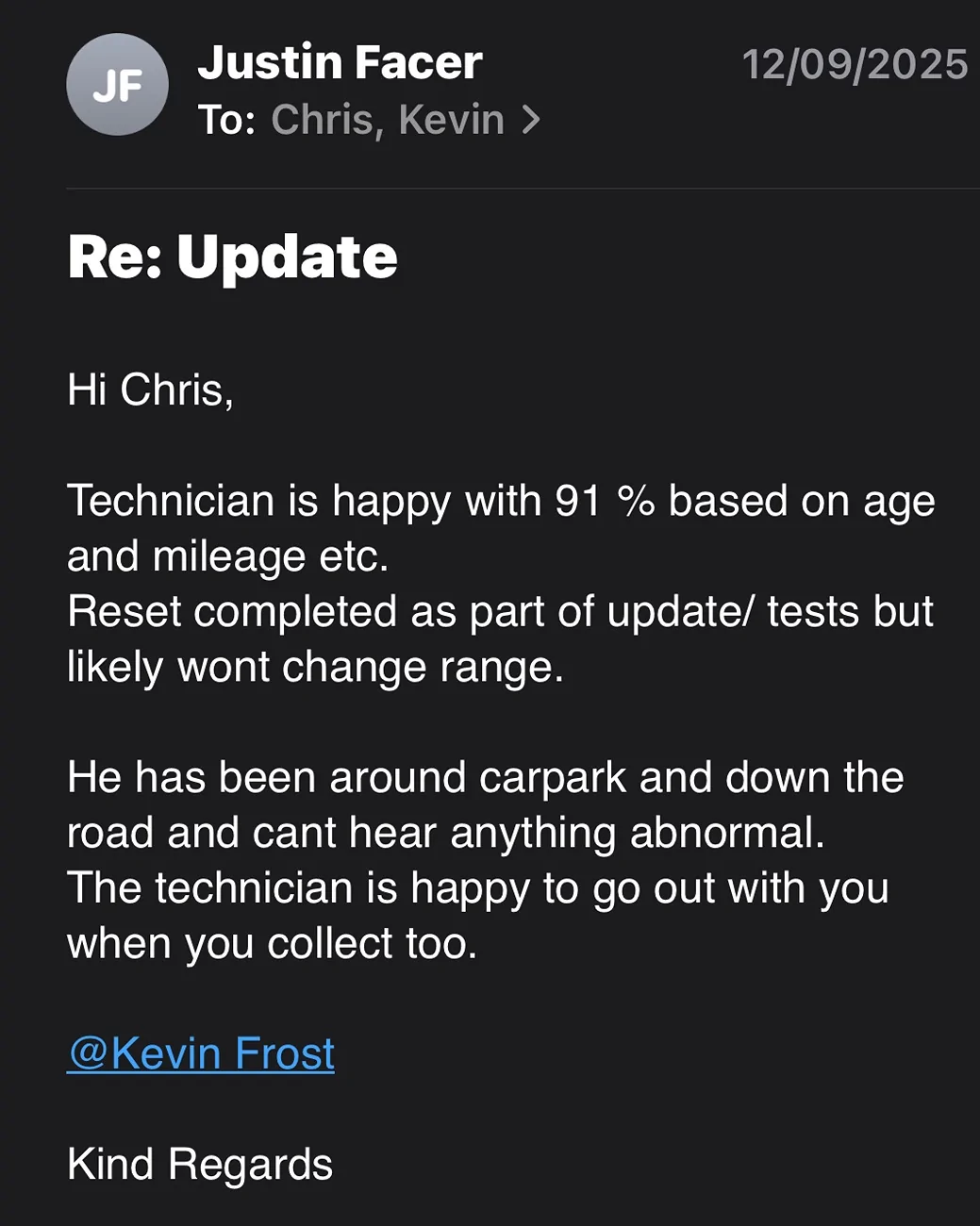

Yes you are correct with the battery status - Was completed a couple of months. Back and is at 91% - 3.5 years old. Back in the summer I never passed 235 miles range, on range mode also.
When sold to me they assured me it would reach 250. Even sent me a screenshot of the dash. never achieved that once throughout the hot summer also.
Feck it I’m inclined to assume all batteries are performing differently. I’m not going to mention my Tesla! Oops!
but I still love the Taycan.
