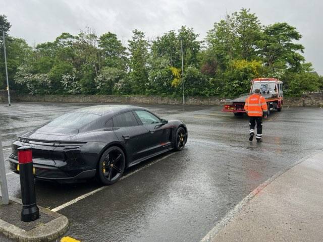

I jacked up the car and spun the wheels and the front brakes were binding slightly, I sent this to my OPC and they said to have it recovered to them:
Had it recovered this week and it's been diagnosed a failed ABS unit.

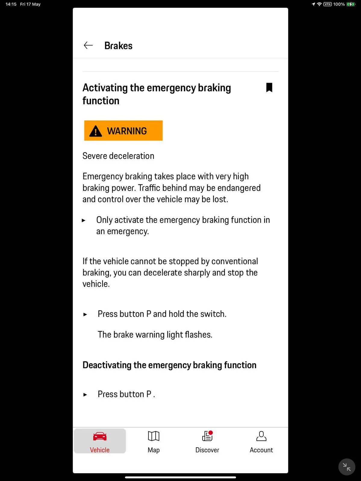

Can anyone point at any resources explaining what is the emergency break?
It is described in the manual in the MyPorsche app. Check the manual under Vehicle Details. There you should find manual. In the search function type in brakes and browse through that.

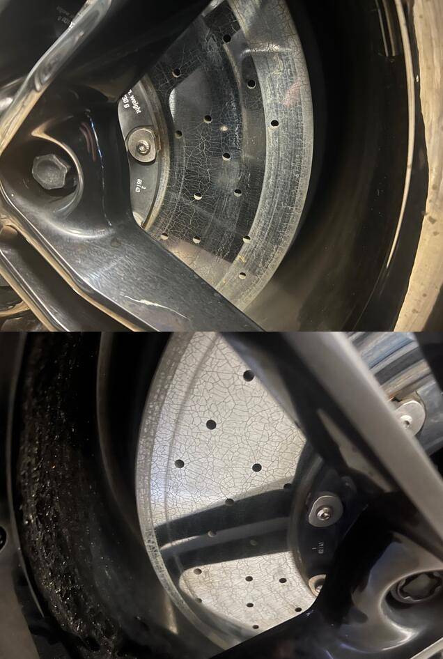

I looked back and it was March that I sent the images of my front disks, but I don't use the car that often. This is how they looked, but I think it's just part of the pads not touching the disk, and the lighter patches are just the "uncleaned" part of the disks I think, it soon polishes off by hand. I think this will be resolved when I get my car back with the new ABS pump.
@Tooney thanks for that TSB above - I did send that to my service advisor back when I sent these images in (in the same email as the images infact) but she confirmed that TSB doesn't apply to PCCB.

This isn't the best photo – and I'll take a closer look at mine later today. But i do not notice that wear/colour difference on mine. They are consistent across the diameter of the discs.
