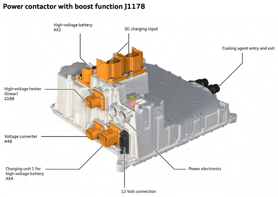

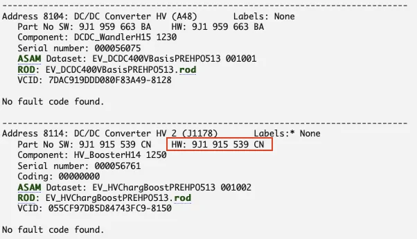

I’d be interested in the 150kw dc as a retrofit. Anyone heard of that?
At the Norwegian online breakers 'yard' and Saturday afternoon on the spanners wearing thick rubber gloves ?
Looks like the part (9J1 915 539) new is around £3K otherwise. Porsche dealer could no doubt fit a new one, it would probably be a couple of hours labour.
[option cost when new looks cheap. Sorry.]
