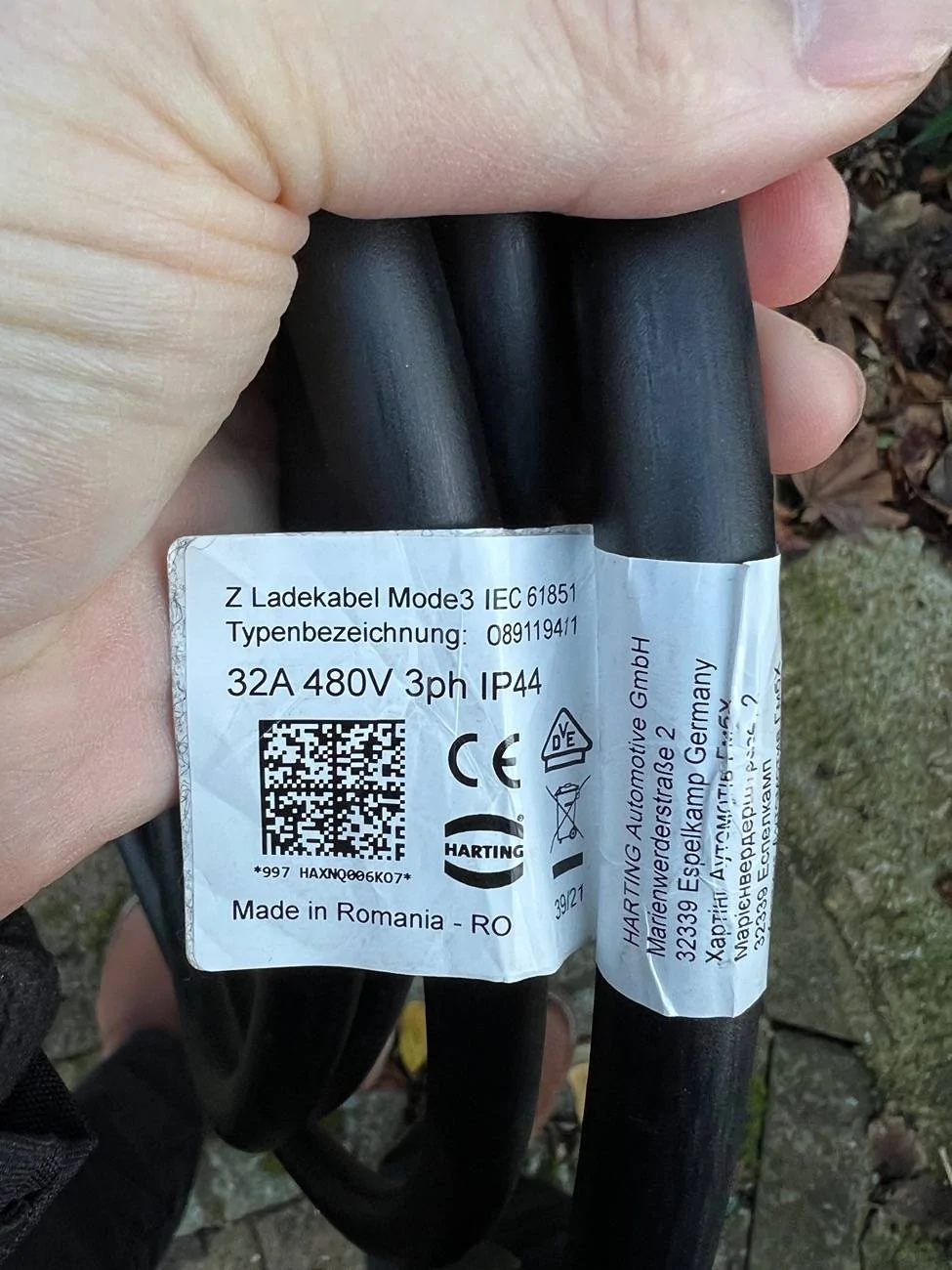

Interesting, is there any way to tell the 16A and 32A cables apart? eg colour etc? No idea what came with my 21 reg car, assuming from your post it sounds like a 16A was supplied to cars of that reg(black and short) although it was a late 71 car (Porsche described it as a 22MY) so really not sure! Right on the cusp.
I know I get 11kW on a 22kW three phase at work but had assumed that was due to someone not speccing the 22kW charger (although I don' know whether it was specced or not, is there any way to check that? eg options list sticker somewhere? Is there a code for 22kWAC?).
Perhaps I'll borrow the Mennekes from the Tesla and try that at work to see if it makes a difference.....
Incidentally, does the new J1.2 still have a 22kW option? Couldn't see it on the configurator.
There is colour coding (16A RED Commando, 32A BLUE Commando) however some manufacturers have ignored that and use the same colour for either rating or indeed go black which is not at all helpful.
The cable / connector should be marked however with relevant ratings.
In the early days when dealerships knew feck all about feck all pertaining to the Taycan it was possible to option either a 32A or 16A EVSE to car cable and if you didn't do your research you (as many did) may have purchased the wrong cable (16A) and then wondered (as did the inept dealership) why your car was charging even slower than you'd expected.
MY21 would have fallen into that category as the cable was an 'extra' (yes, indeed!).
From MY22 onwards an L2 Mode 3 32A cable and connector which shipped as standard thereby removing the decision and / or confusion.
So check the cable / cable socket to see if you can see any markings and that will be a clue.
Some unscrupulous dealerships even 'lost' or 'swapped' cables (and EVSEs) between cars.
What EVSE (charger - don't get me started on that as these are not chargers as the charger is physically in the car both AC and DC) do you have / referring to - the one you have with the car or the workplace?
Three phases are needed for either 11kW or 22kW so it depends on how the workplace unit is plumbed in and what rating the EVSE itself is. Hopefully it's all rated to 22kW but if an Accountant was involved there may have been some penny pinching.
3.7kW - 1 phase supply - 16A (0.15 mi/minute charge)
7.4kW - 1 phase supply - 32A (0.3 mi/minute charge)
11kW - 3 phase supply - 16A (0.6 mi/minute charge)
22kW - 3 phase supply - 32A (0.9 mi/minute charge)
From the fuse box to the wall socket to the EVSE to the cable to the car to the commando socket at either end they must all be rated to 32A - any reduction will make the entire end-to-end piece the same so if 16A cabling is in place then you will only get 16A, if the socket is 16A then the same again and so on.

My old Tesla gets 19kW from it at work so definitely full fat 22kW.
Hehe yes I'd long ago given up on EVSE but you're quite correct. Well winged!! ?
will go look carefully at the cable that came with the car later.

Definitely the car then. Not the cable.
Ho hum poor speccing by someone.
Porsche Taycan AC charging IMG_2880
11,113
6,881
So you should get 10.4 - 10.6kW from your workplace EVSE then if it is 22kW which you've just confirmed that it is.
Standard Taycan onboard AC charger is 11kW but for a ridiculous £1,200 you could have got an unreliable 22kW option. Not many takers and to be honest is a waste of money given DC is preferred and 7.4kW for overnight charging (or anytime charging) is more than suitable for most.
The 22kW AC onboard charger may have been withdrawn by now - @tigerbalm consumed at least 4 of these puppies such was the reliability.
Yes it looks that way. Shame the 22 was poor - use it a lot here (work) and pretty much all on street charging in Germany (family) is 22.
yep gives 10.5 here at work.
