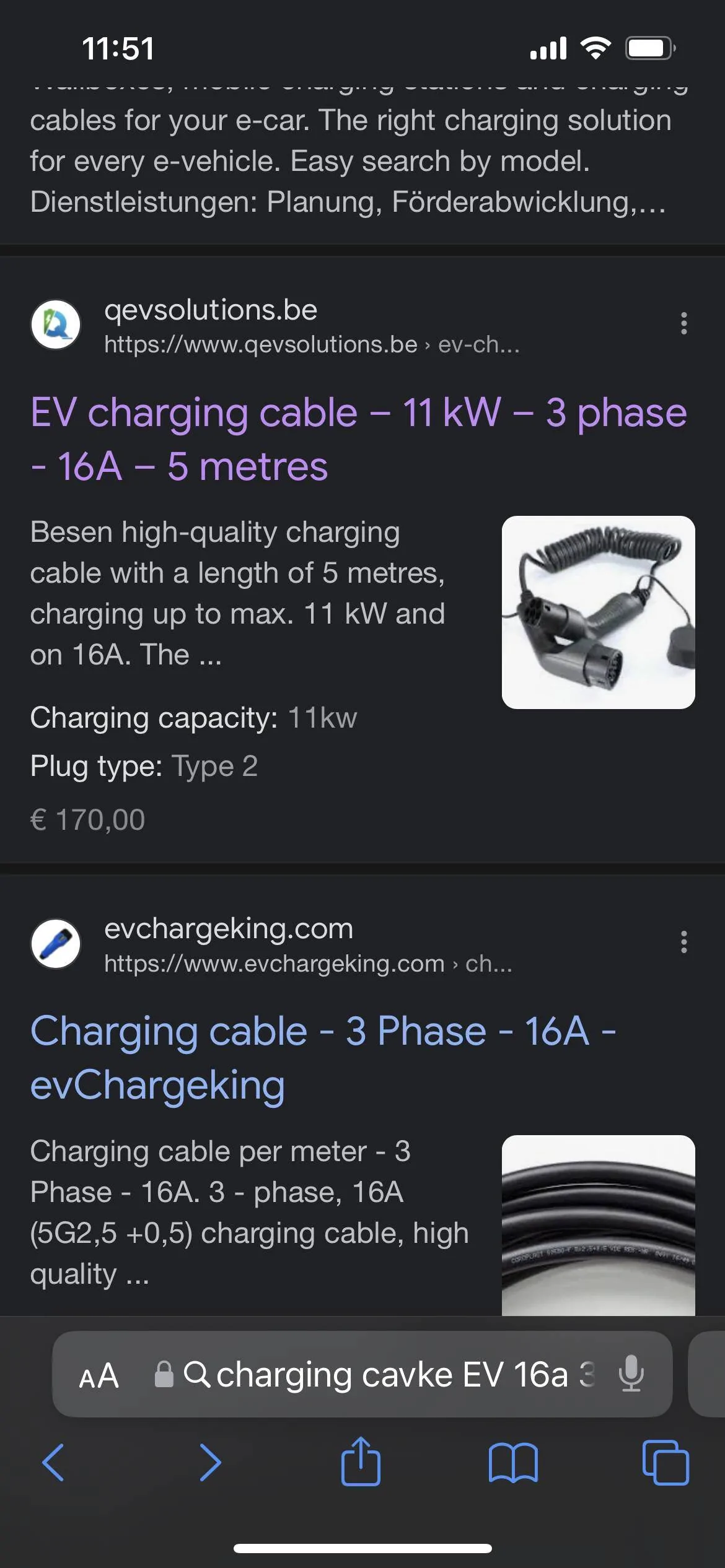

I was ready for that one, waiting for it to come ?

In Europe where we have a lot of three phase installations, there are two types of cable.
Three phase cable with 16 amps
Three phase cable with 32 amps.
So the cable could very well be at play here.
https://eshop.sectron.eu/en/charging-cable-type-2-type-2-mennekes-3x16a-400v-10m/p-15371/
