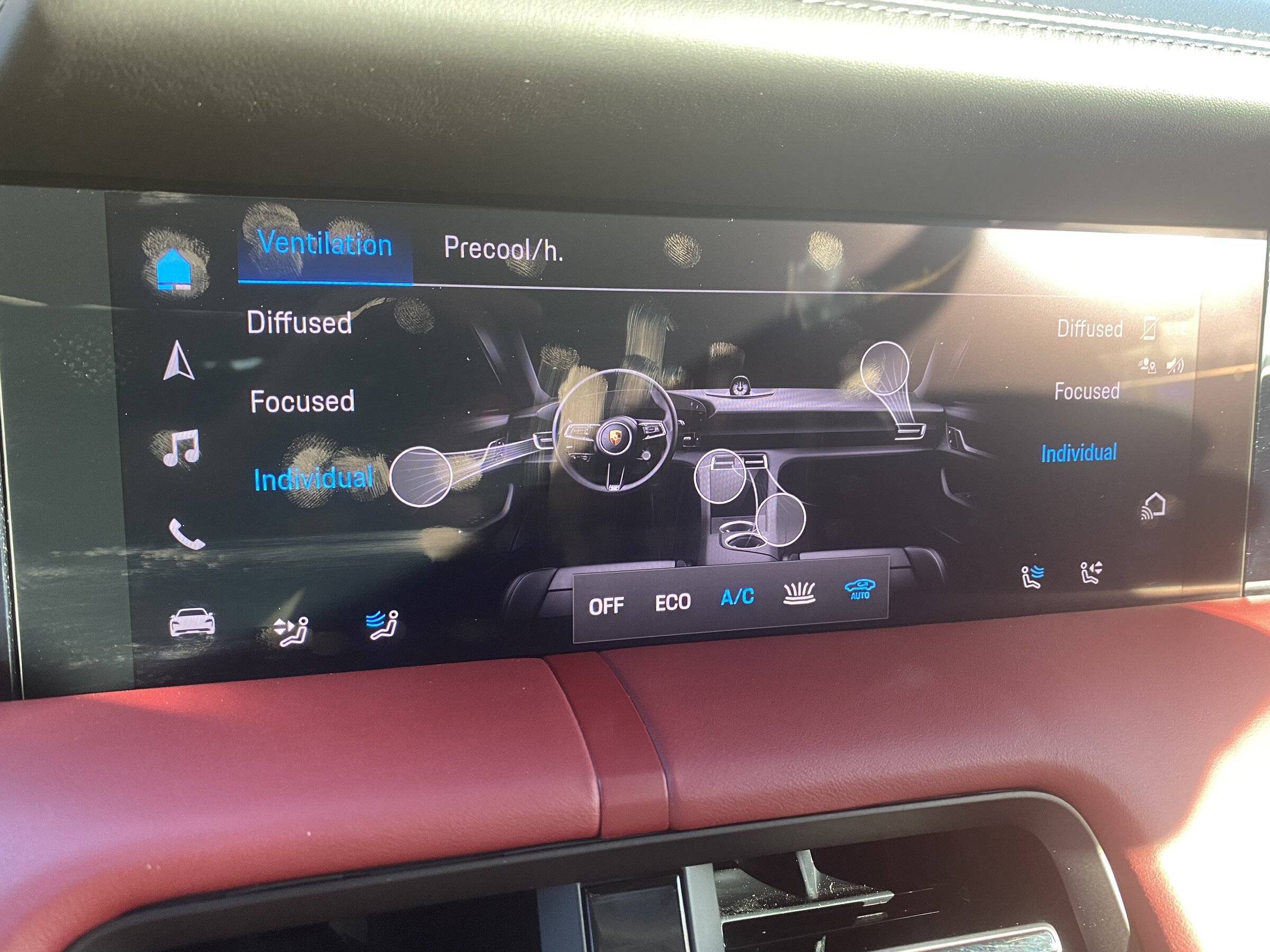

? … that’s what I posted …?
Yep but you mentioned it was cryptic to find but it isn't that's all.
Also the Auto mode is not a requirement to locate either. Individual, Focussed and Diffused are all Auto AC ventilation modes. If none of these are active then the footwell control isn't available.

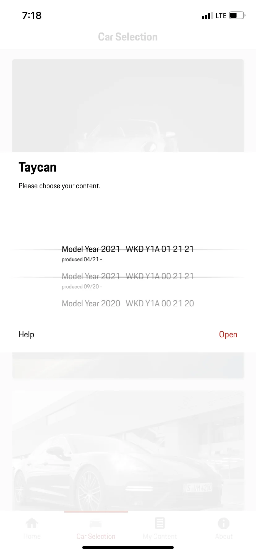

There is nothing particularly new in MY22 cars which isn't covered in the current PGTK app - remote parking is the only thing I don't see.
Be that as it may, they have two sets of docs for 2021 models but nothing for 2022 yet. I doubt there is a very big difference between those two 2021 versions either.
Porsche Taycan Adjusting footwell temperature? BAE17F2A-94A5-457E-AA0B-5F885FD2565C
11,085
6,859
Yes, aware of that but the 04/21 revision is still current nor can you assume a new revision is made for every model year.
My guess is that there will be an update around April this year given the release of Sport Turismo and GTS models which start shipping by then.

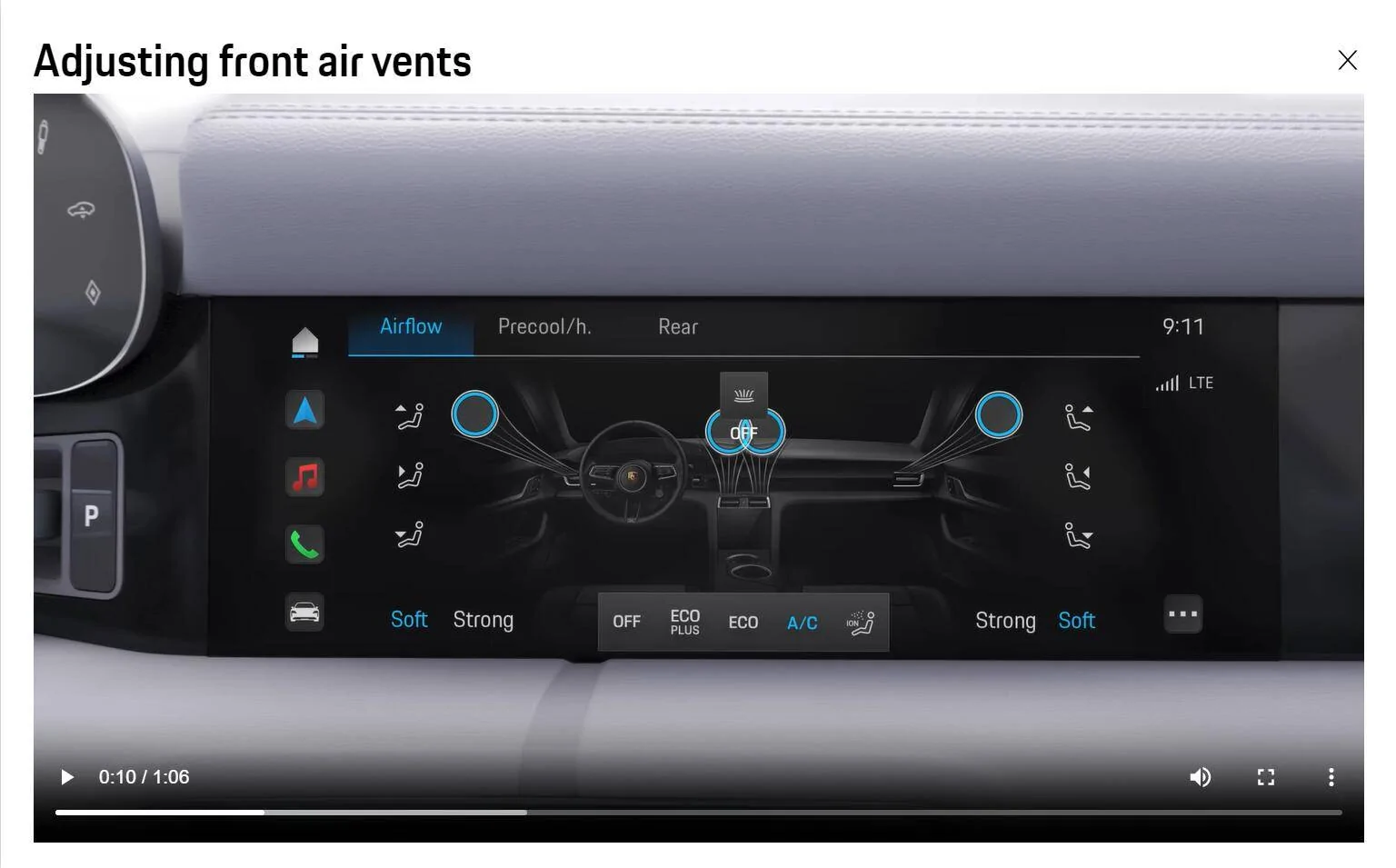

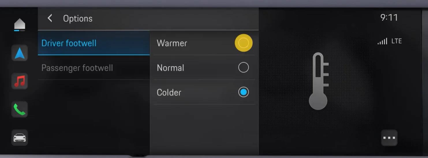

I thought Footwell temp control with 4-zone only was common knowledge and well documented on this forum. I chose it because of it as we have it on the Cayenne and it makes a big difference, to us. I have a 2023 and my Climate Menu does not look the same as @ciaranob. I have Soft and Strong and then Footwell temp is hidden in 3 dots at bottom right on that screen with 3 options: Cooler, Normal, Warmer.
This is what I have exactly as in these pictures from the online manual for 2023 model year.
Porsche Taycan Adjusting footwell temperature? 1700877888910
Porsche Taycan Adjusting footwell temperature? 1700878262700
