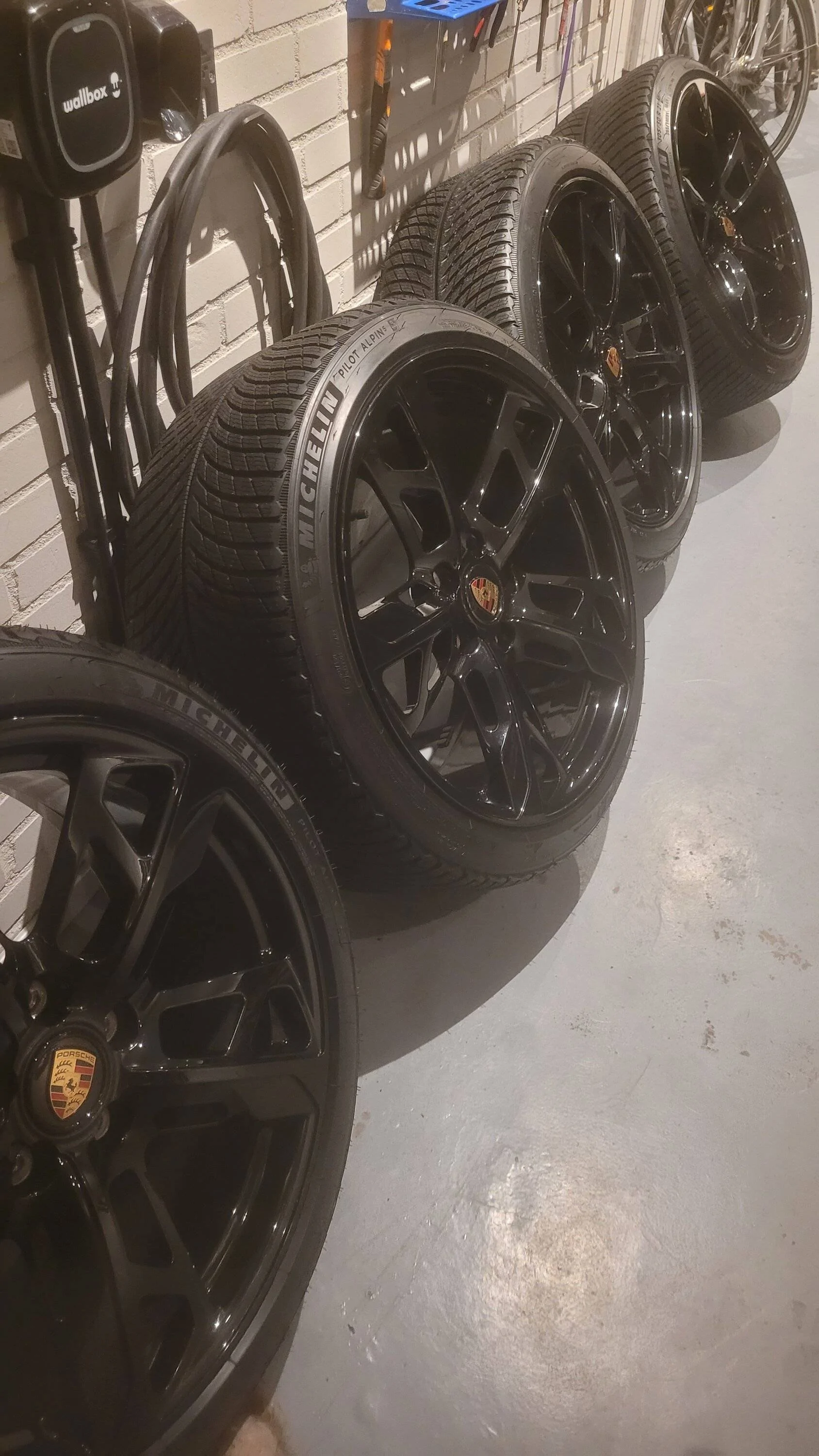

Any warranty issues there when these non-NF0 are mounted? I wonder if anyone had any issue with Porsche when they mounted NON NF0 tires....
How bad can the Michelin PA5 be as compared to their rated NF0....I even match their width spec....305 rear and 265 front, only diff is 21 inch instead of 20 inch as recommended by Porsche.
On another note, which tires do you select in PCM when using 21 inch winter, since this is not an option in PCM?.....21 inch all weather/season?
Cheers
Since dealers themselves hand over Taycans that are on non-NF0 winter tyres, I would not expect them to have a very strong case regards any warranty claims... Even in domestic official marketing material from Porsche, I have seen they use Taycans fitted with nordic winter tyres ie non-NF0.

The UK insurance system is definitely different from here in the Netherlands. I do not see any exclusion in my policy on tires/rims.
In any case I have mounted brand new Michelin Pilot Alpin 5 on the 21 inch cross turismo OEM rims, I really think this will be fine also warranty wise, OEM wheel, with tire width that matches summer specs....
Time will tell.
