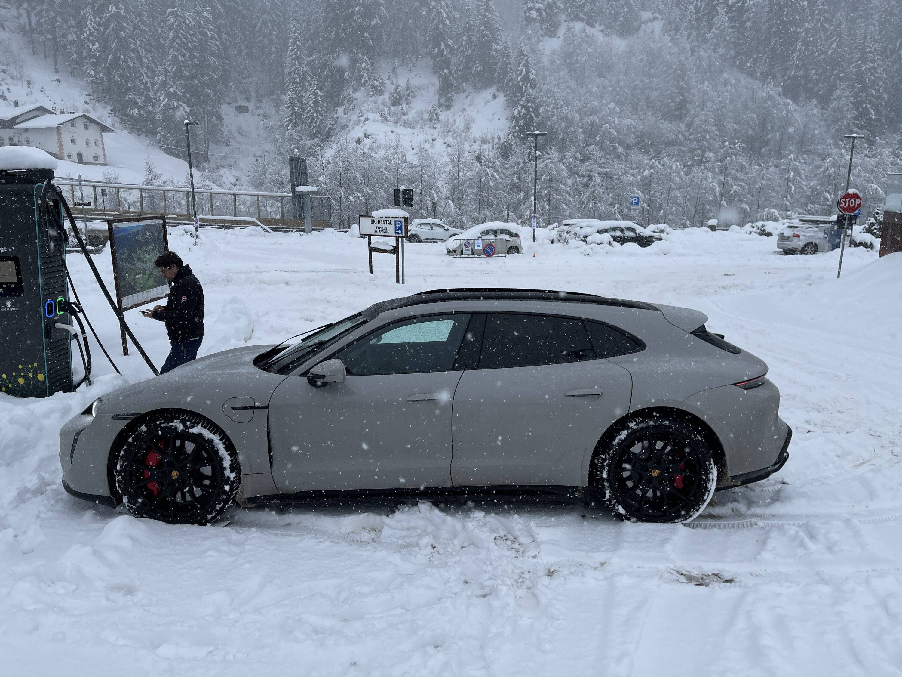

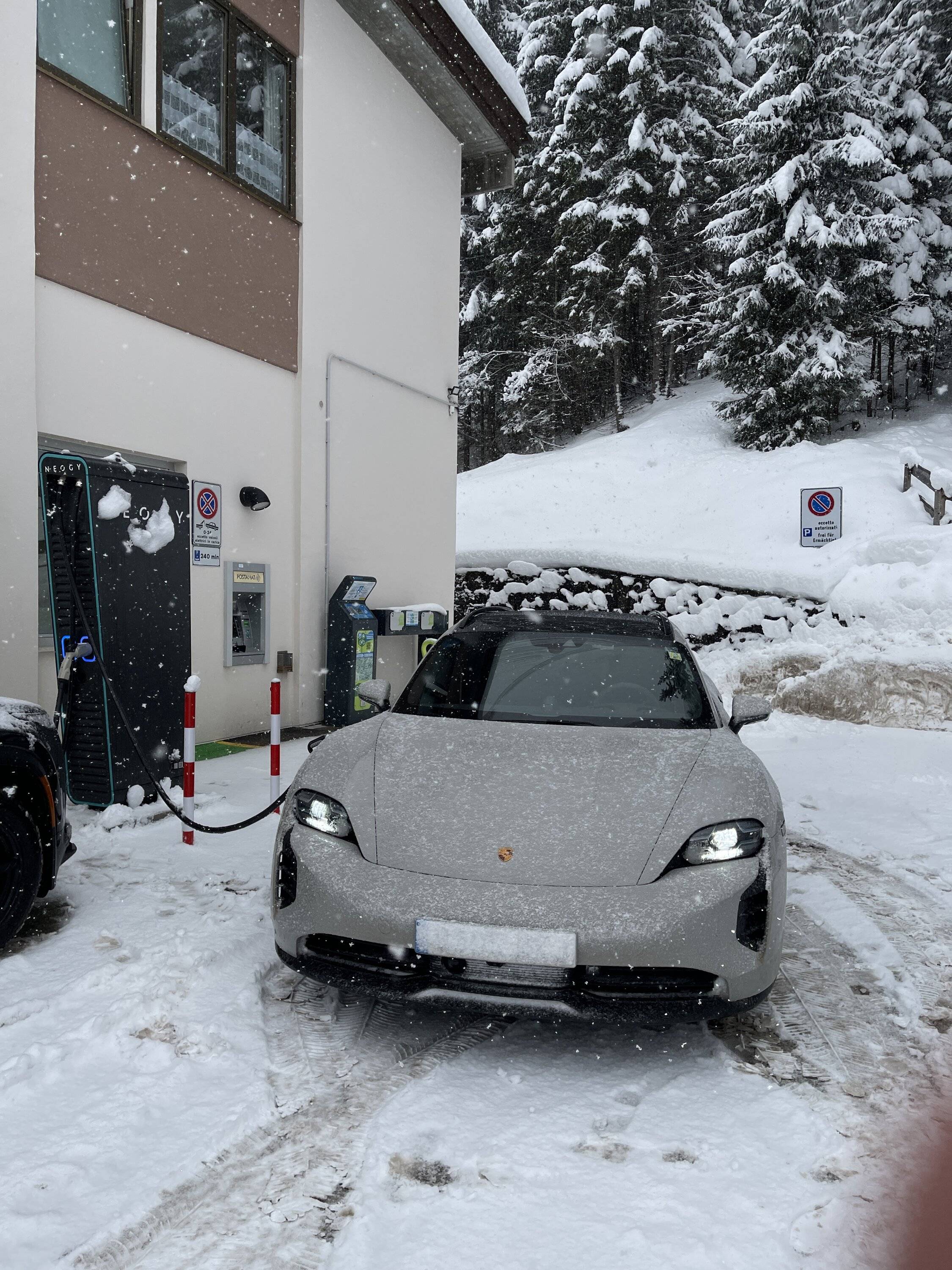

I’m 2 legs into this winter transeurooean trip. Currently in dolomites and pissing down with snow. Went out in the Taycan on the Alpin tyres. Fantastic. Couple of brake checks from ~40kmh almost zero abs felt. Can wheel spin if mashing the throttle but otherwise fantastic. Several muppets with non-winter tyres and no snow chains spinning all over the inclines road. The Taycan on these tyres is a dream. Charged the car in a snowy parking lot about 5 or 6” of snow - nose in reverse out no trouble.
you’re not gonna be rallying and ripping up the road but they will get you around when others can’t move.
undoubtedly a pricey option but so happy I fitted them.
