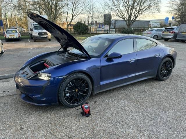

Been so mild and I’ve been lazy, so only got around to putting on the black 20” Turbo Aeros with Pzero Winters on yesterday.
Car is filthy. Don’t judge! ?
Porsche Taycan All Season Tyres. Help please. Winter tyre swap on Taycan 21.08.46

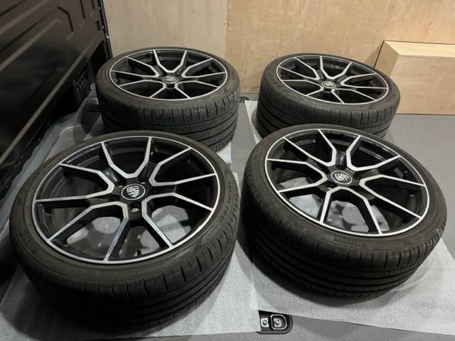

Immediate the difference in ride between the 21” spyders with Pzero summer and 20” TA’s with Pzero winter. That extra sidewall height will come in handy for pot-crater gate ?
Porsche Taycan All Season Tyres. Help please. Spyder wheels
