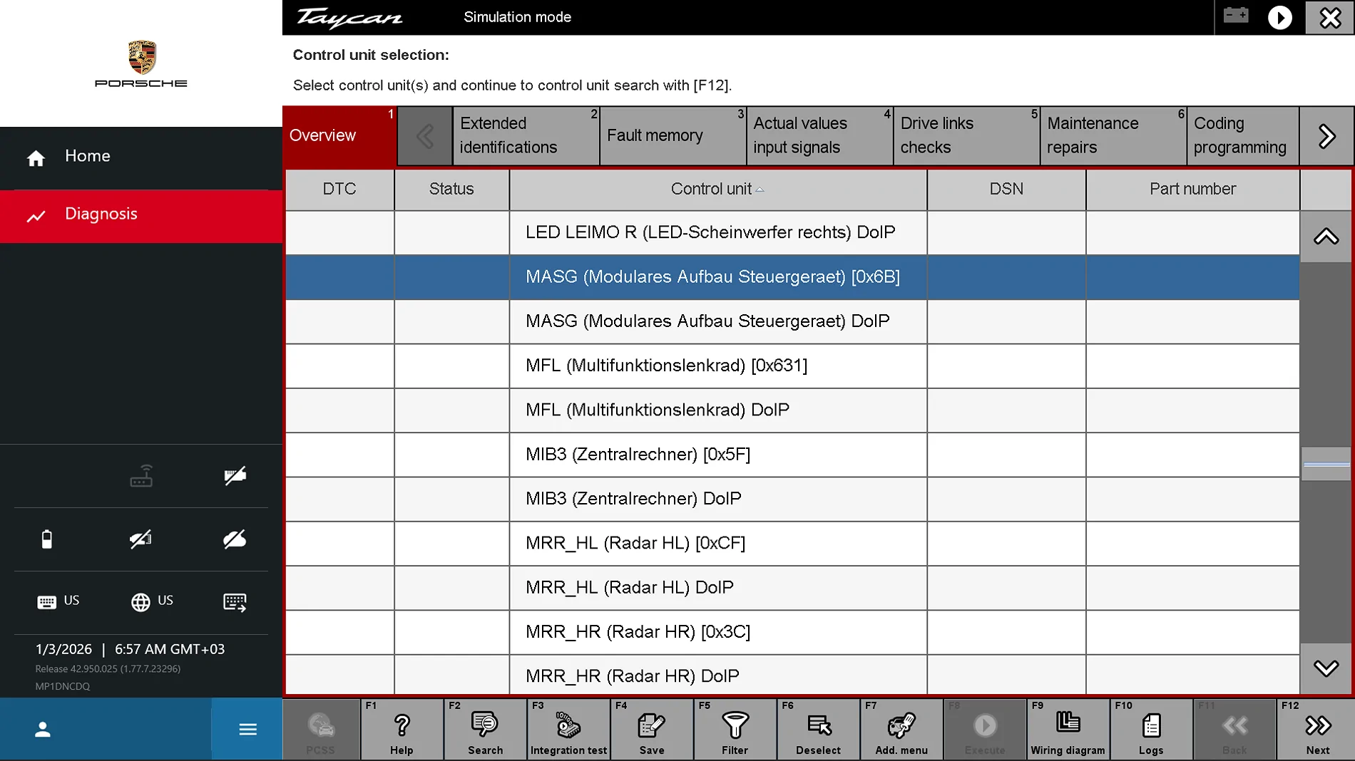

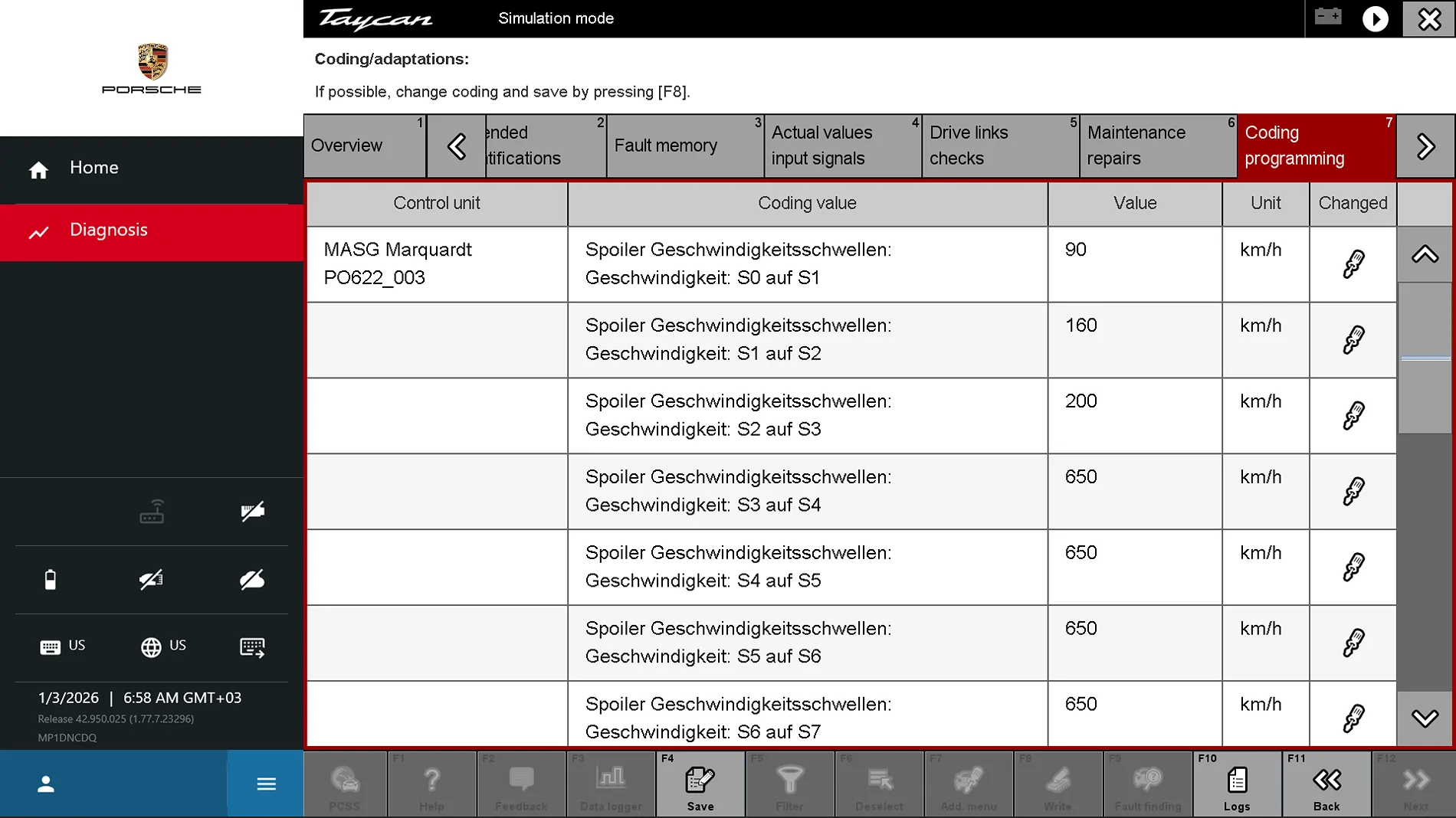

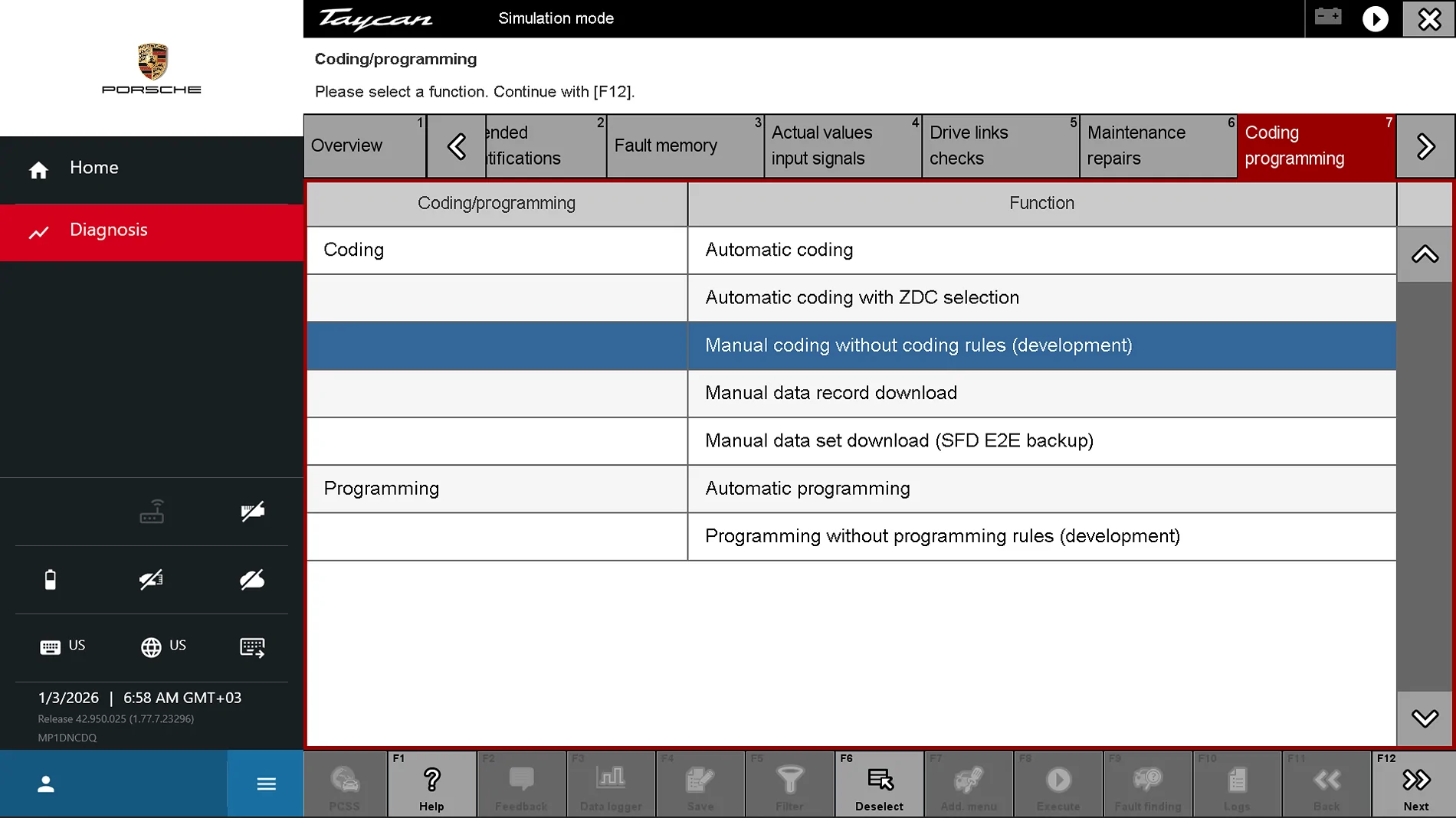

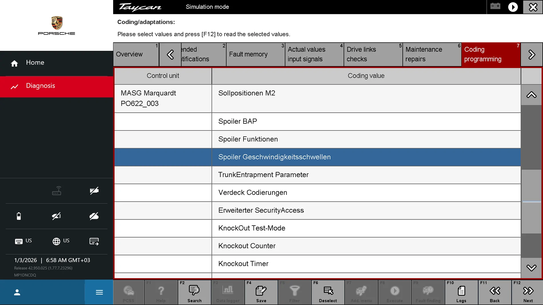

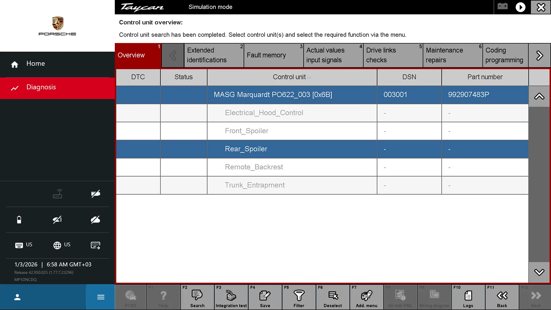

tsaijoe0932
Joe
Jan 2, 2026
Taiwan
Just picked up a PIWIS. Didn't see these in the thread, if anyone knows where to find them.
If not maybe I'll do some digging this weekend.
1. side markers (front wheel arches) off by default, and only blink when signals are on.
2. never engage rear wing (I want it down always).
In MASG Spoiler Geschwindigkeitsschwellen:
Try to set the parameters of s0~s4 higher to match your requirement.
Porsche Taycan Anyone with PIWIS? Screenshot 2026-01-03 065829
Porsche Taycan Anyone with PIWIS? Screenshot 2026-01-03 065850
Porsche Taycan Anyone with PIWIS? Screenshot 2026-01-03 065903
Porsche Taycan Anyone with PIWIS? Screenshot 2026-01-03 065920
Porsche Taycan Anyone with PIWIS? Screenshot 2026-01-03 065935
