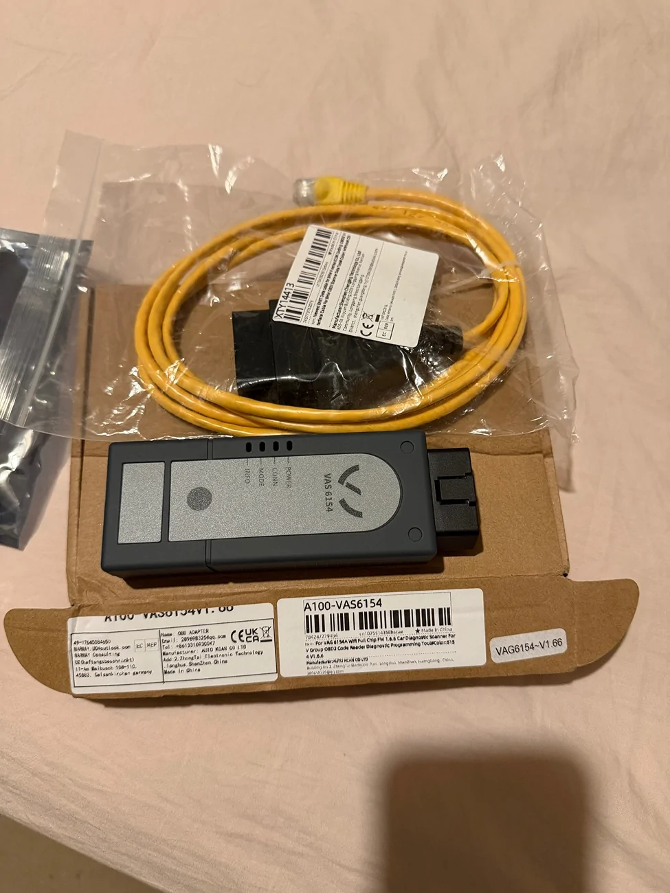

Be careful with the piwis micro-usb connection, mine separated from the main-board fairly quick.
Don't use that thing in WIFI mode, if it loses connection while it's writing data to your car, you're screwed.
If I were to buy one again, I'd tape the usb cable to the piwis so it can't put strain on the connection.
I learned it's a common "fault", poor/cheap design error.
Noted, thanks. What did you code on your Taycan?

I managed to code rear DRL and 3D surround view - I’ll be reverting the 3D view as you lose the wheel view.
When I was trying to code, I got some errors about Piwis cannot go online but going back loaded the the control module parameters.
