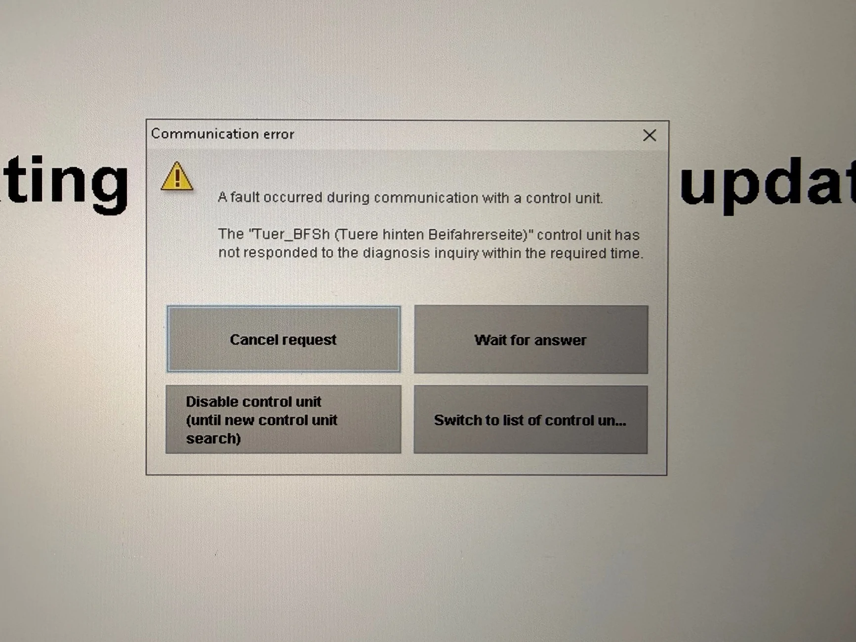

When I try to scan for faults or get into coding, I get this communication error pop up:
Anyone know what I should do?
Ha, I remember from when I used PIWIS on my car I also got this exact error for the rear passenger door. (Has been about a year since I last used it)
I think you can do the "disable control unit" to make it continue/disregard that module

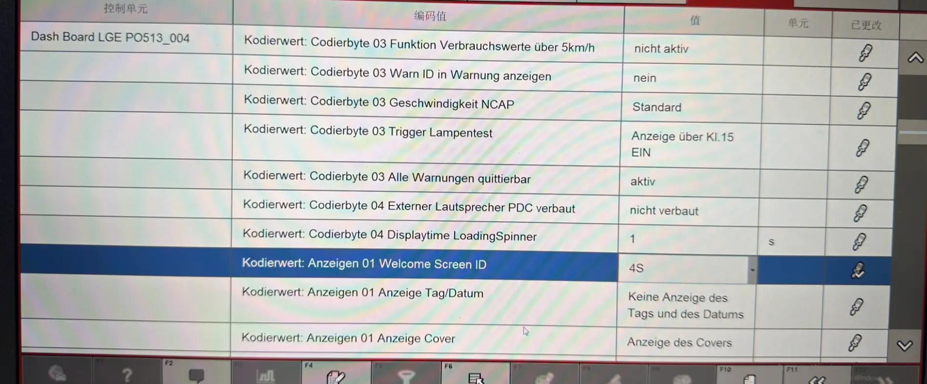

Because my car has matrix headlights, I tried modifying the activation threshold (from 100 km/h down to 80 km/h), but I wasn’t able to write the change. Are there any other ways to increase how often the matrix headlights activate? It’s really difficult to actually see them turn on.
Porsche Taycan Anyone with PIWIS?  2026-03-04 22.52.35
Another finding is the dashboard welcome logo. I tried modifying it, but found that after each power cycle and restart, only the vehicle model (shape) changes, while the designation, such as Taycan GTS, does not change.
Is that in ZFAS? I don't see those bitfields in my version of PIWIS.
Re: Activation thresholds. Have you tried adjusting these? https://www.taycanforum.com/forum/threads/anyone-with-piwis.20946/page-8#post-514427
I have mine set to 4 activate/8 deactivate and do notice matrix high beam activating when it's not completely dark, given there isn't sufficient light from other cars and/or street lights.

they only come on when the road is pitch black with no street lights.
true... But in Taipei, it’s almost impossible to find dark roads… I’ve driven a Lexus before, and its matrix headlight logic activates easily without affecting oncoming drivers.
