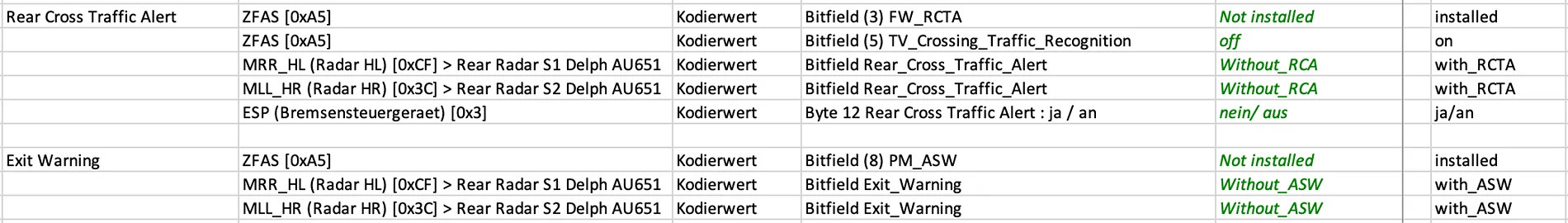

These are from my notes... The green values are the default values, the next column shows what the values need to be.
Porsche Taycan Anyone with PIWIS? 1773325223947-fq
This worked fro me...

@Porsche-Guru : This (RCTA & exit warning / egress warner) worked for me as well. Thanks for that...! But in this case it is not what I am looking for.
