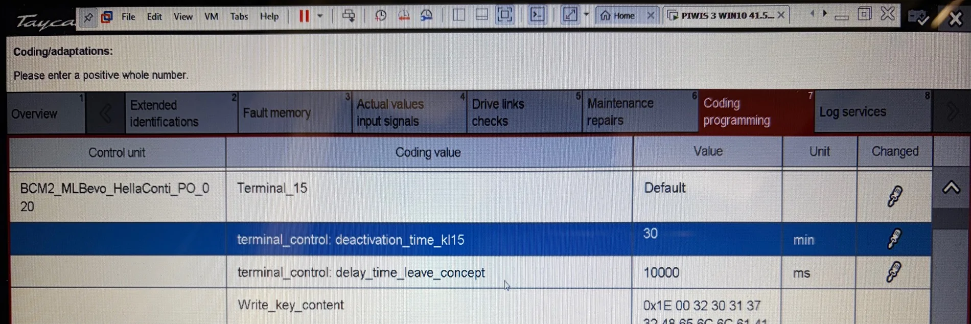

Here’s one I had thought of posting:
Porsche Taycan Anyone with PIWIS? IMG_1434
BCM2: terminal_control: deactivation_time_kl15
KL15 refers to accessory powered state (with engine/motor not running)
The default is 30 minutes after which the car will always power down all accessories, screens, HVAC, etc. In other EVs like Tesla, interacting with controls like volume will extend this time; unfortunately with Porsche it would always turn off at the set time.
I’ve set mine to 90 minutes for being able to enjoy music and AC while detailing the car’s interior.
