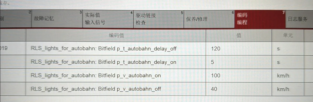

Because my car has matrix headlights, I tried modifying the activation threshold (from 100 km/h down to 80 km/h), but I wasn’t able to write the change. Are there any other ways to increase how often the matrix headlights activate? It’s really difficult to actually see them turn on.
You weren't able to write the changes because the range for p_v_autobahn is 100-200something kmh.
For those of us not lucky enough to have competent drivers with no speed limit motorways, it might be beneficial to lower p_v_autobahn_on (changes throw and angle of beam). For me the default was set to 140kmh an on delay of 10s. Yikes. 90+mph for 10 seconds? It's not often circumstances allow me to do that....
This could very well explain why it seemed like my headlights weren't bright far enough in front while on the freeway. This could also probably be a reason why I thought my headlights weren't aimed high enough.

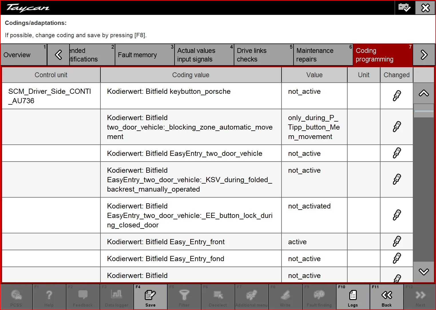

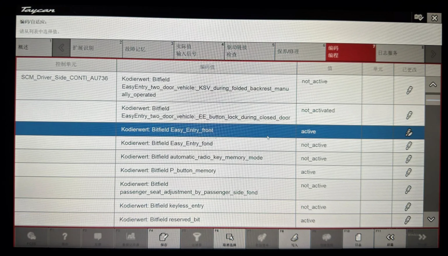

I didn’t think you could turn on FoD via PiWiS but great if it works.
My car comes standard with an 8-way power seat. Since it doesn’t have the seat comfort entry feature (which automatically moves the seat back when getting out), I enabled this function manually.

Yes. At that time, the supply of parts was affected by the war; otherwise, the electric steering column should normally have been standard equipment.
However, regardless of that, even the most basic 8-way power seats can have the comfort entry/exit function enabled through PIWIS.
When getting in, the seat automatically moves forward to the memorized position; when getting out, it automatically moves backward (but not all the way back).
This function does not need to be selected or activated through the screen. Once the settings are completed in PIWIS, it should take effect automatically. There will be no on-screen option to turn the feature on or off.

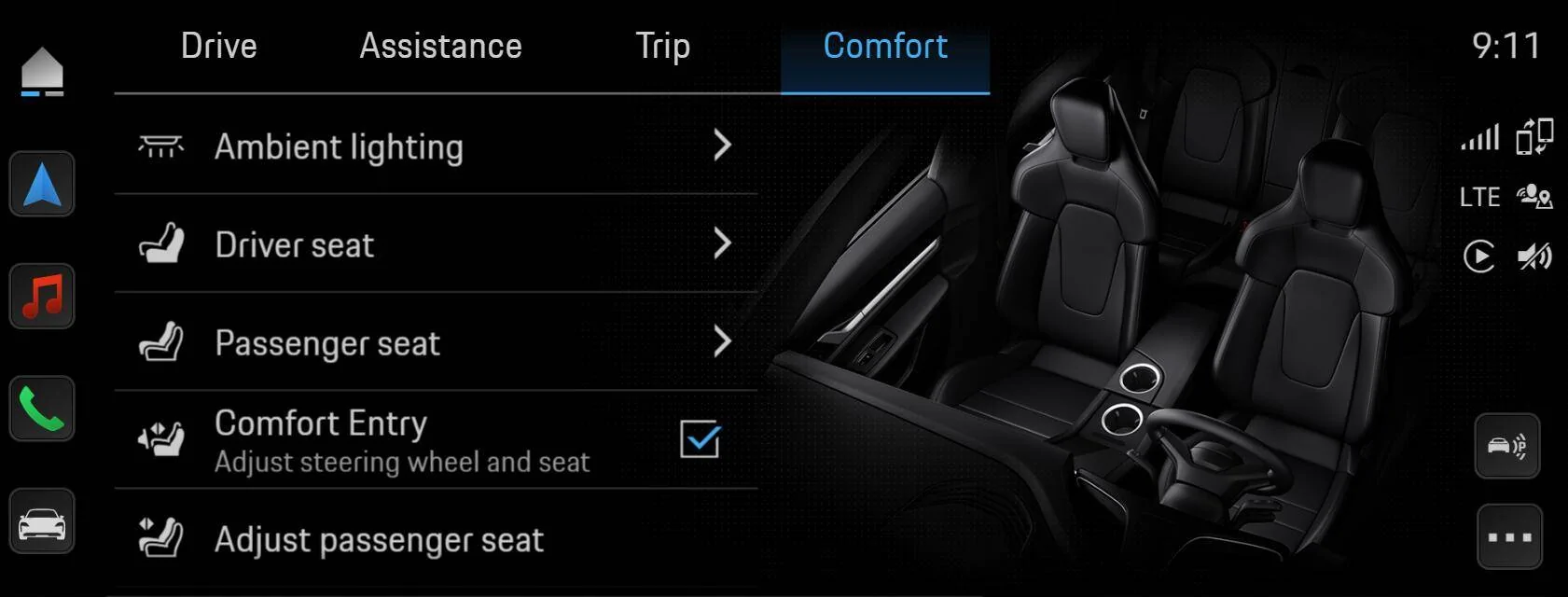

On my car (until the recent software update), the Comfort Entry/Exit option was displayed. Something like the attached (although that is not my car, just a picture from the internet).
Porsche Taycan Anyone with PIWIS? 1681734943941
After the update, the comfort entry/exit PCM menu item is missing and the functionality no longer works.
I have checked the entry using PIWIS, and it states that the particular entry is already active.

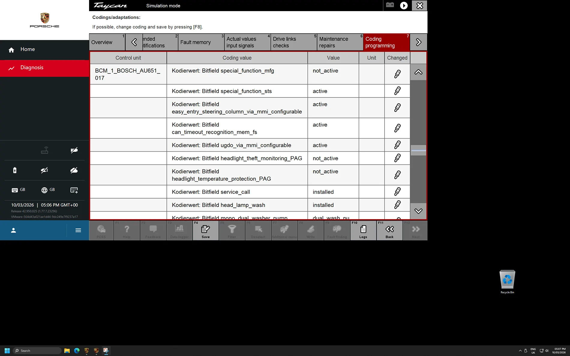

I then found another entry in BCM called 'easy_entry_steering_column_via_mmi_configurable'
Porsche Taycan Anyone with PIWIS? BCM-Easy Entry
This was set to inactive. I changed this to active; and voila.... Easy Entrty/Exit is now working...
I have no idea if it wa this change or something else that triggered the Comfort Entry.Exit to start working; but it has started to function. 👍
