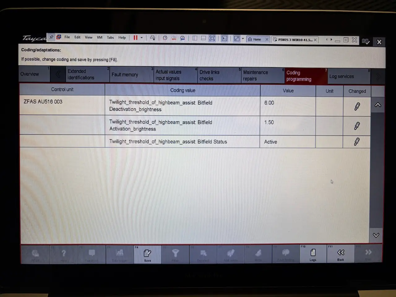

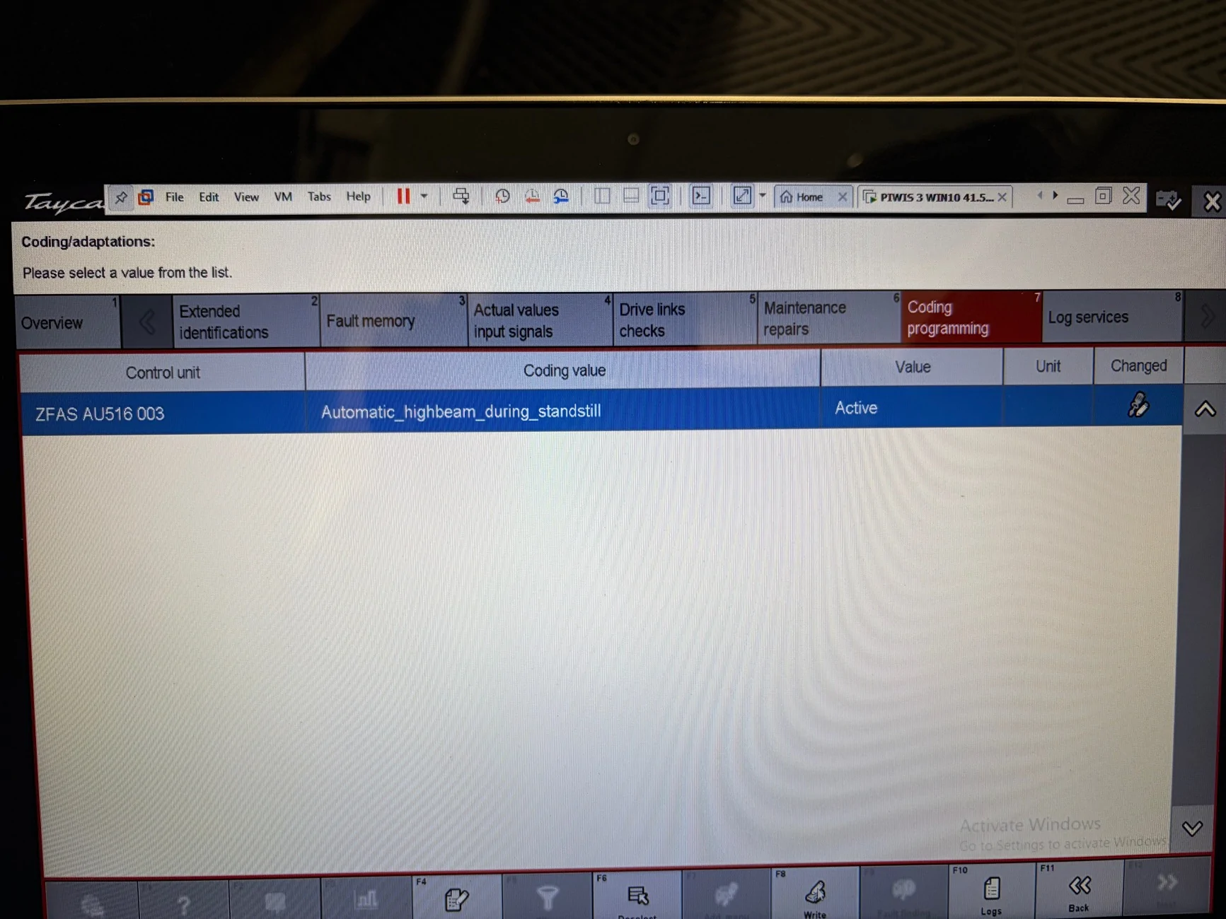

ZFAS: Automatic_highbeam_during_standstill
related settings:
ZFAS: (not in kodeirwert) Twilight_threshold_of_highbeam_assist:
Deactivation_brightness (default: 6.00)
Activation_brightness (default: 1.5)
Deactivation_brightness (when car encounters street lights / other vehicle lights) seems fine.
The activation_brightness can likely benefit from being increased (I set mine to 3.0, but have not tested it yet) so highbeam assist is more eager to activate in more scenarios.

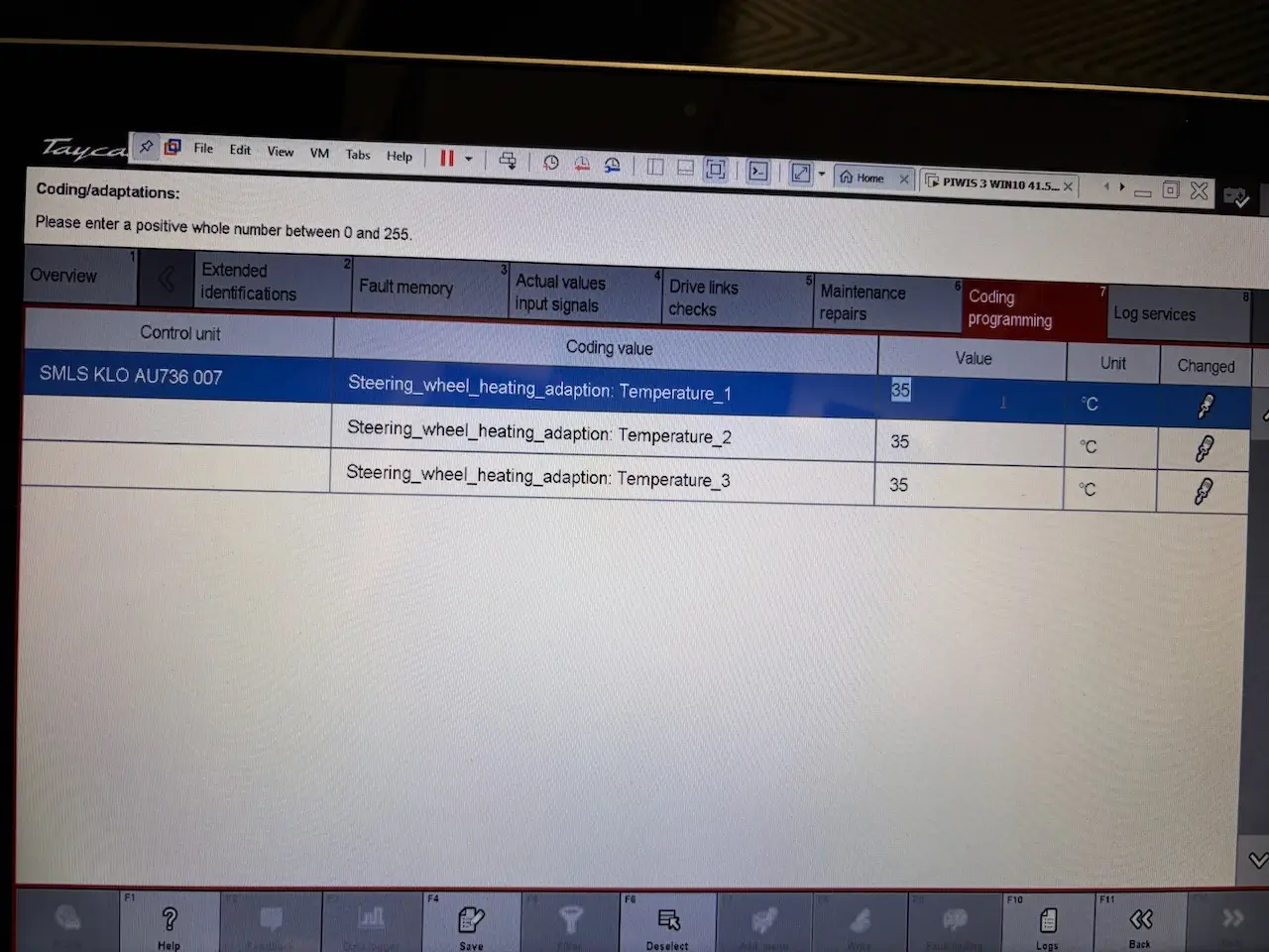

Steering wheel heating set point temperature setting:
SMLS: Steering_wheel_heating_adaption (adjust all Temperature_1/2/3).
35 deg. C is ~ 98 deg. F and is too hot for bare hands; I don't drive with gloves, which is what the default suits. I've lowered to 31 deg..

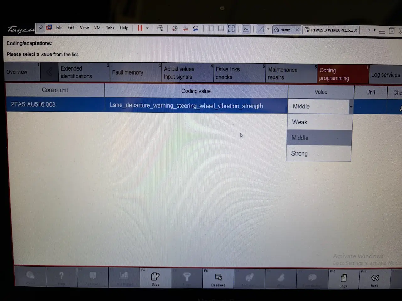

Lane departure warning vibration setting (untested):
ZFAS: Lane_departure_warning_steering_wheel_vibration_strength

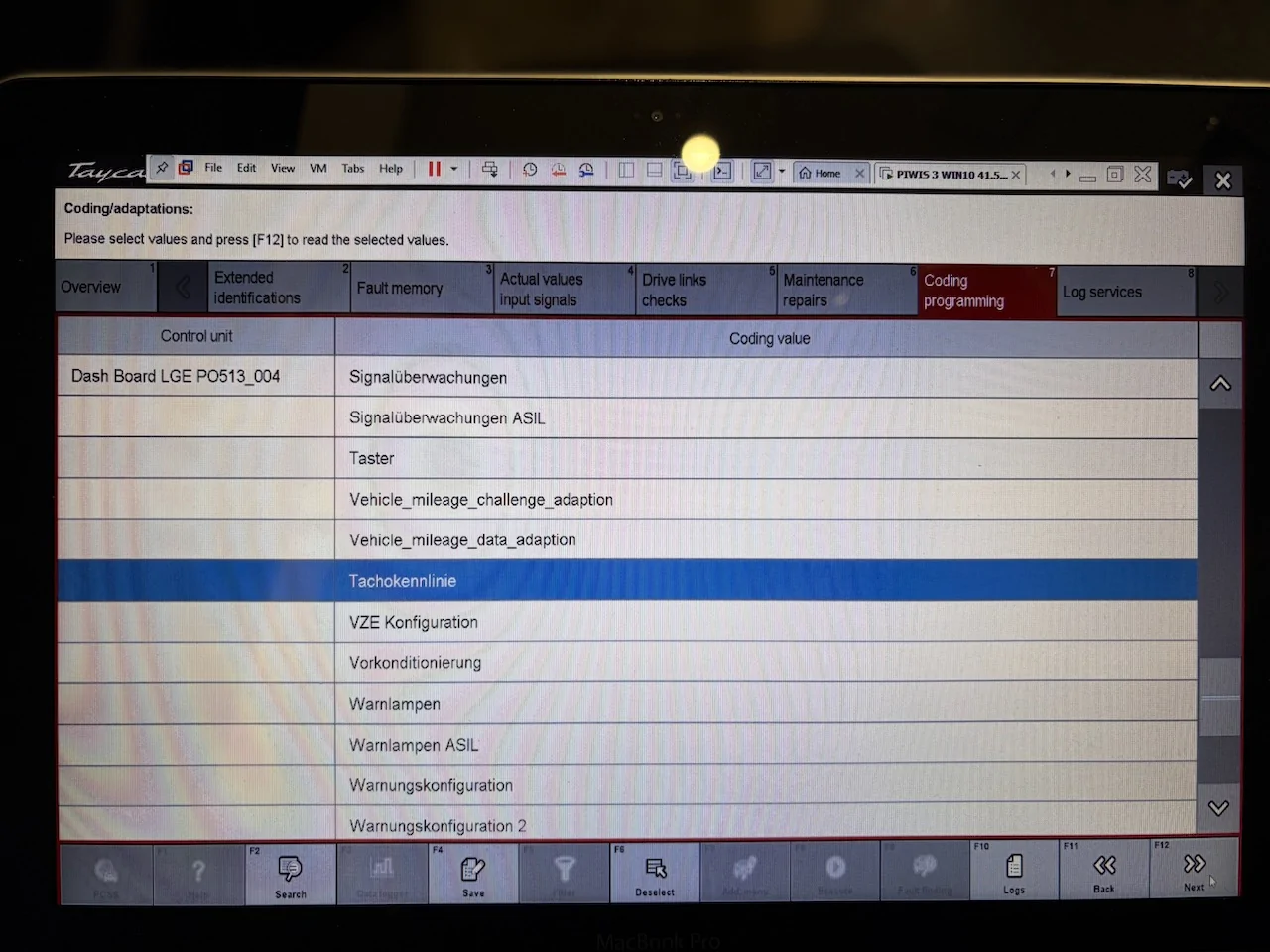

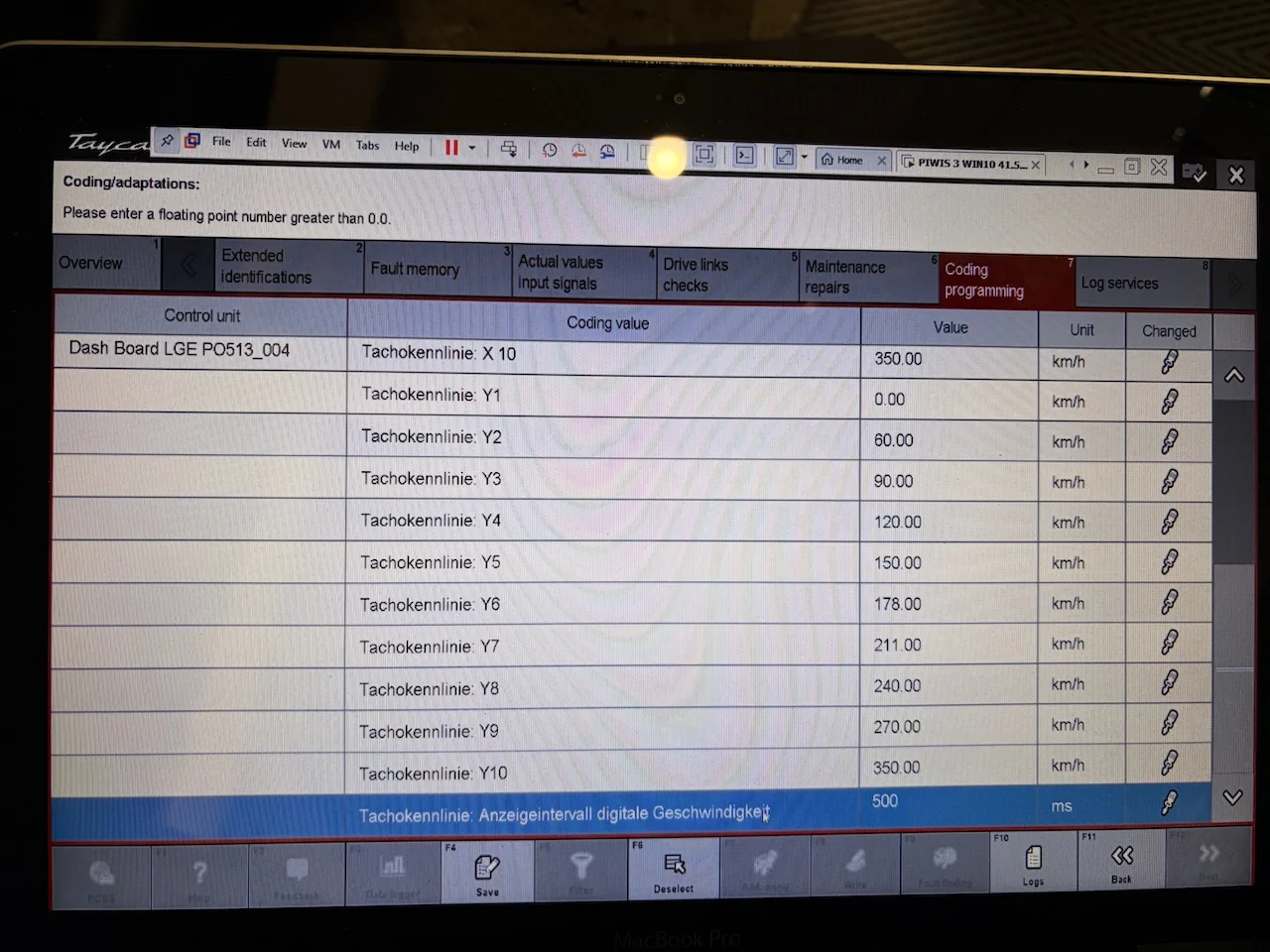

Speedometer display interval
KOMBI LG: Tachokennlinie: Anzeigeintervall digitale Geschwindigkeit
(translates to: Speedometer characteristic curve: Display interval digital speed)
Default: 500ms (equivalent to 2 HZ)
Recommended: 100ms (equivalent to 10 HZ) or down to 60ms (16.67 HZ); lower may introduce unnecessary jitter (I tried 20ms, it was too fast); value needs to be in increments of 20ms.

This is one of my favorites and I had thought was a hardware limitation on the Taycan's processing capability or display unit. The default value is likely a visual/cognitive accommodation for some drivers. For those that miss the speedometer refresh rate of a Tesla, this is a must.
Update: setting needs to be in increments of 20ms (updated above).
