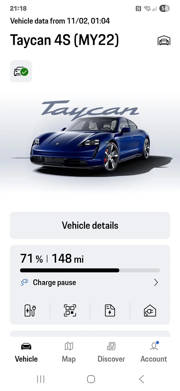

Folks...can anyone help me reset? My app won't connect to car. Have logged out and back in a few times.....still showing readings from 3 days ago from 0104am

Mine won’t connect to LTE today and hasn’t done since Saturday

Mines still dead but they think it’s an LTE fault in the car so I’m booked in for late March. Nothing else has sorted it - 12V battery, 2 finger reset, PCM factory reset, still no LtE

Daft question - how do you know you have an LTE issue? Does the Porsche app simply fail to update the current time to show the car is connected? The LTE symbol on my PCM doesn't have a line through it or anything but my car failed to charge again overnight. All it said was 'Charging Error' in the app but in the car in the lower centre screen where the battery charge shows it was grey, not green as usual and there was a swirling 'busy' circle above it.

The LTE symbol definitely had a line through it when I had my issues. As soon as that came back, app and charging working fine.

I have a line through the LTE symbol and have spent a while on the phone to my OPC going through various things to try to get it going again. The app hasn’t connected to the car since 14th Feb
