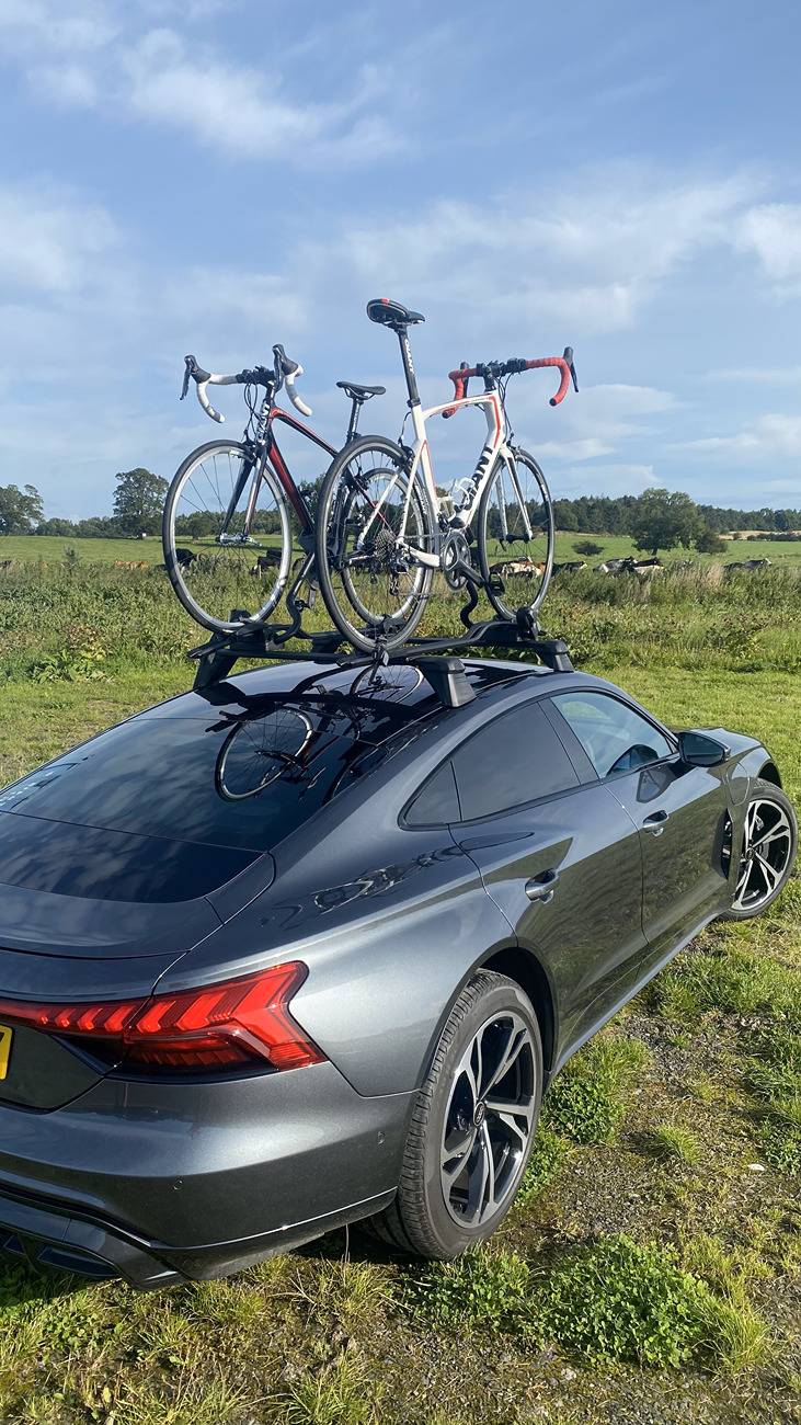

Just in case any of you lovely Taycan owners wanted to see your sister car with bikes on top.
Might be better shoved in the back of an A6 avant??
