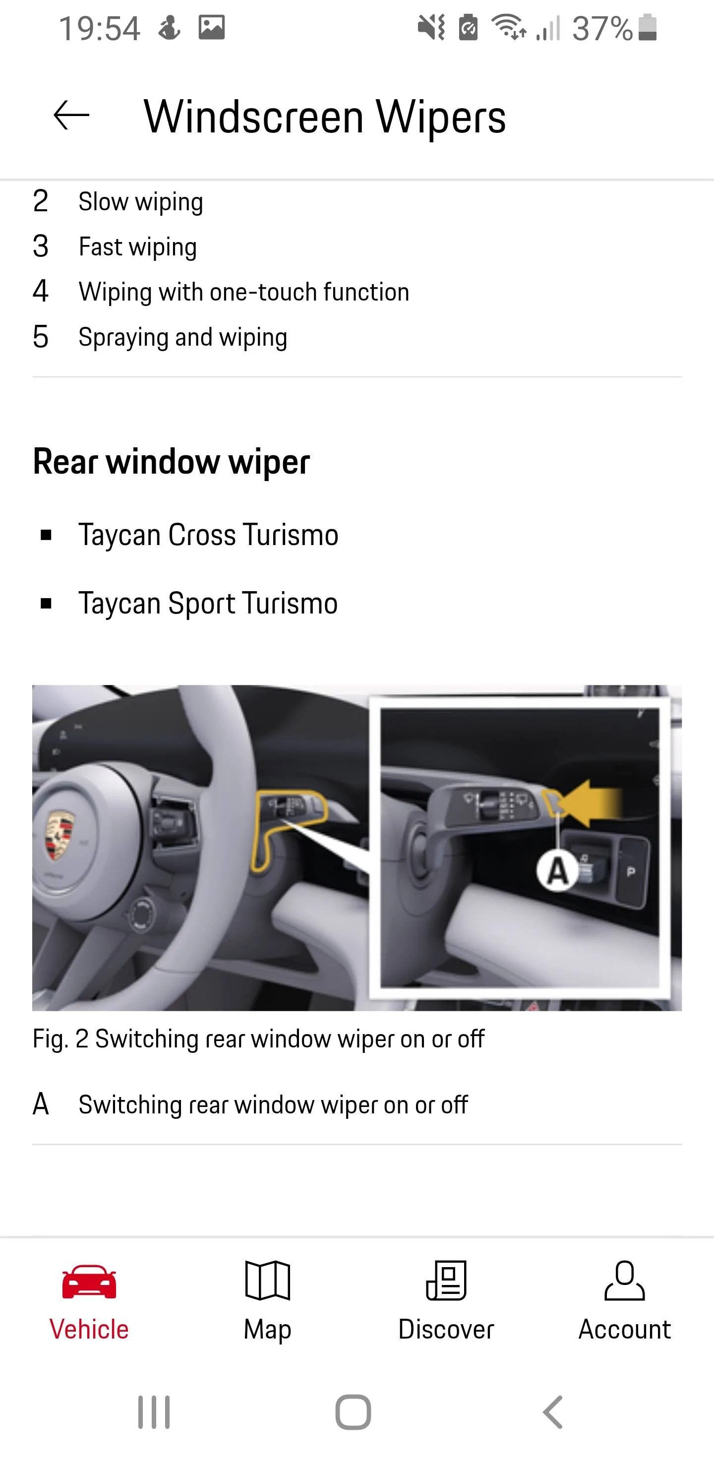

How do you activate the rear camera washer?
11,016
6,805
If you pull the washer stick whilst in reverse it will clean your camera.
For the ST / CT it's at the end of the wiper stalk - you do not need to be in reverse gear.
On the saloon it's a soft button on the rear camera icon.
Consult also the owner's manual in the app.
I think that button on the CT operates the rear wiper, not the camera wash. Must admit i didn't know there was a camera wash though. It does seem to get grubby quickly where they positioned it.
The rear camera on the CT /ST is washed when you wash the rear screen by pushing the wiper stalk forward
11,016
6,805
Push the stalk away towards the dash to activate.
For the camera wash reverse gear should be engaged - my mistake. Same on my Panamera.
Didn’t know it had it on my Panamera either! ?
