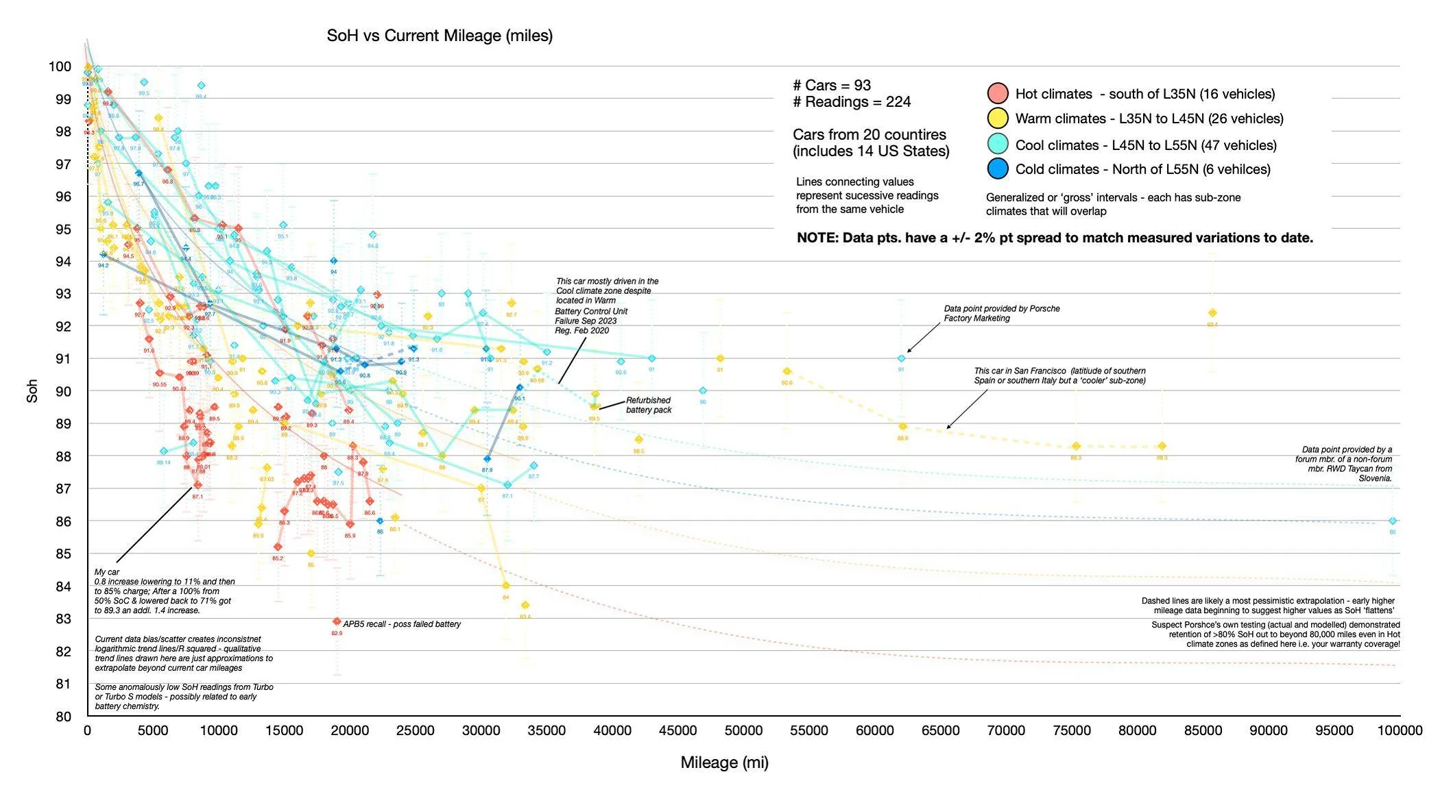

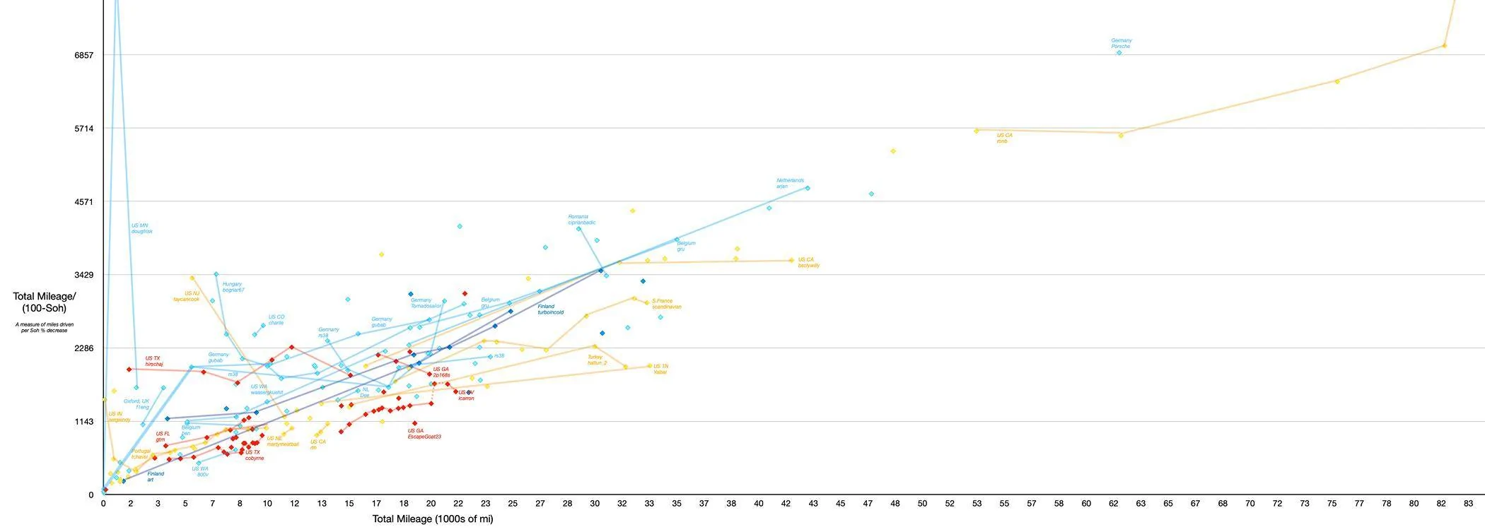

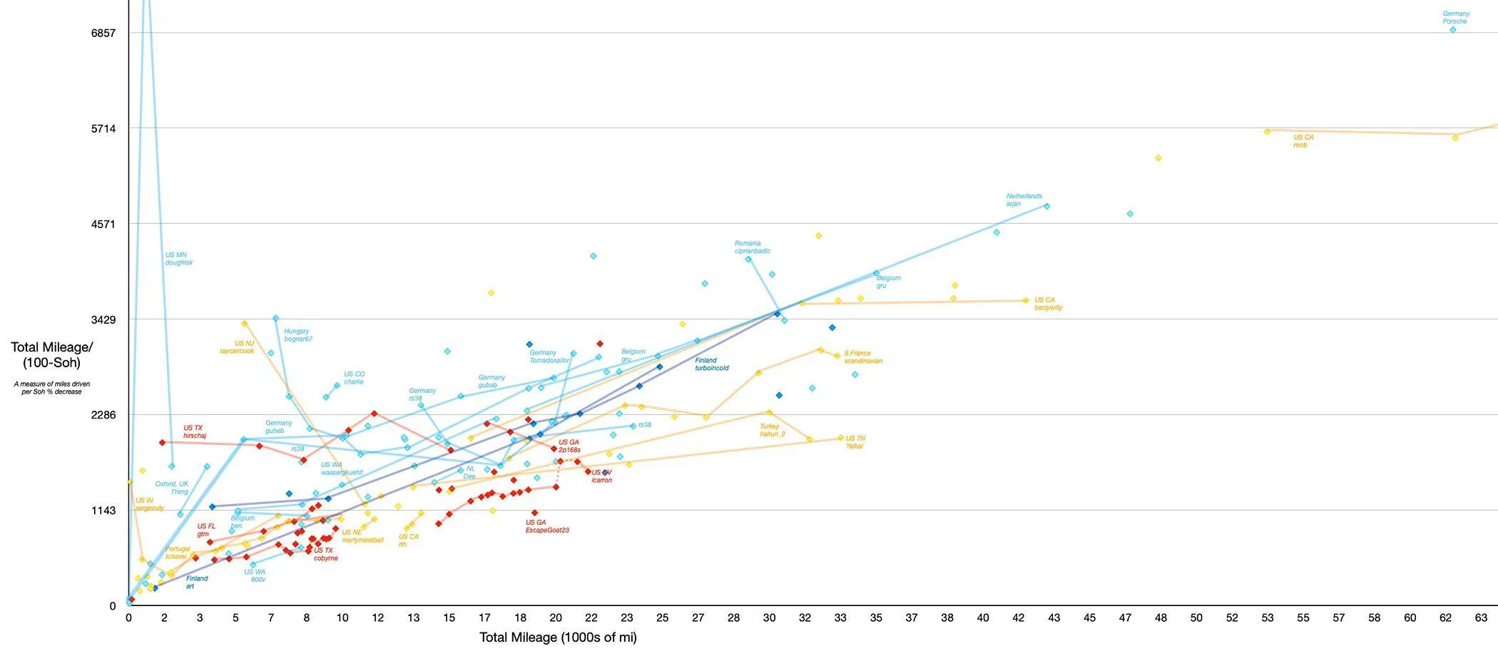

These data to date from 86 cars with 198 readings whilst clearly not a statistically robust sum are interesting nonetheless and some trends developing - in particular the known slightly higher degradation of SoH in hot climates (my primary interest).
The SoH% is believed to be, for example if we just take the 'published press' values, a % of the usable 83.7kW of the Performance+ 93.4kW capacity battery.
However 'real world' consumptive tests (e.g. #2 and insight provided by @rs38 here #38 ) suggests that Porsche were being conservative and the actual 'usable' unbuffered kW are closer 86.7kW.
Note a relatively consistent hot to warm climate more degraded SoH numbers. Cold country SoH's appear to straddle hot/warm and cool climate trends but numbers not statistically significant as yet.
I have placed 'error' bars of +/- 2 percentage pts. for every reading - this should be considered more a measure of observed variance especially after battery 'balancing' is performed as reported by a number of forum members and myself. So more correctly it s representative of the Soh range at any given time about a mean Soh value -2% on the high end and a +/- 1% being perhaps more typical.
Finally thought I'd post these two useful video links on battery degradation and how to minimize it (first originally shared by @Scandinavian) on optimal charging strategies towards preserving Soh over time by Dr. Jahn of Dalhousie University - excellent (albeit lengthy) discussion with truly relevant advice and 2nd from the Admin here on our forum:
Porsche Taycan Baseline for HV Battery SoH Performance Screenshot 2024-04-27 at 9.07.46 AM
This plot another way to visualize the rate of loss of SoH:
Porsche Taycan Baseline for HV Battery SoH Performance Screenshot 2024-04-27 at 1.12.40 PM
Zoomed to bulk of data:
Porsche Taycan Baseline for HV Battery SoH Performance Screenshot 2024-04-27 at 1.14.42 PM

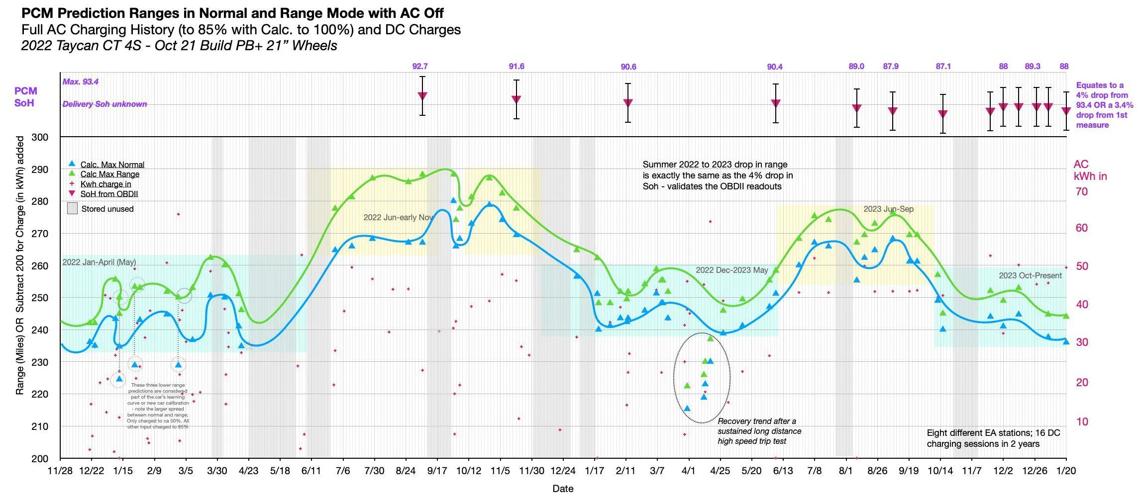

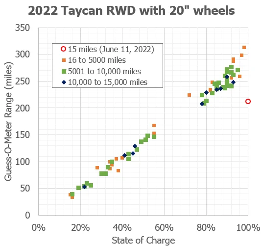

I am also adding the entire AC/DC post-charge range prediction history of my car for those interested in long term trends including winter - summer variations etc - of course my car in a hot climate. Predictions are just that and not considered indicative of actual consumptive range.
Porsche Taycan Baseline for HV Battery SoH Performance Screenshot 2024-01-22 at 5.08.09 PM

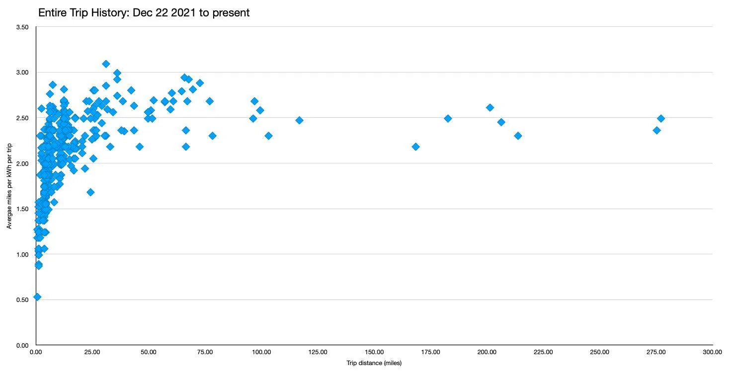

Here is the average trip data from your MyPorsche or Web Site data lists - remember these numbers are highly generalized in their own way being 1) averaged over a trip length, 2) the range her his simply calculated from the reported average miles per kWh attained regardless of trip length and the average applied to a fully (1005) SoC to guesstimate a max. range. All sorts of variables can effect that estimated range both positive and negative is again just a guide:
'Raw' averaged consumptive data from my car for it's entire use history:
Porsche Taycan Baseline for HV Battery SoH Performance Screenshot 2023-08-13 at 1.51.00 PM

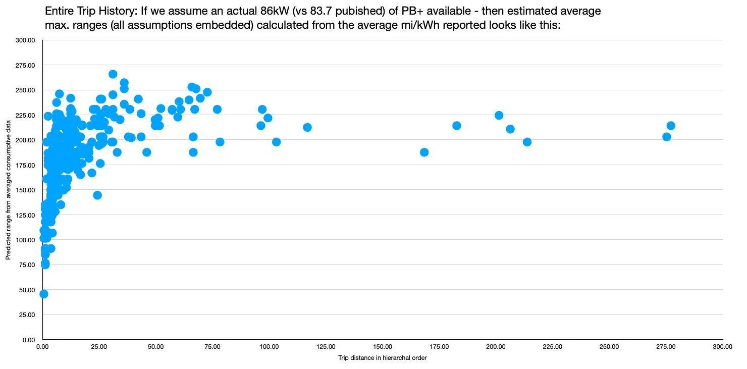

And a simple calculation to output a maximum range using the reported average mi/kWh per trip (see provisos above):
Porsche Taycan Baseline for HV Battery SoH Performance Screenshot 2023-08-13 at 2.09.10 PM

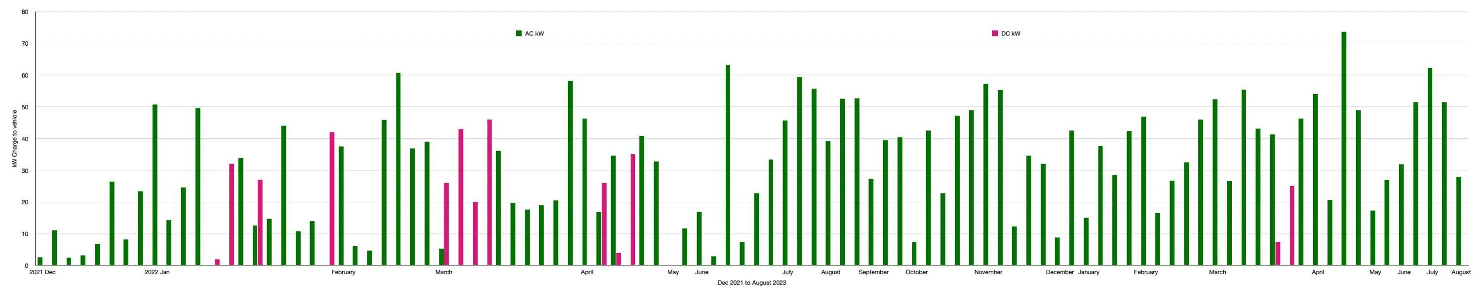

And here is every charging session (might be missing 2 but checking!) for both at home AC and on the road DC charging in kW into car:
Porsche Taycan Baseline for HV Battery SoH Performance Screenshot 2023-08-13 at 8.20.11 PM
And a overly simplistic (think most negative calculation for range as of course near 80-90% of my trips are dominated by short and truly inefficient driving metrics).
If I focused only on the longer more efficient trips I see far better efficiencies in the range of 2.6-2.9 mi/kWh.
Porsche Taycan Baseline for HV Battery SoH Performance Screenshot 2023-08-13 at 8.18.55 PM

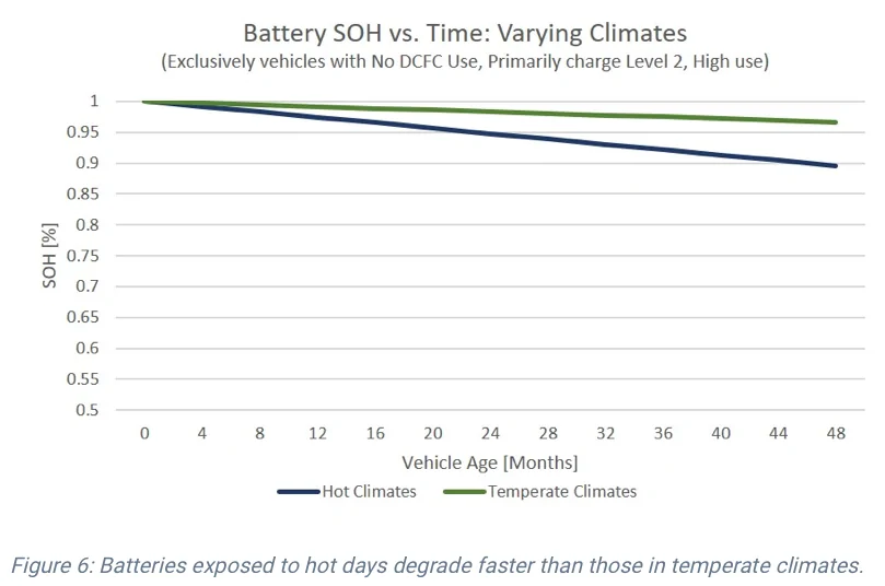

https://www.geotab.com/blog/ev-battery-health/
https://www.geotab.com/blog/ev-range-impact-of-speed-and-temperature/
https://www.geotab.com/blog/ev-range/

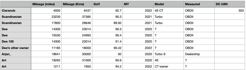

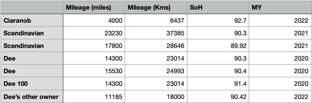

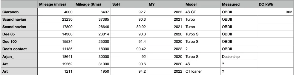

How many of you asked for or were provided data on the SoH of your PB+ battery on delivery?
I certainly did not have this on my delivery list to ask when I got mine :), but would be useful to set a baseline if that data available.
Here is a readout of my current SoH which may or may not be an entirely accurate record of the true SoH. Nonetheless it would be interesting if all those who have a proper OBDII could read off their SoH and mileage to start to see if there are trends pt. forward with again the proviso that we first might need to establish how accurate these OBDII snapshots actually are.
TBH I thought my SoH would be higher considering I only have 4000 miles or so on the clock and only ca 300 kWh of direct 'fast' charging at EA stations to date - but I am entirely ignorant as to what the delivery SoH starting pt. should be.
So at a minimum say share:
1) Delivery Soh - suspect very few if any actually have this?
2) Current SoH
3) Current mileage
4) kWh DC charging (assume remainder at home or work/destination EVSE) - see #3 below on how to obtain.
5) Build date (or just MY if you're not sure)
For me:
1) unknown
2) 92.7%
3) 4000 miles
4) 303 kWh
5) Oct 2021
Could add # times charged to 100%, how often charge dropped below 20 or 10%, and more but asking a lot already!
Cheers, C.

Here is some information from my car, 2020 Turbo.
1) unknown
2) 90.3%
3) 23 230 miles
4) no idea on where to find this information. But quite frequent charging on HPC’s when travelling.

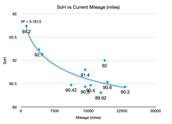

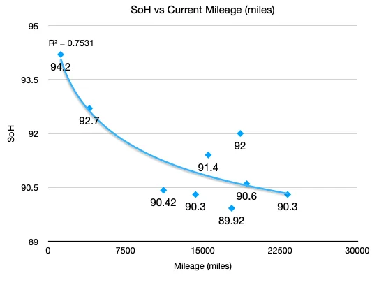

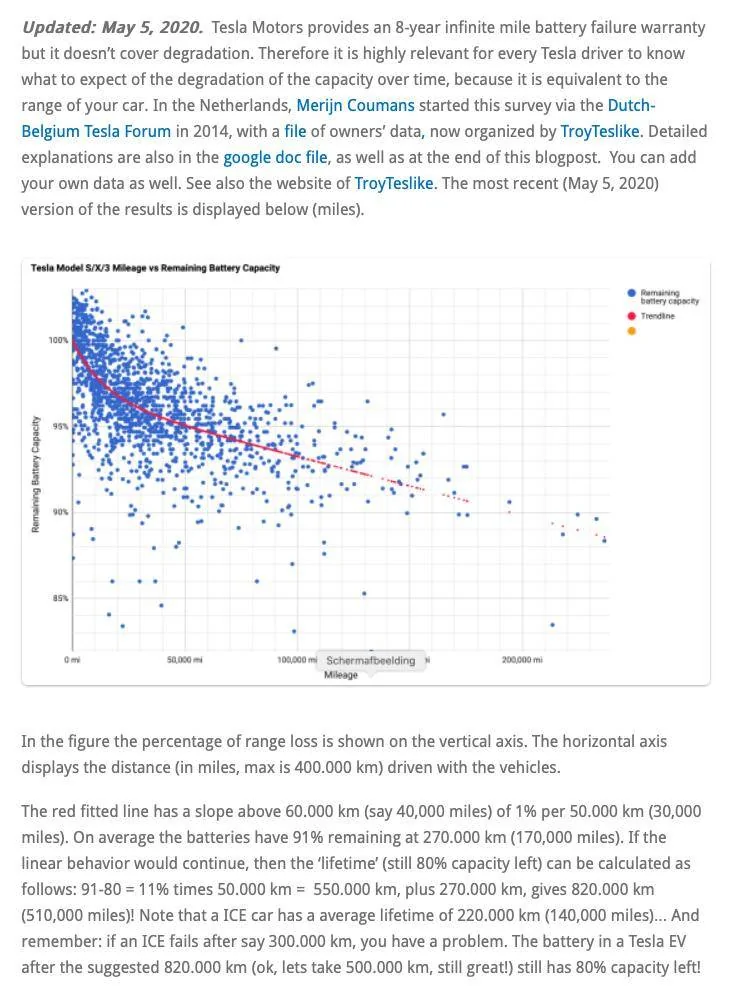

Simplest of plots with logarithmic curve (entirely understand there are many many variables here and of course a tiny population from the forum so far!) of reported SoH vs mileage dug out from @Dee 's original thread and from here. 2020, 2021 and 2022 cars used.
Porsche Taycan Baseline for HV Battery SoH Performance Screen Shot 2022-09-27 at 8.22.55 AM
Porsche Taycan Baseline for HV Battery SoH Performance Screen Shot 2022-09-27 at 8.27.24 AM

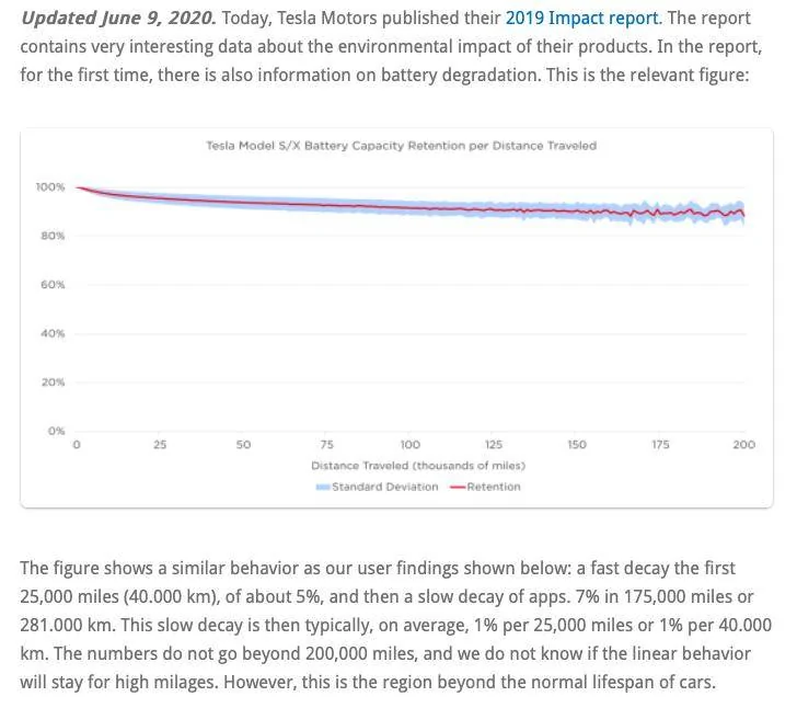

And of course there is a massive amount of data for EVs on all sorts of battery performance variables out there - nothing new here - just showing a couple but not trying to deep dive a rabbit hole and this has been discussed elsewhere on the forum - just interesting to plot our Taycan data against some industry std which I'm sure if I searched more I could find published already!! :
Somewhat dated example and Tesla focused:
https://maartensteinbuch.com/2015/01/24/tesla-model-s-battery-degradation-data/
Porsche Taycan Baseline for HV Battery SoH Performance Screen Shot 2022-09-27 at 8.30.51 AM
Porsche Taycan Baseline for HV Battery SoH Performance Screen Shot 2022-09-27 at 8.17.17 AM

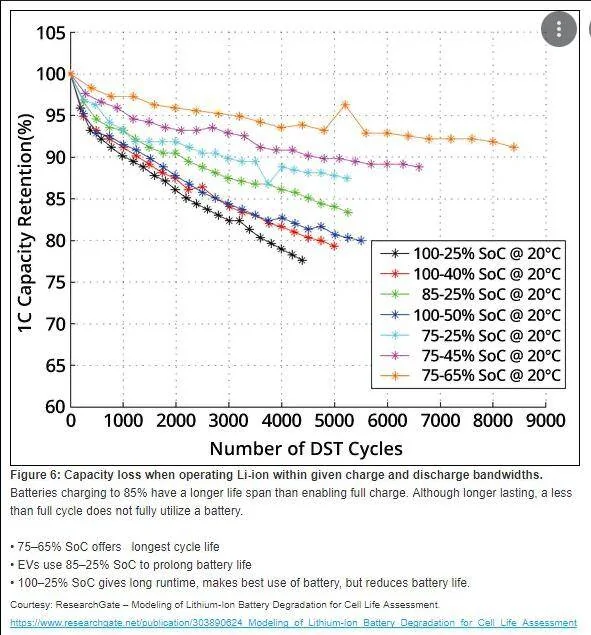

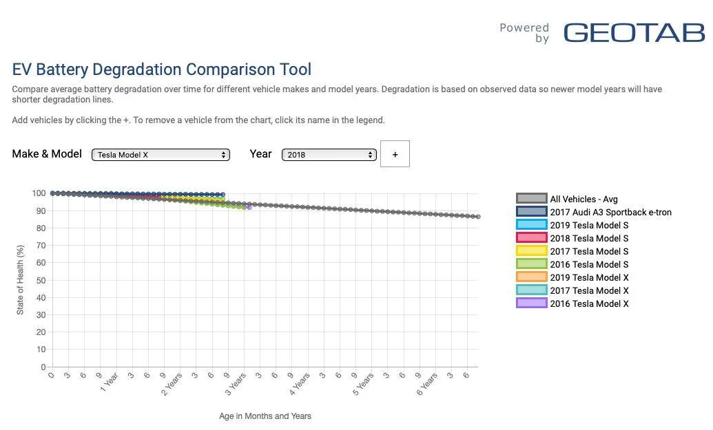

Here's a site from 2020 reports on degradation that has a 'Comparison Tool' you can play with - not much to it but spans 6 years of data.
'Layman's' Article on degradation:
Tool:
https://www.geotab.com/fleet-management-solutions/ev-battery-degradation-tool/
Porsche Taycan Baseline for HV Battery SoH Performance Screen Shot 2022-09-27 at 9.23.30 AM
A common observation from industry research articles and repeated here is the increased degradation in hotter climates such as Houston/Arizona etc. but a very minimal difference i.e. nothing to sweat about (intended :)) being ca. .05% more over 4 years
Linkt to their Temperature Tool:
Porsche Taycan Baseline for HV Battery SoH Performance Screen Shot 2022-09-27 at 9.30.07 AM

So.. was there plan to collect this data? Sounds interesting. Here's two dot's from Finland:
2020 4S 31000 km 90.55%
2022 CT 1950 km 94.20% (loaner while uPdate)
UPD:
Read with reliable app made in country which invades it's neighbour countries.
3,090
2,690

Here you go - found another user point but bit of an outlier and measured by dealership not indep OBDII - included though.
I will start to post and update this chart at the top of the thread (post #1) once we get a little more critical mass :)
A question mark means I am not certain re input - help if you can!
Curious that the two 2020's appear to retain a better SoH over time - of course not statistically significant at all with two data points! But w/o these two pts. the R2 would be much higher.

Ah - must have misread your entry - so the change to higher 100% charging free is up to the higher mileage .- I will change.
Yeah, pick what you want as it's just a sort of approval to use my data, it's a Turbo S indeed. 😁
Note that my SoH is calculated more accurately since I've started to charge to 100%, it probably was >91,44% all before. 🤗
