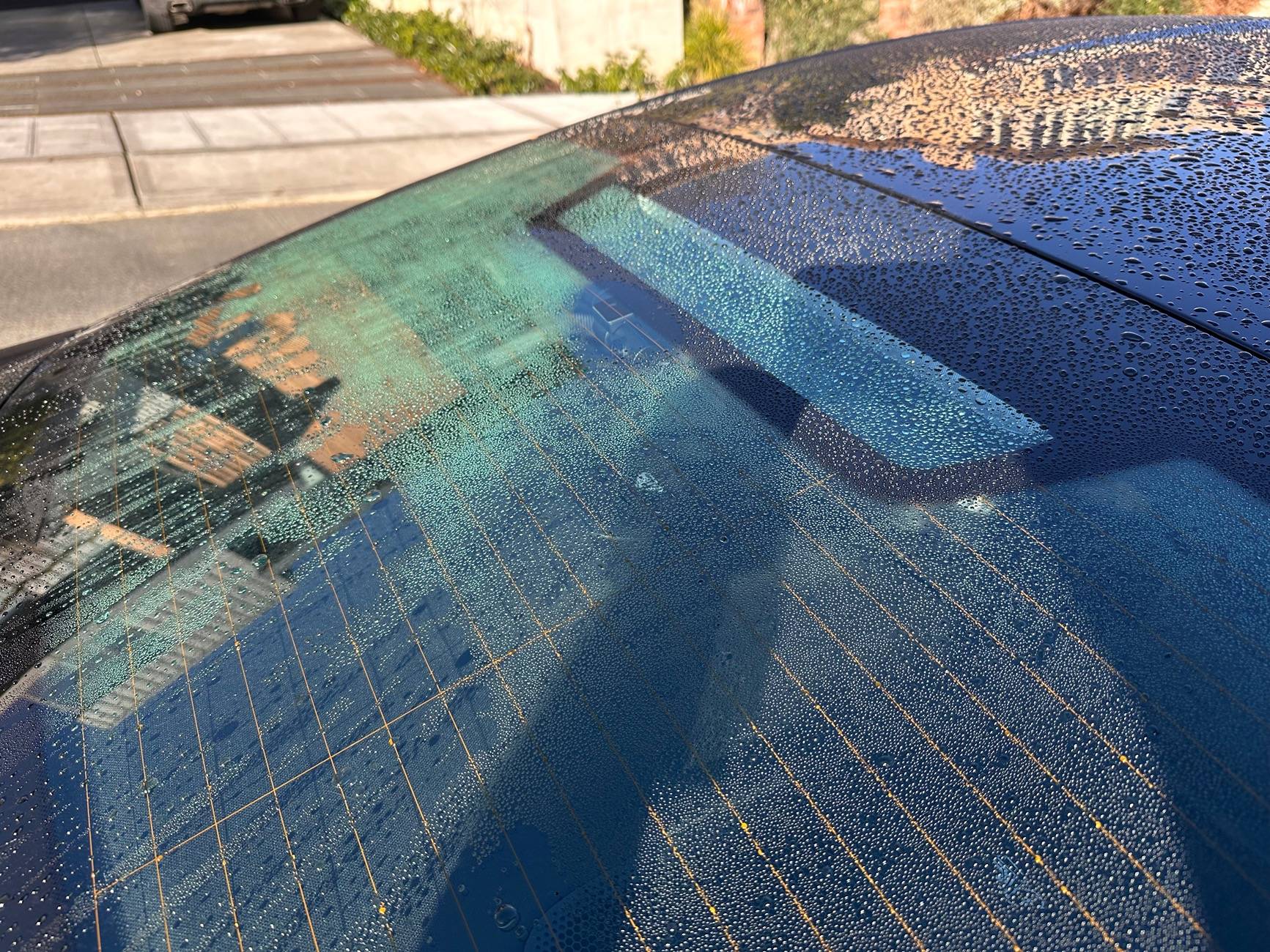

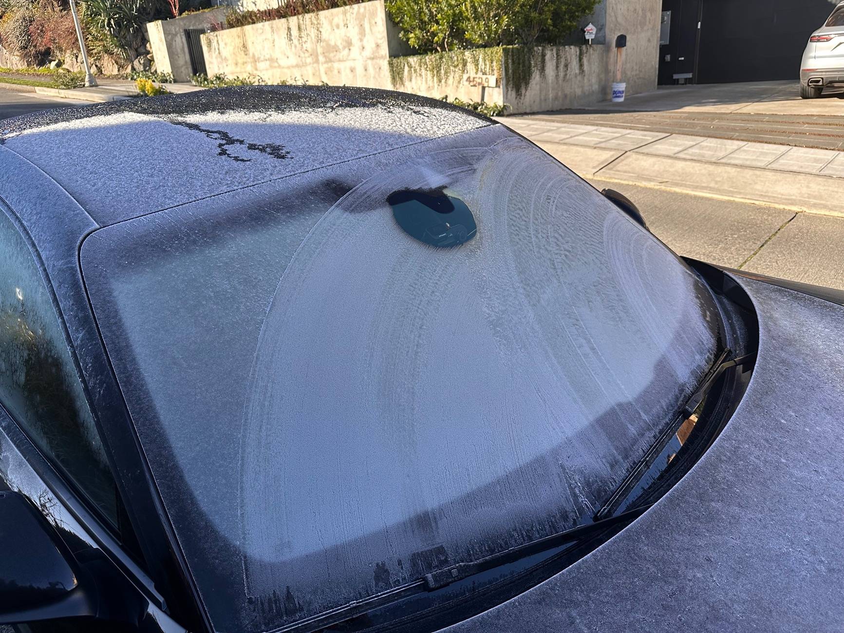

I had the Blakvue installed mainly because it’s what the local car electronics store recommended. 3 days of parked recording with its battery. But this was a neat surprise: On a frosty morning the heat generated was enough to melt a window in the frost to get a clear recording.
Porsche Taycan Best dash cam for the Taycan? IMG_5039
Porsche Taycan Best dash cam for the Taycan? IMG_5040
