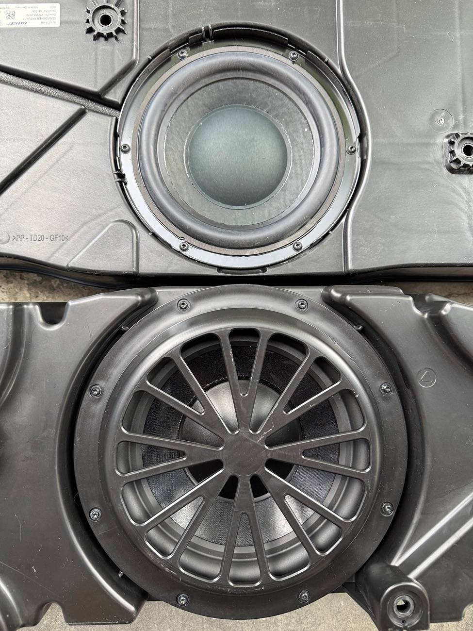

9J1035481A - Subwoofer(pay attention to letter A at the end of PN, its the all difference between bose/burmester subs, also make sure you order burmester sub with AMP unit in sub. Its usually sold together, but some sellers might sell separately), sub AMP connector PN - 4F0973712

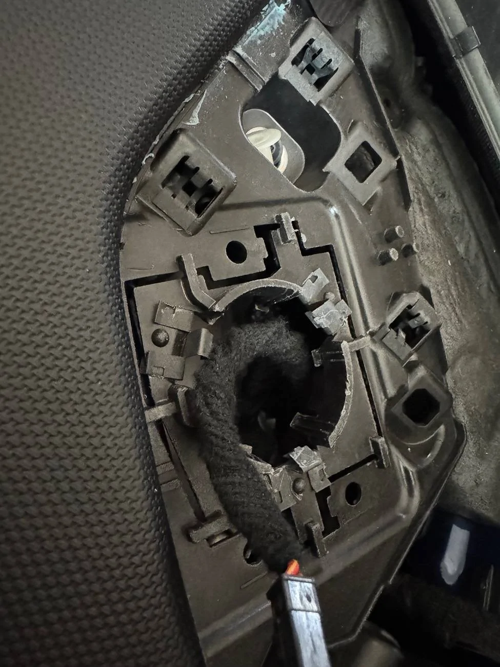

I started with replacing all speakers I had installed on Bose spec. Started with dash tweeters. I had to make a cut out a circular mount hole for older tweeters, but luckily on dash there's a precut for rectangular tweeters, so just using cut fires you can do that in 30 sec
Then I just added nuts and bolts, replaced connectors and plugged it back. The most complicated part was removing A pillar trims, they have metal clip which is tricky to remove.

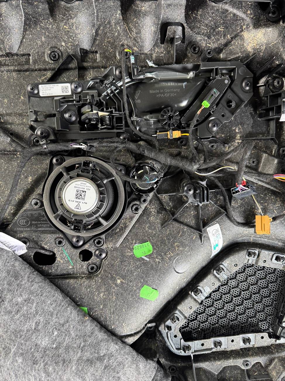

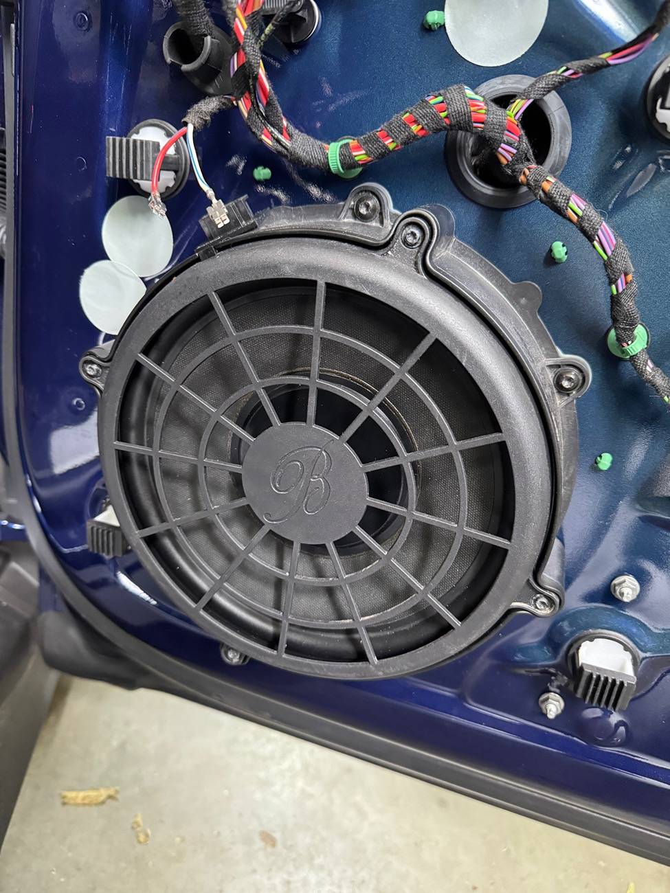

Then moved to doors. Nothing too hard. 2 bolts holding door panel, which then slides up. Removed old speakers, replaced connectors and put in new speakers
This part was straightforward but took almost a day since I was first time doing connectors and pins, had to figure out how to remove pins form connectors, use crimping tool, etc

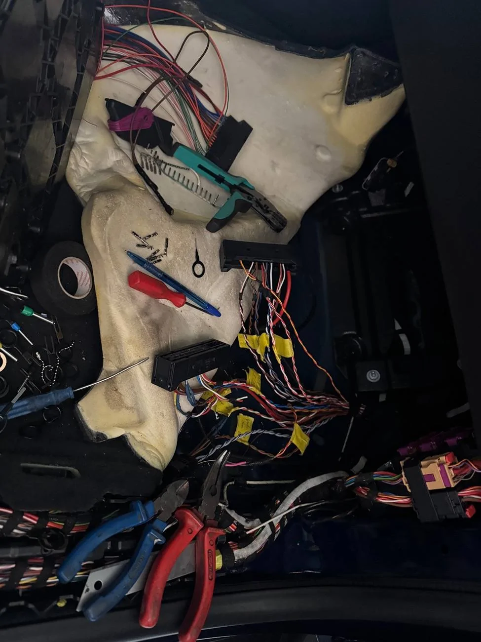

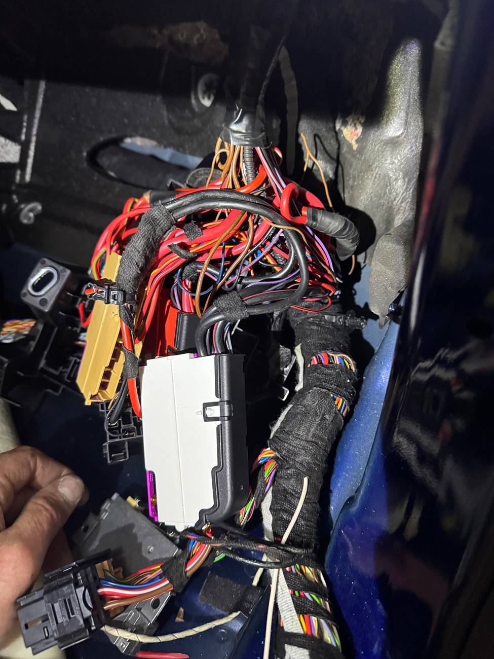

Started to adding power to new amp. Removed duck tape from around fuse box to see where power comes from(I was also checking wiring diagram and where it's taken from factory). Added new wire, routed it to fuse box(to the exact place where it should be as per wiring diagram, there are 1 50A fuse for Bose, and when adding burmester - next will also be 50A). In the footwell found where to put negative wire.
On photo it looks super messy, but when I duck taped it back it was same as from factory.

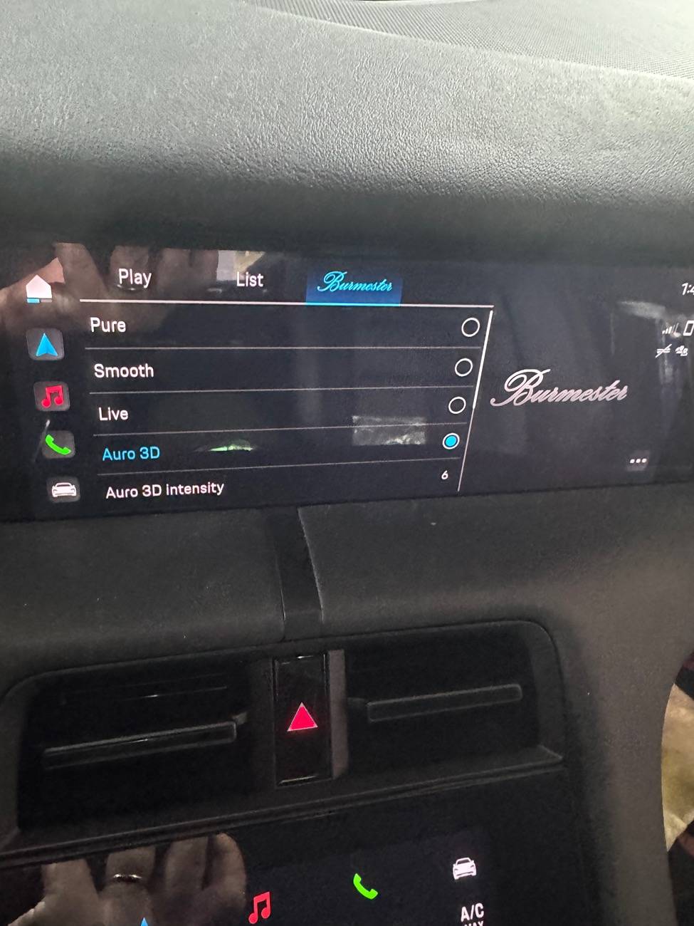

Next step turned AMP on and immediately see my PCM changed from Bose to burmester(it was loaded with Bose and then in like 10 seconds changed to burmester)

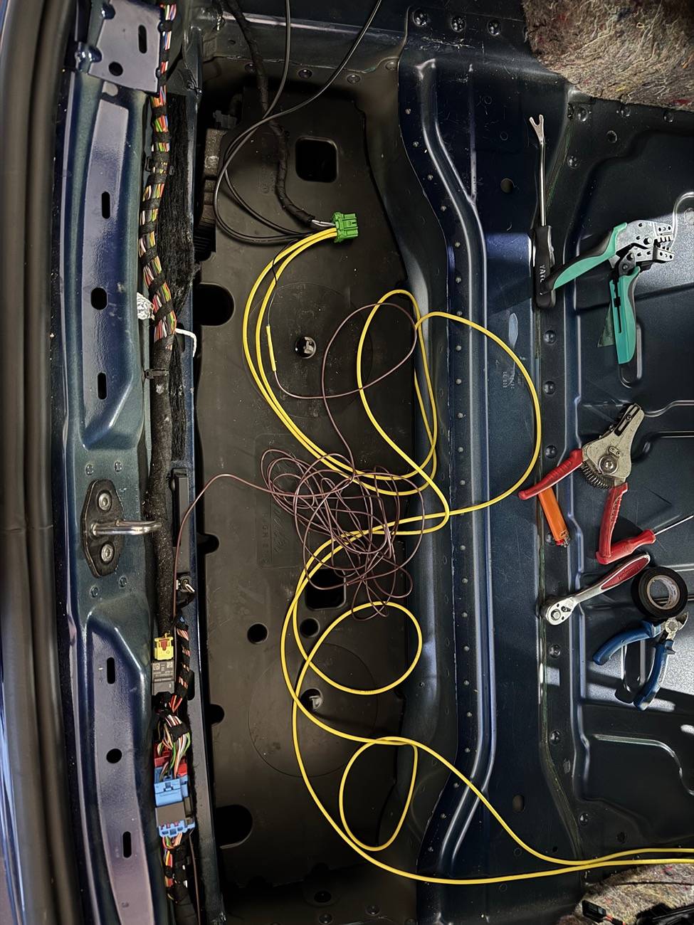

Next step was - to connect 4 rear shelf speakers. On burmester you need separate channel to shed mid speakers(on Bose they paralleled with rear door woofers). Wasn't hard, just made sure I cut big enough wire to align it with existing wiring looms to make as factory as possible.
Since I was doing rear, I also added 1 wire to trunk which needed for remote control for subwoofer. After that I assembled car back, because I still didnt have subwoofer(ordered one without AMP unit on it so it was useless for me).

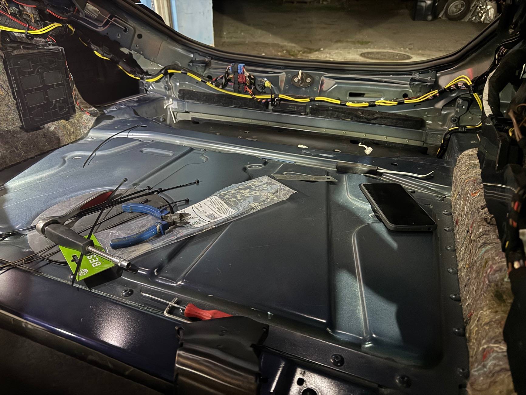

Once sub arrived, I removed trunk trim. Same story - added missing power wires to fuse box(as per wiring diagram), added fuses, pinned all new wires into connector and tested it with sub. All seemed to work, so I just had to clean up the wires, attach them to existing wiring looms and call it a day

After spending few days with burmester I can say I'm happy with outcome. I tested it with other taycan which has Bose music and difference is really noticeable. The sub playing a big less boomy but has sort of deeper feeling. Same as door woofers - they less boomy, but bass feels deeper. Tweeters are super clean, and even at 2 on equalizer, they feel like too much, I might even pull it down to 1.
The car recognized AMP well. After I done the job, I actually changed car configuration that it has burmester instead of Bose, but it wasn't necessary, I just wanted to keep car configuration to match the car.
