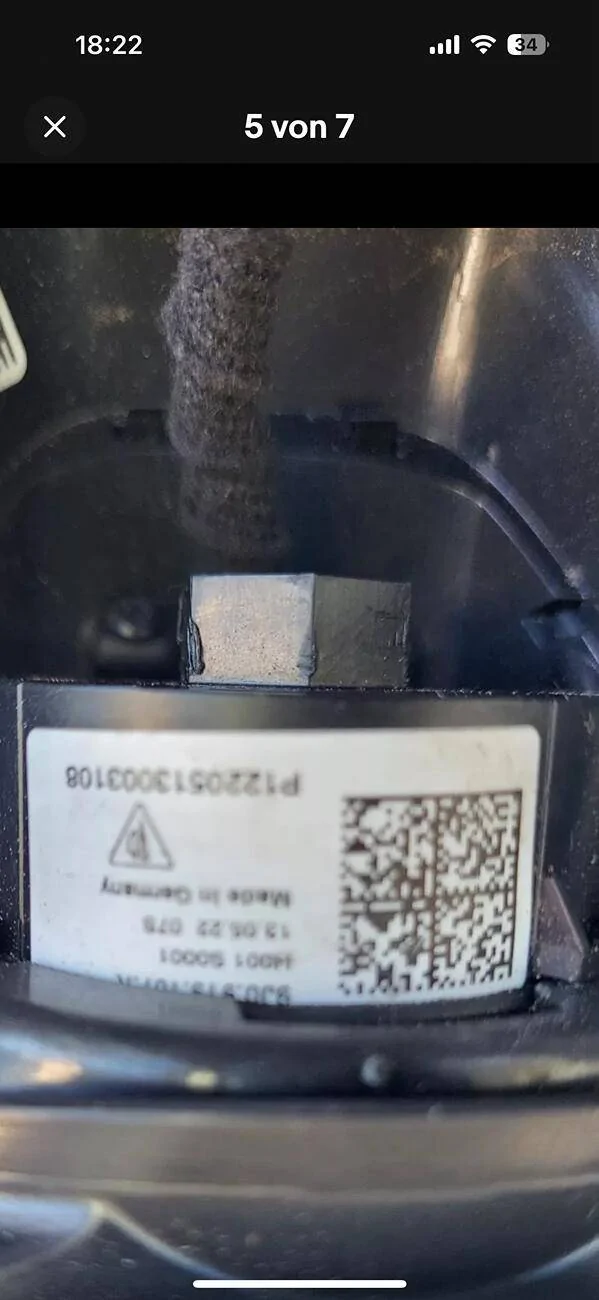

Correct. A bit tricky with the part number, I only have the following picture.
Porsche Taycan Retrofit Compass? IMG_8015
oof! that's tricky. I can clearly see 9j0919107 which is the prefix for the compass. In searching dealership parts stores, I cannot tell if the final 4 characters (for example M6N3) indicates the face plate color or the car model:

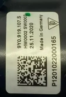

Also confusing is on the part itself it doesn't list the final 4 character. Here's a part I found on ebay that came off a 2021 Cayenne.
Porsche Taycan Retrofit Compass? 1740077478224-25
In any case, it's good to know it's likely plug and play with no coding. This gives me confidence to either take a chance and buy any compass with prefix 9j0919107, or just buy a new compass from the dealer for the Taycan. Used parts at at least 50% the cost of a new part, so do let us know if coding was necessary.

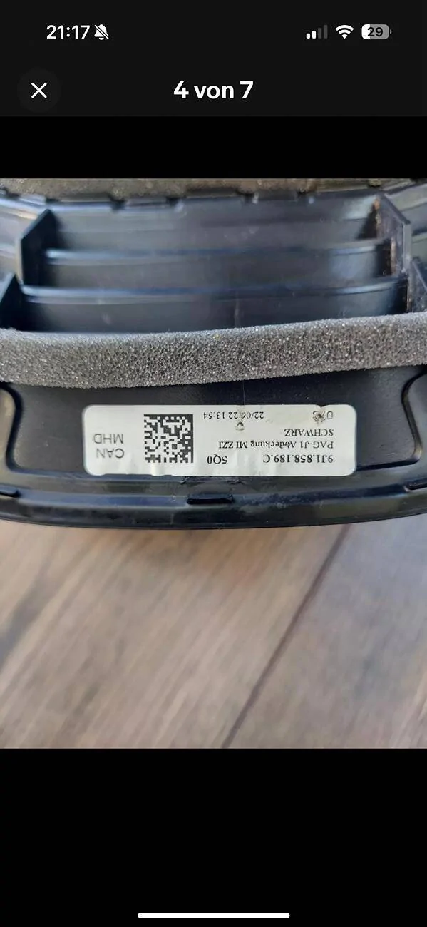

Mine was/ is definitely the Taycan part, as it came with the inlay from the dashboard.
It's even the same production month like my Taycan.

Awesome thanks, yes 9j1 indicates it's from a Taycan
