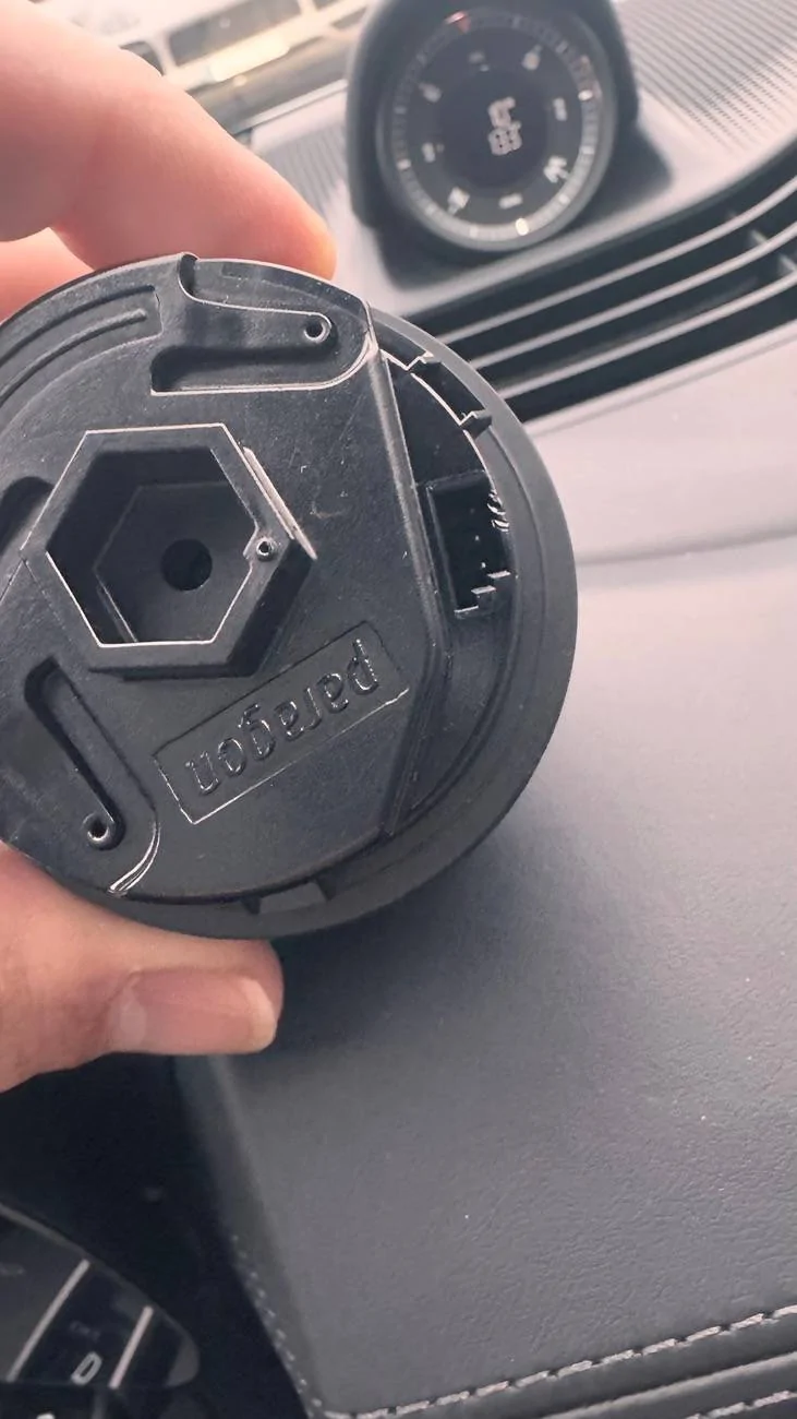

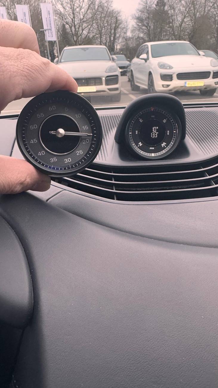

So here a few pics.
I have the Taycan compass.
No further info, whether a Cayenne or Panamera would fit.
The swap itself is super easy, The clock is released/ fitted with a 1/4 turn from the backside.
Connection is made with a small plug.
I am waiting for an answer concerning programming needed or not.
Can anybody with compass installed confirm the following:
In the PCM menu, it is referred to as "clock", not compass.
Porsche Taycan Retrofit Compass? IMG_8014
Porsche Taycan Retrofit Compass? IMG_8013
