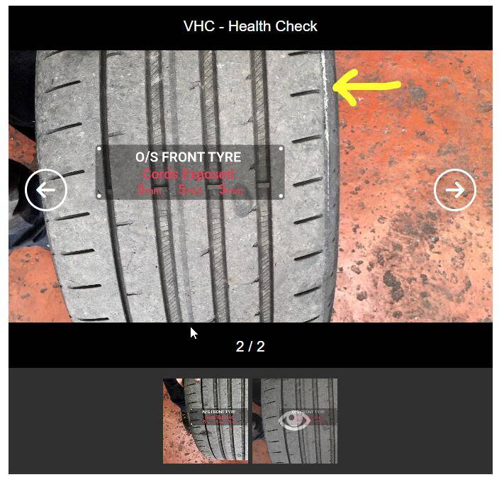

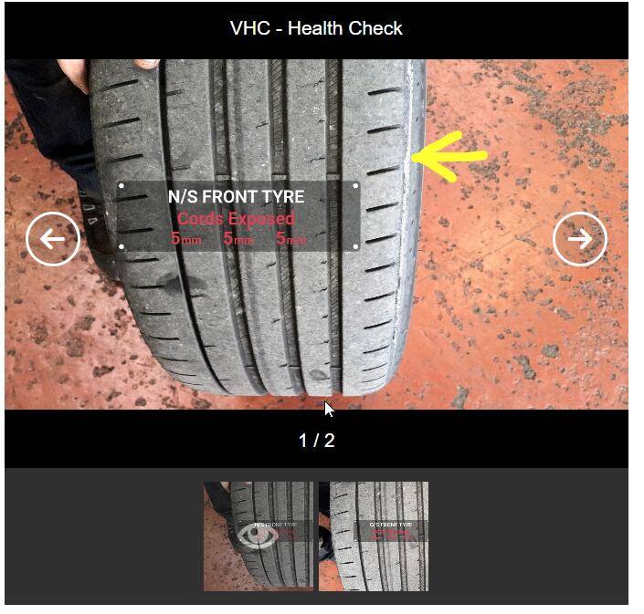

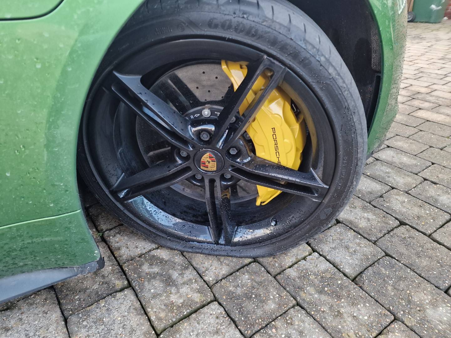

This is primarily wear from low tire pressure. The tire in the first picture of your post is flat, or almost. I'll assume the car wasn't driven this way. Both tires are worn on both very outer edges. One side to the cords, the other very close to the cords (blow up the pictures and this is pretty clear). I can't tell from the pictures or your description but my guess is the inside facing edges are the ones worn to the cords. A little negative camber, really wide tires and low pressure and the inside facing edge wears first.
14,000 miles isn't really all that bad but given the tread left across the face of the tire you should have gotten considerably more. Always set the pressure cold and get a decent pressure gauge. Based on the info on Porsche's "Good to Know" you should be at 39 psi cold. The 40psi, cold, that Kwikfit set your tire to should be about right. Warm day, highway speeds and pressures will go to 44 psi. Don't adjust your tires when you get home after a drive.

You said "outer edges" but is that on the inside side of the tyre (nearest the suspension) or genuinely outside (the outside edge of the car)?
There are a few threads on this, the exact same wear. But usually it's the rears.
A forming view (on here) is that the camber settings on the car go too aggressive when the ride height drops, which may cause it.
I'm also wondering if the NF0 spec might have something to do with it... I wonder what was specified for the side walls and tread softness and whether some sort incompatibility causes premature/odd wear... If camber were the sole cause, I'd have thought the general tread would wear more towards that side of the tyre. But it doesn't seem to.

The reason people are asking if the shoulder wear is on the inside edge or not is due to this thread - and a common issue affecting members here.
Not sure if you are aware of it or not?
https://www.taycanforum.com/forum/threads/taycan-problem-potential-catastrophic-tire-failure.16788/

No apparent balancing issues, no wheel alignment issues. The tire pressures have been set at the manufacturers pressure, or close too, it's difficult to tell with the app, car, and pump all giving different readings.

Your first picture I assume you have a puncture or the car is standing on very uneven ground?? That tyre pressure would else be far too low.

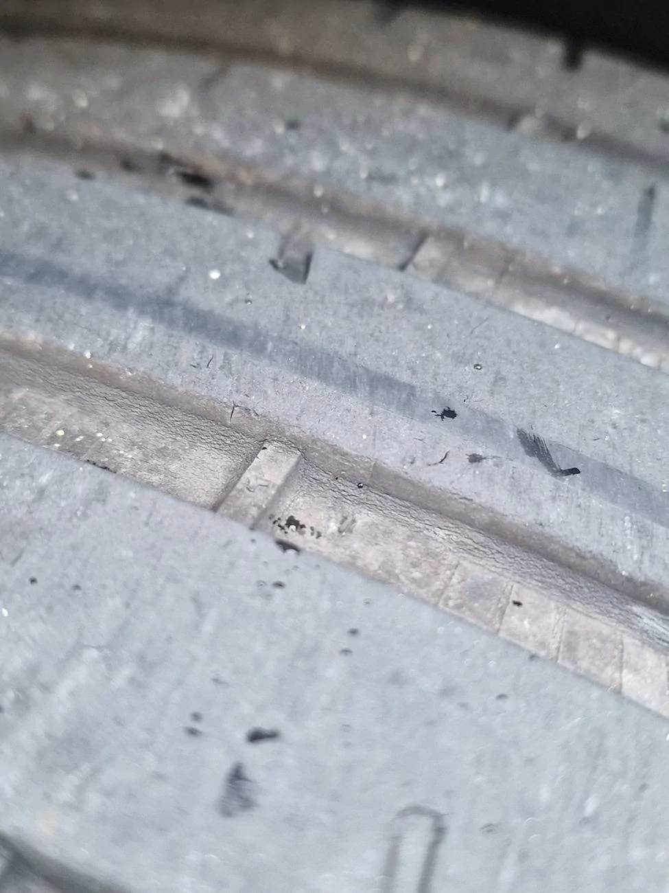

Your tyres in one of the pictures also look very dry and with small surface cracks? But they should not be too bad, unless you loose pressure over time.
