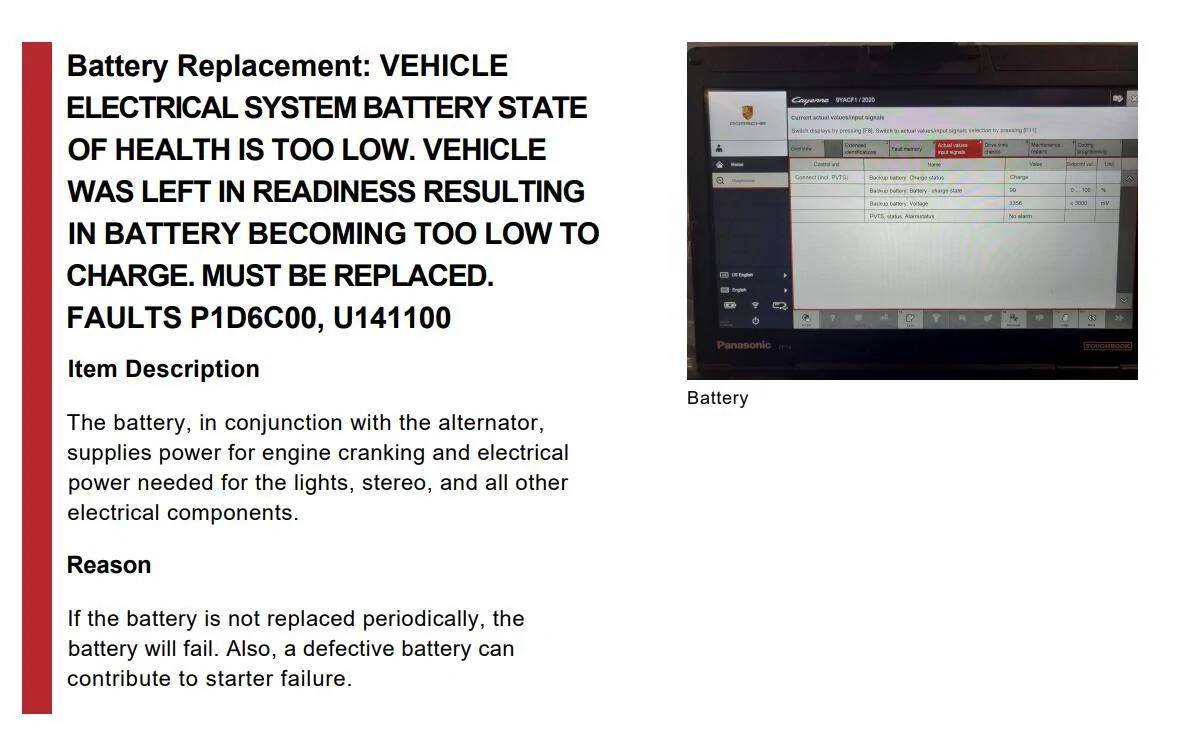

I am not happy that as owners we need to worry about this and need to remember or set reminders for ourselves to babysit the 12v battery, but I can tell you after my Cayenne 12v battery discharged while a shop was working on a door hinge and then relay closed to make it totally dead, seeing the $5K+ estimate to replace it, would make anyone pay attention to this topic.
My 15-year-old exceptionally cared for Acura could not start due to the battery, so I jumped it, and an hour later, the Acura dealer got me a new one for $175 with a 100-month warranty << - that I can live with.
This is proof, the cost of 2020 Cayenne 12v replacement, before all taxes/shop fees.
Diagnostics and quote below.
This is totally insane.
Being the Taycan my first Porsche and recalling that my MB is on its 3rd battery over the years (at $200 each), I'm definitely having a "second thought" moment.
People are actually paying 3.5K each 5yrs to have their batteries replaced on their Porsche cars?
