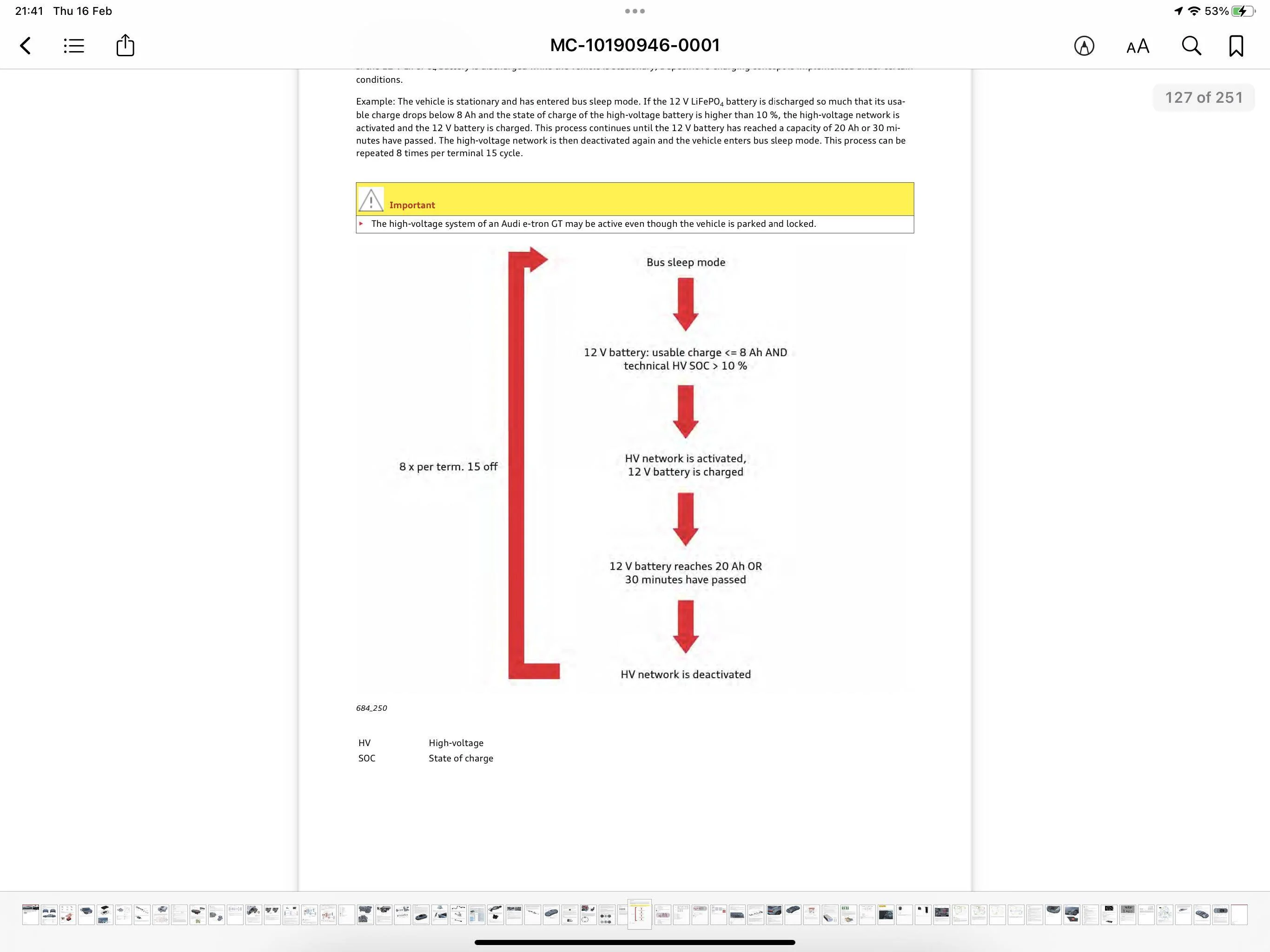

Agree it should not be a problem, but it seems the 12 volt battery will only receive a charge from the main battery for 8
cycles. And perhaps I just ran out of cycles. I did not try to communicate with the car since I knew waking it up will take power out. But perhaps the car tried to send something to mothership from where it stood parked. And I have not checked for network coverage there either.
Have a look at the Audi trading manual which was posted here in the Forum.
Very interesting but what would the rationale be for only 8 charge cycles if the main battery still has a decent charge?Also this assumes that the Porsche architecture is the same as Audi"s
Only Porsche knows! Good question if Taycan and Audi share the same sw. My guess is YES! You will also see a lot of parts in either car being fully interchangeable.
The largest Porsche dealer in the world is located here in south florida ie Porsche Champion and i think the world of their technical department so I am going to follow up on this question of how many charging cycles the Taycan will allow.Will let you know the result

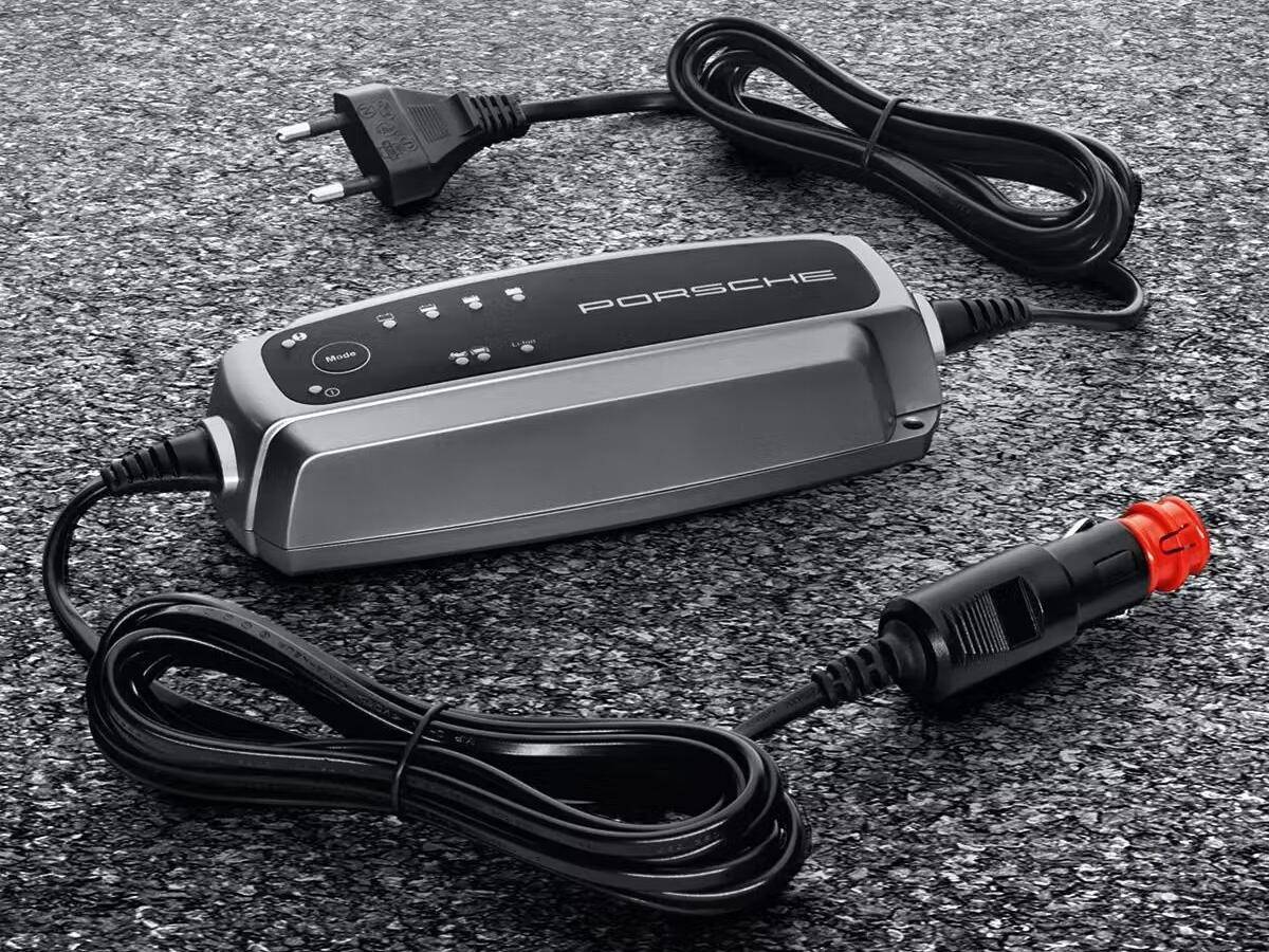

They recommended trickle charging it if I wasn't going to use the car for prolongued periods - the manual says the same. I got a Porsche Charge-o-mat Pro Charger - 'with trickle charging and battery monitoring functions as well as two charging modes for Porsche 12V lead-acid batteries and Porsche 12V lithium-ion batteries'.
I plan to get this one as well to trickle charge 12v when not connected to EVSE for long periods of time, for me 2-4 weeks is about max, but do not want a dead 12v battery. However, this one sold and pictured with a cigarette lighter (does that work) or I need to get the clamp kit to connect to the terminals in the frunk. I am still learning and waiting for the car so appreciate this guidance to get it right.

My question is what is the place to connect it to: Cigarette lighter or Clamps to terminals in the frunck.
Cigarrette lighter will not work. Clamps for battery terminal will work. Make sure you get a proper Lithium charger though, not the normal CETEK trickle charger
That is helpful. Then what charger then to get if CTEK is not the one. The dealer suggested this kind, would that one work or similar?: Porsche Charge-o-mat Pro Battery Maintainer and Charger
The older cars required that the car be off. Then after 1/2? hour plug into cigarette outlet with the battery charger, then plug the other end into the outlet. Or something like that. Have no idea if that works with the Taycan. Battery posts will work for sure.

CTEK make their own branded chargers as well as the chsrge-o-mst for Porsche.
I have the Porsche version which I got for my Boxster 11 years ago. It supports Lithium batteries.
Never used on my Taycan.

I have been corresponding with my OPC about this. I believe it comes down to the number of times the 12v is recharged by the main battery (a maximum of 8 times) - ie it's all in the software. I asked them why limit it at 8? Why not 100? It doesn't even recharge it to 100%, so it's not surprising we are seeing so many 'failures'.
They have told me they cannot advise on this as we do not get involved in the design or development of software updates. What we will do it post your information into our feedback portal to PAG – it will not get a direct answer but it may well assist the development of this as we move forward. Fair enough.
