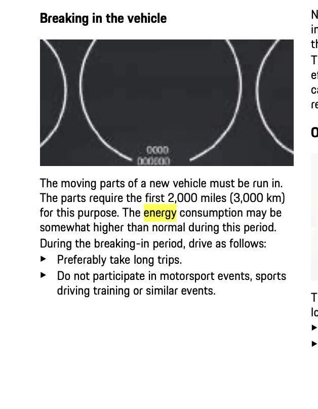

Its an algoritm. My car used 1200km. Another friend of mine used 600km. The more you brake, the shorter the need. I started with a roadtrip.

There are a number of factors at play. I had the same thoughts as you. First of all, unless it's over 80 degrees outside, your battery is taking a while to get up to the proper operating temp and it is operating less efficiently until then. If your drives are <10 miles you might not be even getting there.
On top of that, different wheels and tires make a big difference on range. My car's range definitely started to increase after it had a few thousand miles on it. The range readout also adjusts dynamically based on what mode you're in and what accessories you're running so if you turn off the climate control and put it in range mode, it will increase considerably.
