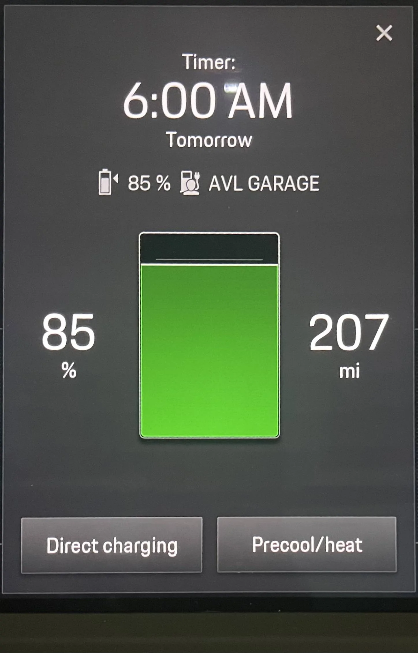

I have a 2022 RWD. One of the options I bought is the performance battery plus. I thought when it is fully charged I should have just over 300 miles of range. however when I charge it to 85%, The car says I only have 207 miles of range - see below. is it possible that I don’t actually have the performance battery plus even though I bought and paid for it?
[/QUOTi
If you want to know if you have the PB, you can pay $10 usd and check your Vin in Suncoast parts web page and they send you the vin decoder with all info of your car.
That is totally normal. And that will drop considerably in the winter at temps 45 degrees and below.

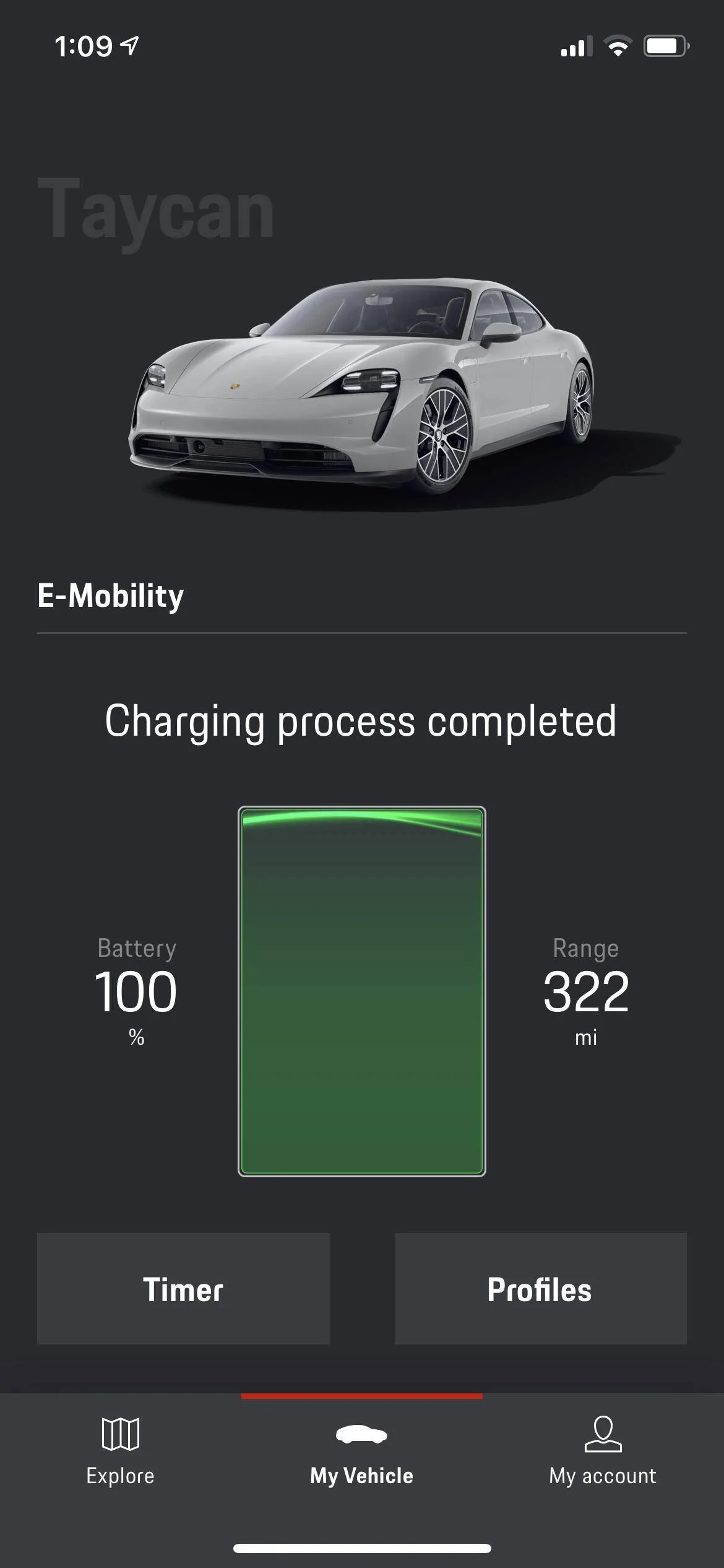

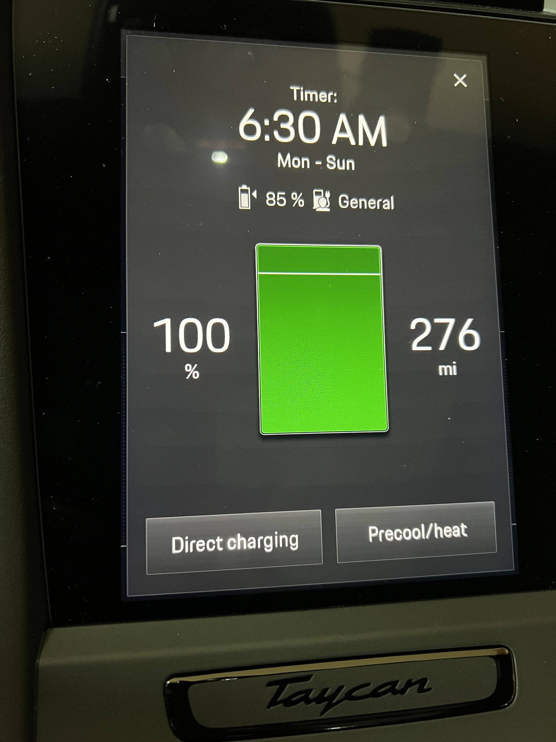

I charged to 100% today as I had a lot of driving to do.
If I extrapolate mine out from 85%, I get about the same as you. I'd also be interested the number of actual miles you get from this charge.
submatrix
May 14, 2021
609
436
2021 Taycan
This was my best range, with PB+, back in Aug 2021. It's not even the highest I've seen on this forum, I recall someone got 330.
