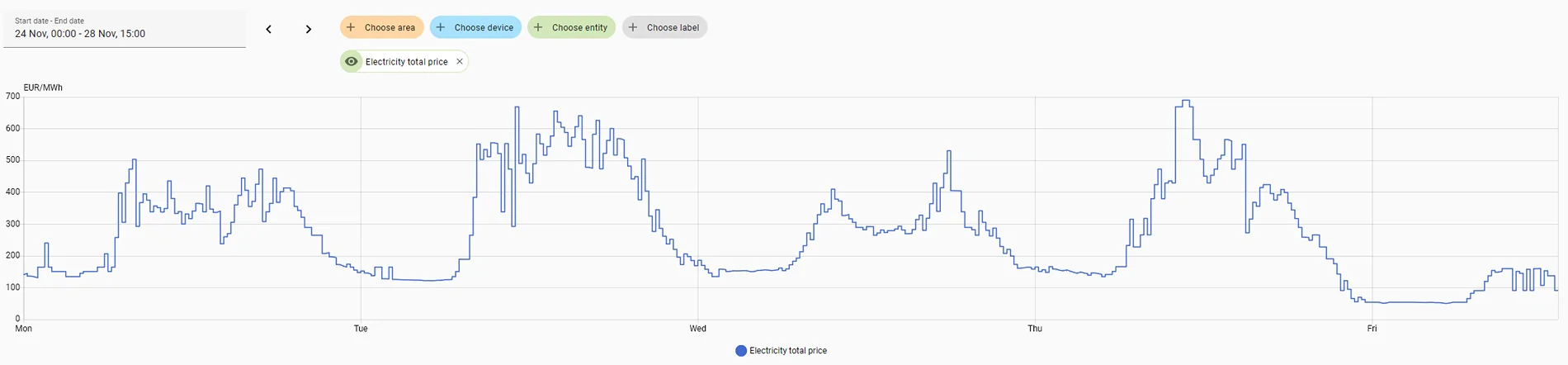

Over here we have free floating price (unless you pay for a fixed package), the price changes every 15 minutes and this week it ranged from 5 cents per kWh to 69 cents per kWh.
Porsche Taycan Considering 1st EV but... 1764328509024-h5

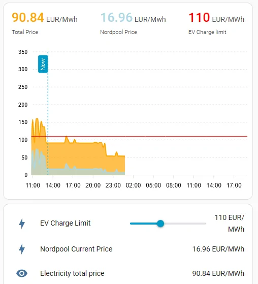

You know the price 1 day ahead, so when you have multiple chargers/EV, then solution is a cutoff price limiter:
Porsche Taycan Considering 1st EV but... 1764328582718-kj
When the price is higher than 11 cents, then it turns the EV chargers off automatically, so I can just plug the cars in and not care about it. Sometimes have to adjust the limit if really need to charge and the price isn't good multiple days in a row.
can you expand on this - what exactly is turning off the charger, is that a separate device you put into the circuit, a feature of the charger itself, or a service your electricity provider offers? i also have floating prices but not sure how to automate. best i can currently do is look at the prices in the phone app and act on it manually. my electricity provider does offer some smart charging capability via gridio.io (are you using that?) but it's talking to a vehicle instead of the charger and thus is limited to supported models (says "VW group is coming soon" and does not look like porsche will be included)
prj
Jan 14, 2025
1,800
2,405
Estonia
www.mapev.net
Taycan CT 4 - 2026
I am using a Sonoff TH Elite. This has a dry contact.
Almost all the chargers on the market usually have a "key" input so that you can wire a key/switch in to turn them on or off.
The key input on my chargers works by exposing two pins that when shorted together block the charger.
So I have those wired in the Sonoffs dry relay to the normally open input. When the Sonoff gets energized by controlling it from Home Assistant, then the chargers are blocked, when it is de-energized the chargers can charge the cars.
If something happens to the Sonoff or if it is manually turned off, then the chargers operate like it's not there.
Just look at your charger manual if you have a "key" or "lock" input on it.
My chargers are additionally networked via CAN and the master sends the "key" status to all the slaves, so I needed to wire it only to the master charger, and it blocks the slave as well. Works like a charm.
