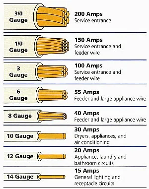

Just out of curiosity, do you think it runs off a relatively normal 100a breaker, or would it somehow need more?
CCS chargers are fundementialy AC/DC converters the ad says it supports 208V/220V - so it should just need/use a normal residential circuit - I'm betting it configurable also for breaker size - so probably adjustable to 50-125 AMP breakers…
220V AC power is pretty straight forward and is rated for like 20'ish kW's (19.2 kW for example in North America) - so it's entirely plausible this unit will work just find on a normal residential install with a 100 amp breaker - wire gauge, wire material, length and termination however needs top notch with no short-cuts taken… 3 gauge or 1/0 gauge wire feeding this unit and it could provide 20'ish kW of CCS/FastDC power… ;-)

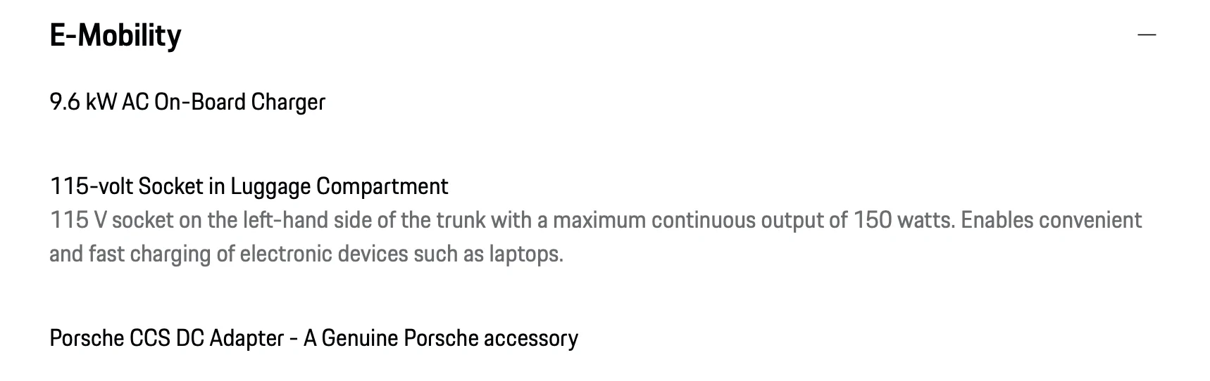

this would be a great unit to feed the new Cayenne EV which for North American says it's limited to 9.6 kW…
the Macan EV charging software supports target SOC% for FastDC charging, but not schedule - so I'm guessing the Cayenne EV will also support target SOC% for FastDC charging and we'll have to see about scheduling support - but ROFL the Cayenne has a Native NACS port for fastDC charging so you'll have to use the included Prosche CCS Adatper for this particular CCS EVSE - unless they offer a NACS charging cord…no big deal but the Cayenne for North America is not native-CCS fast charging port…
