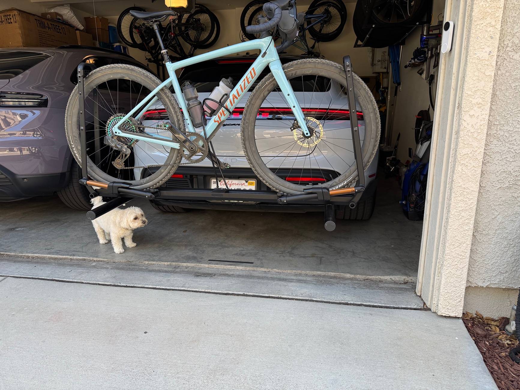

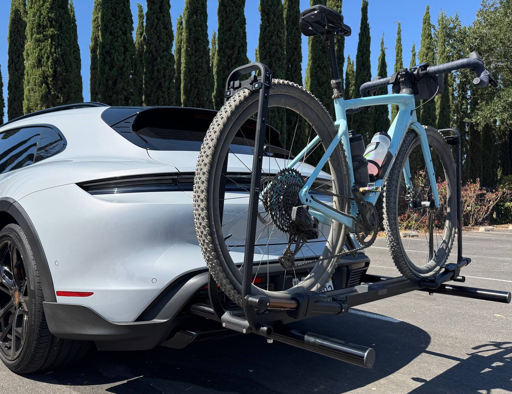

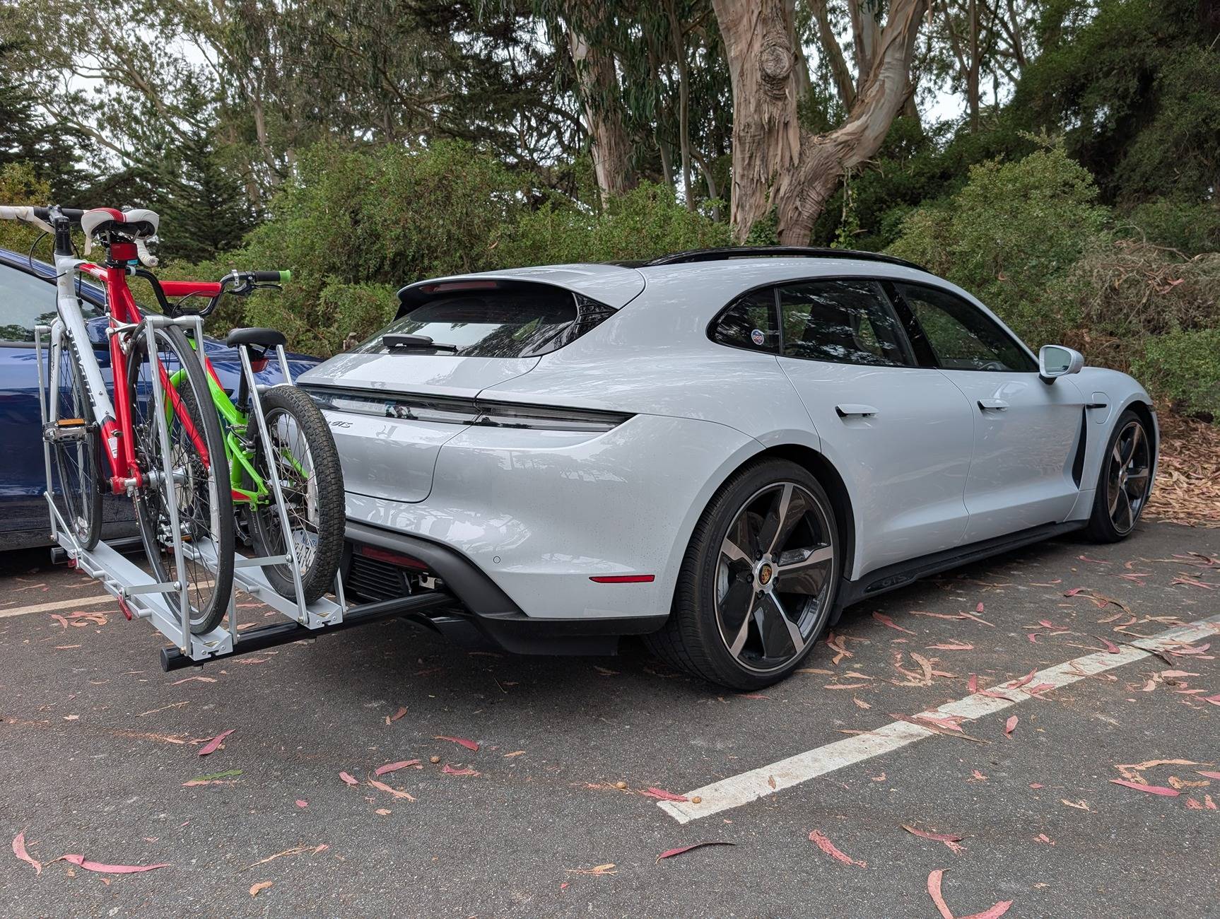

I finally got my Taycan and I can now use the bars I got from Willy earlier this year. I was thinking about how everyone has their must have options for the car, but for me the only real must is a solid way to transport bikes, and this thing is it!
I feel like it's actually more convenient than my 2" hitch Yakima rack I use on my Jeep. Yes, there are two bars instead of one, and there are a few more bolts, but overall it is easier to take on and off because it's lighter and breaks down into something easier to store in the garage. It's also holds the bike more securely, both in terms of the 1up trays having less flex than the yakima trays, and in terms of the 2 bars going into the vehicle having less sway than the 2" receiver hitch.

Looks awesome! Thanks for sharing and glad it's working out.

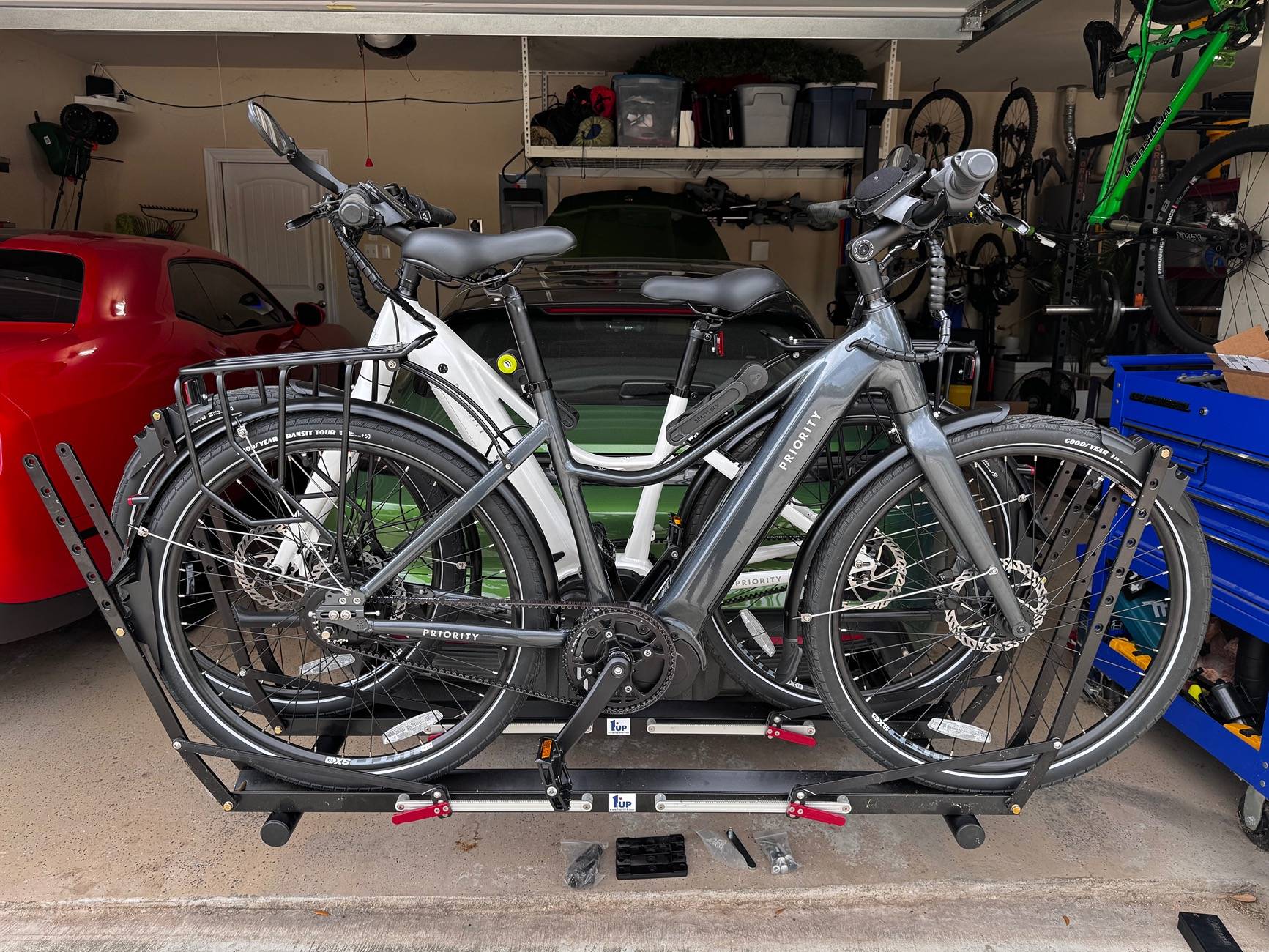

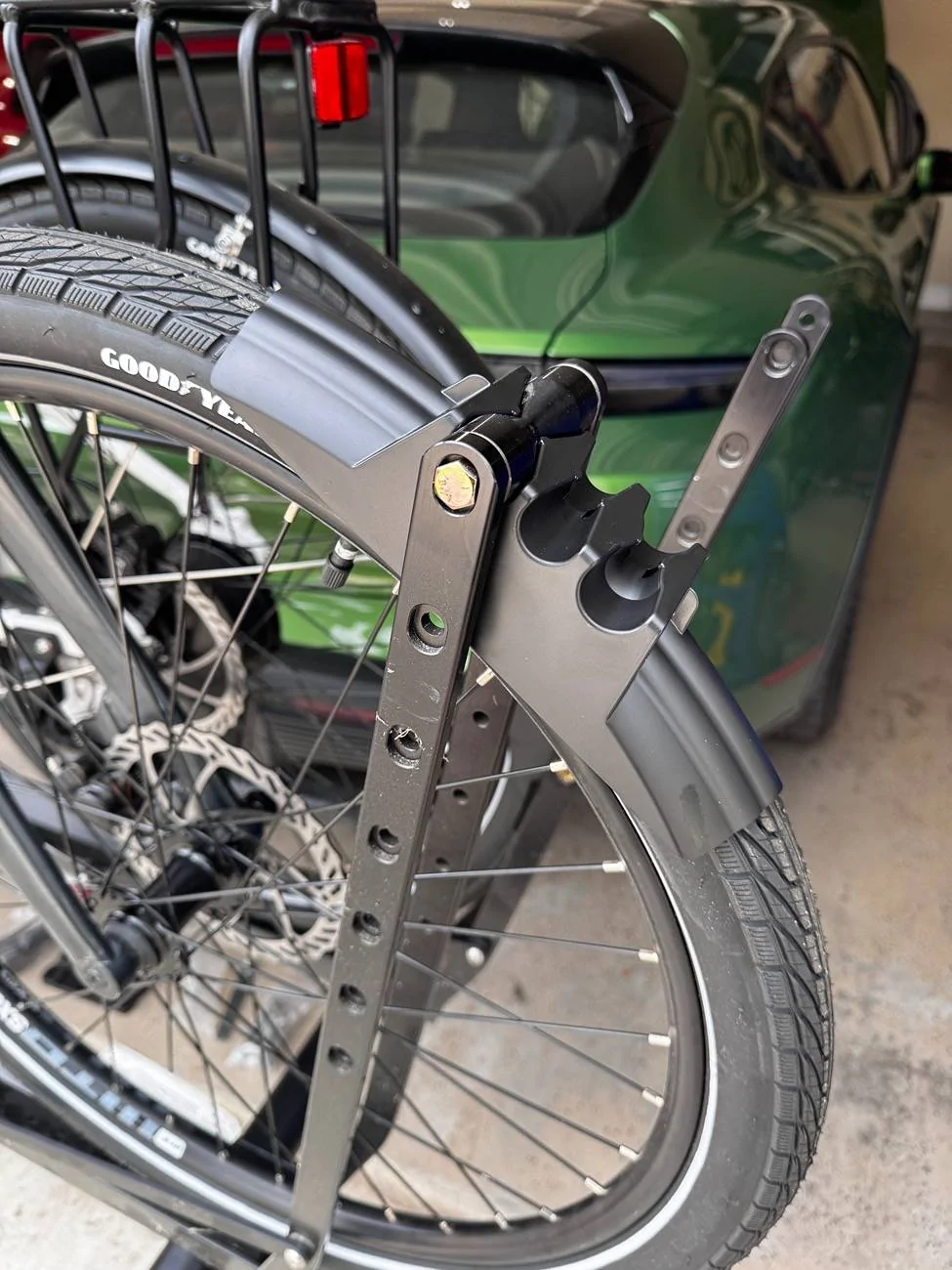

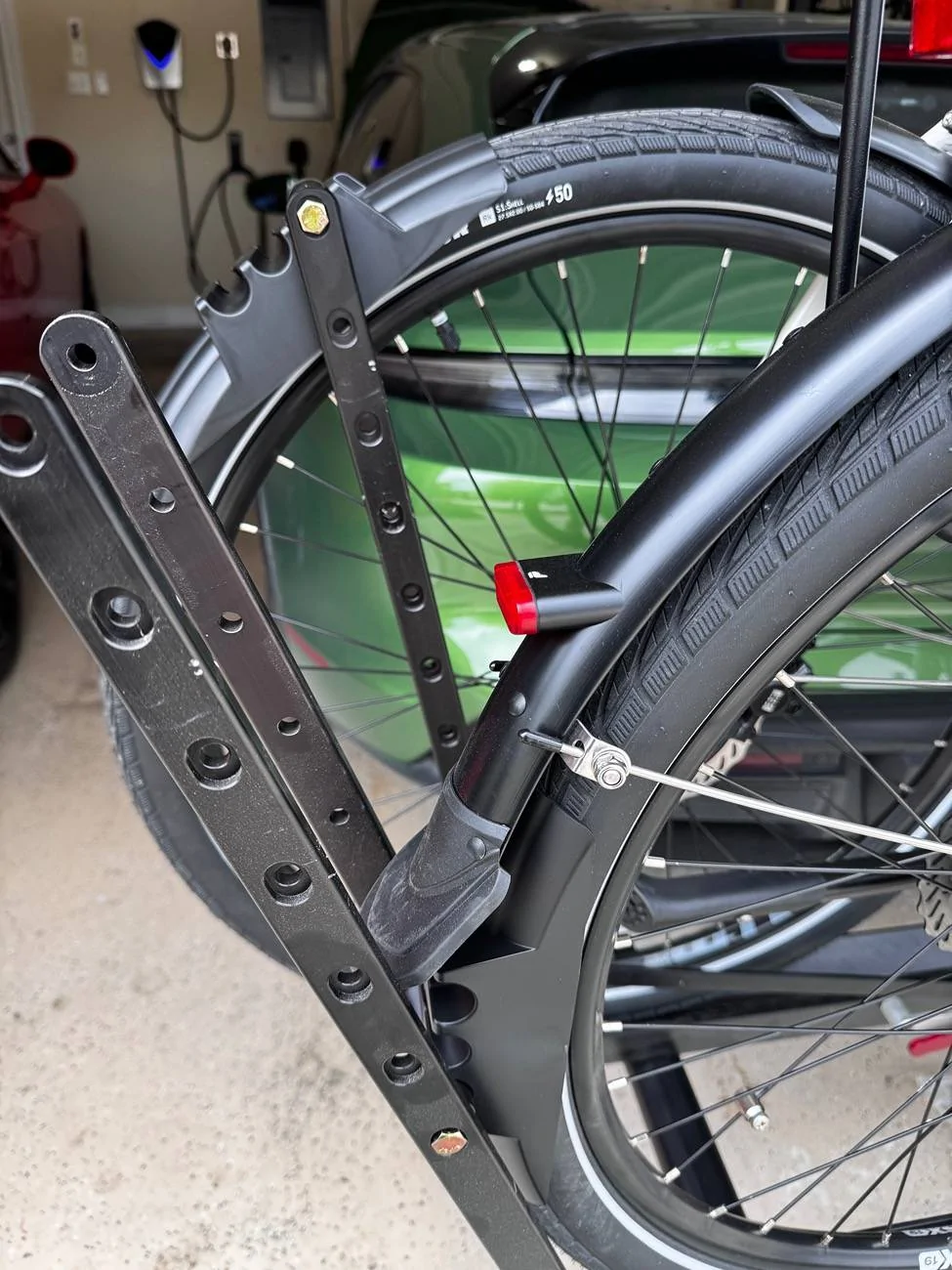

This rack system continues to impress me. Here it is with 2 Priority Current Plus e-bikes on it. The rear fender is a problem that I solved by adding 4 of these wheel saver attachments from 1UP USA.

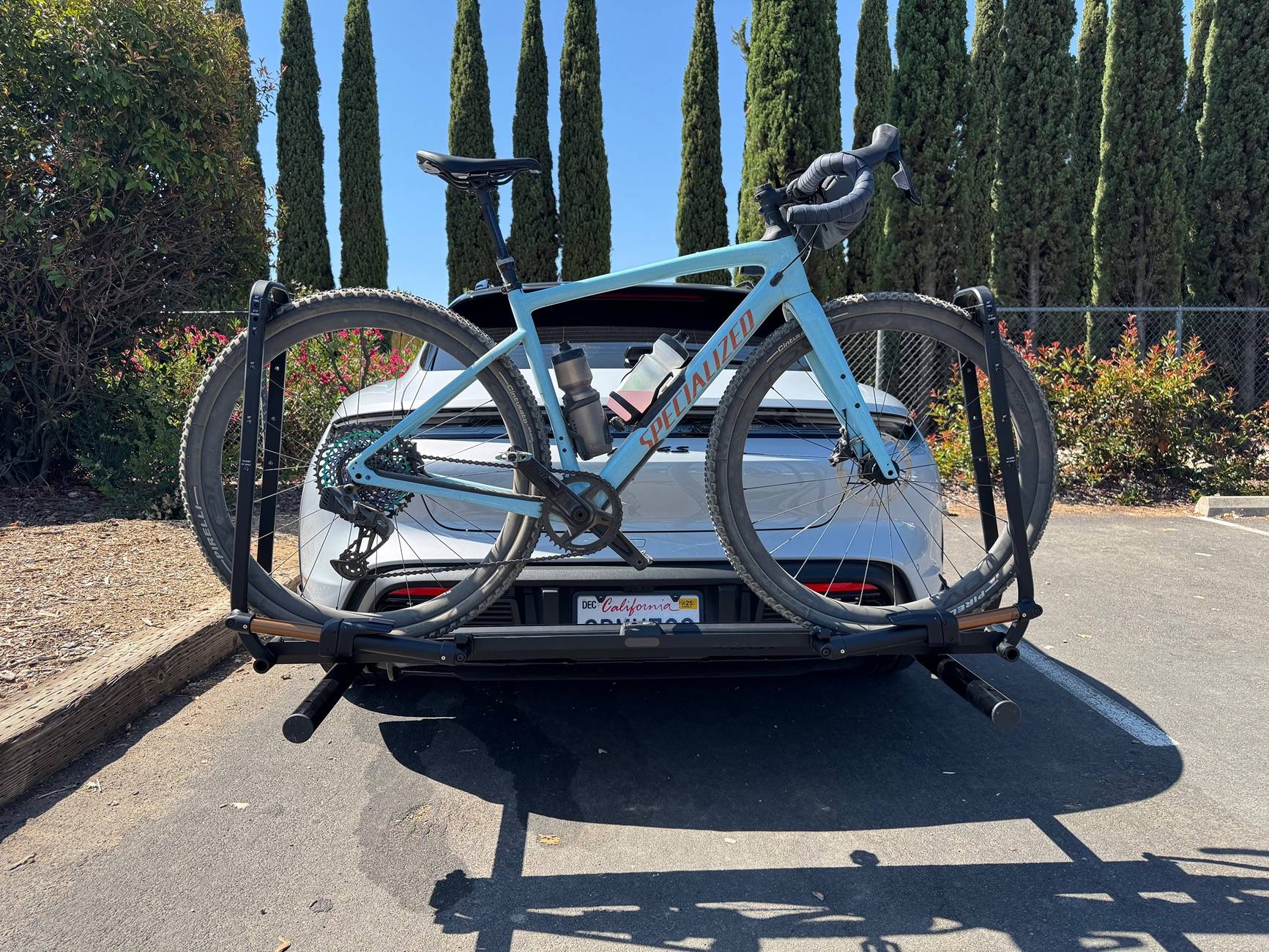

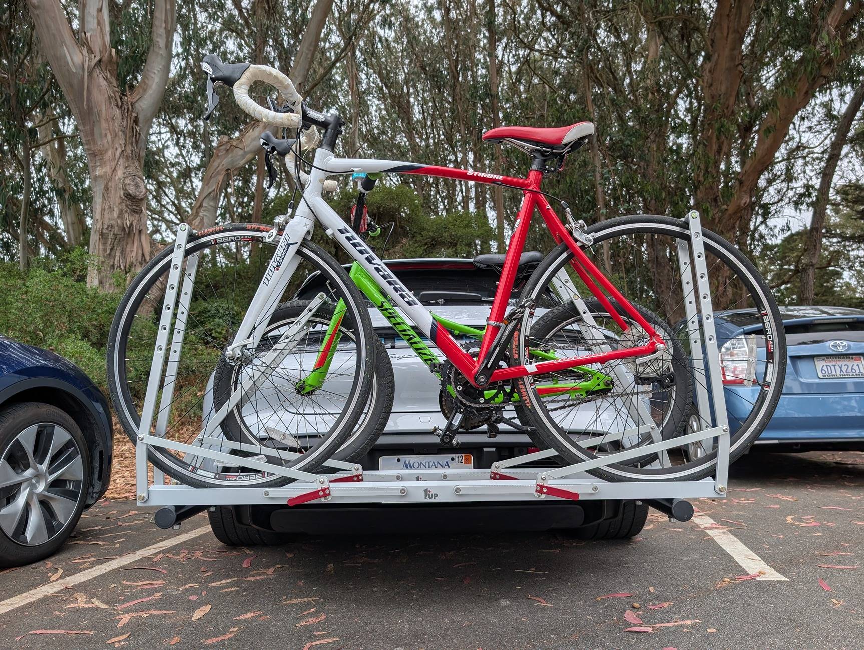

Finally getting around to putting the bars to use more often. Only the gravel bike so far so still need to try the heavier e-bike but no doubts it’s just as sturdy. Kuats are solid and found them months back on sale, free shipping and tax free.

Looks great! Glad it’s working out for you all.

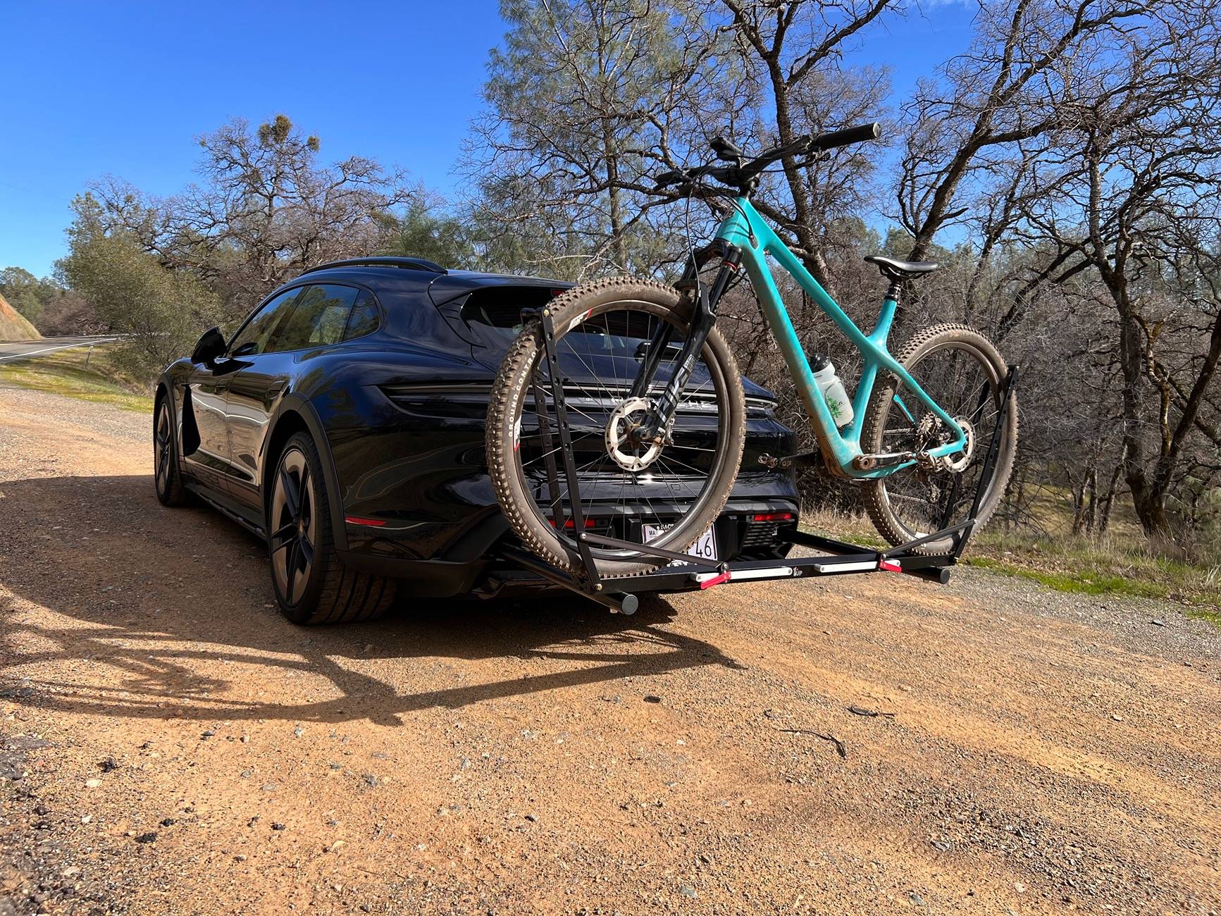

Here is my setup of one of the final batches of these bars. Decided to go with the cheapest 1up mounts.

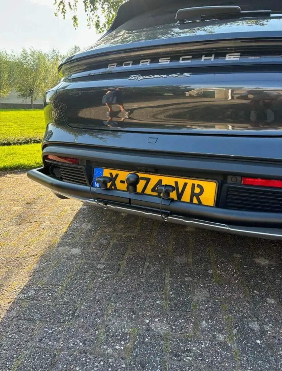

Hi! I still have a few of these available. Would that be of interest to you? With this, you can simply attach a universal bike rack.
