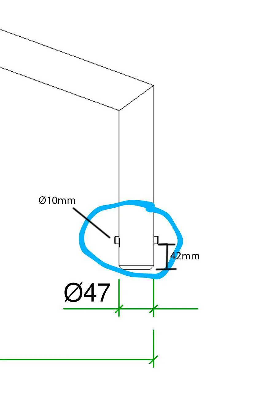

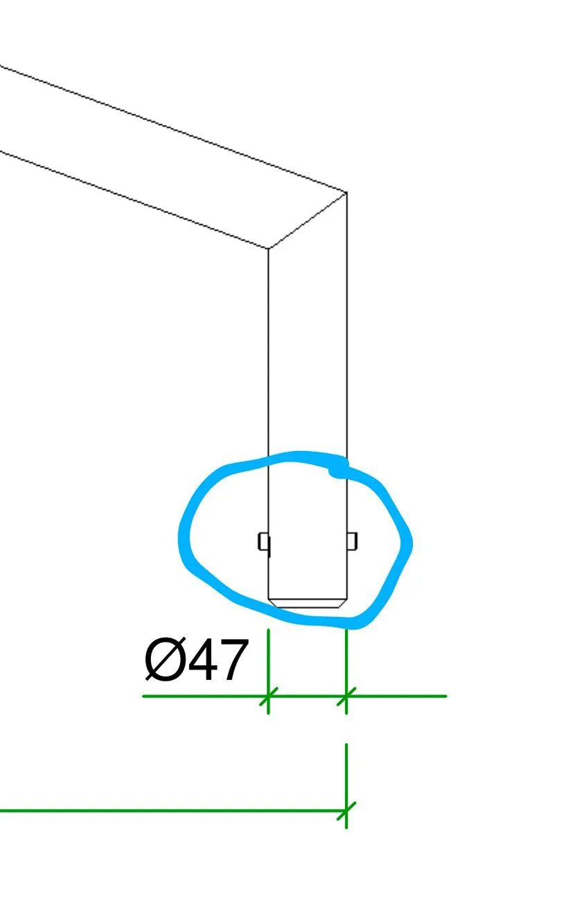

The bolt that acts as a catcher is an m6 with 10mm head. The distance from the middle of that bolt to the end of the tube is 42mm. In my quick photoshop i made it look like the distance is from the end of the tube to the side of the bolt but this needs to be the center of the bolt.

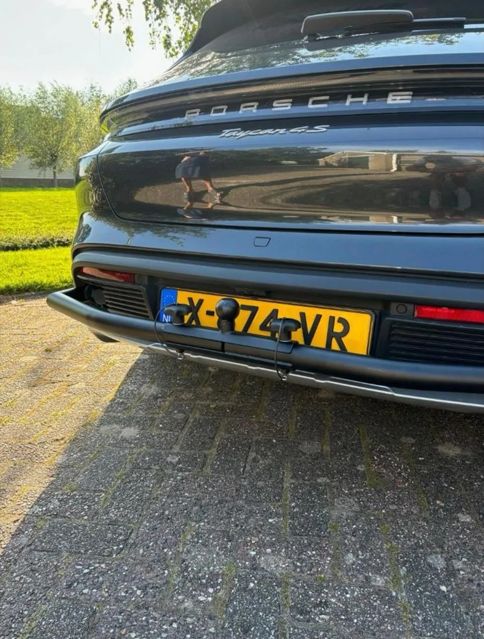

Hi all,
After a lot of positive feedback on this custom Porsche Taycan NG1 bike rack adapter, I still have a few left in stock.
Originally developed for my own Taycan Cross Turismo, but I had a small extra batch produced for fellow Taycan owners.
Important:
  • Designed only for vertical load (bike carriers)
  • Not intended for towing
  • Fits Taycan models equipped with NG1 preparation
For comparison, the original Porsche bike rack (9J0813601) costs around €2,815 new.
Marktplaats listing (Dutch marketplace, similar to eBay):
https://www.marktplaats.nl/v/auto-d...s/m2395808920-porsche-taycan-trekhaak-adapter
Feel free to send me a message if you have questions or want additional photos.
