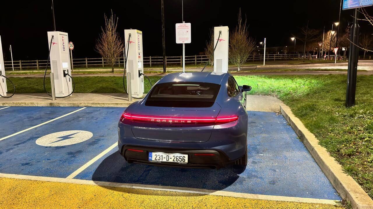

After two hours of driving around on Sports Plus, I arrive at an IONITY station in north Dublin.
Porsche Taycan DC charging issue/failures 1705361888748
This was a small two pedestal location that recently got six stalls.
Porsche Taycan DC charging issue/failures 1705361902889

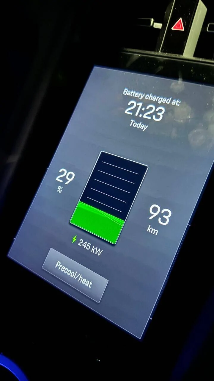

Charging started at a healthy 245 kW.
Porsche Taycan DC charging issue/failures 1705361944810

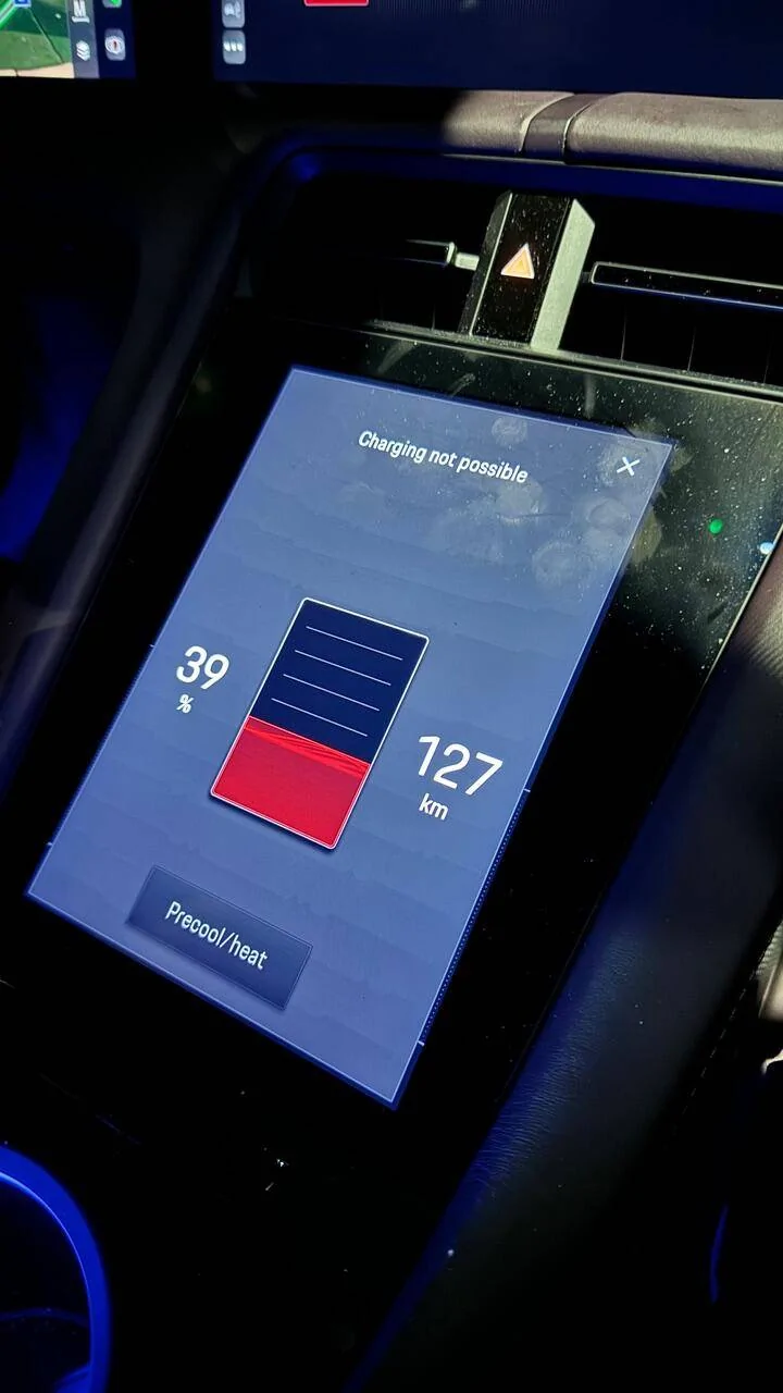

And within about 2 mins and 30 seconds it had failed.
Porsche Taycan DC charging issue/failures 1705361960203
Here is a full raw video (with no audio) of the 2 minute 40 second charging session:

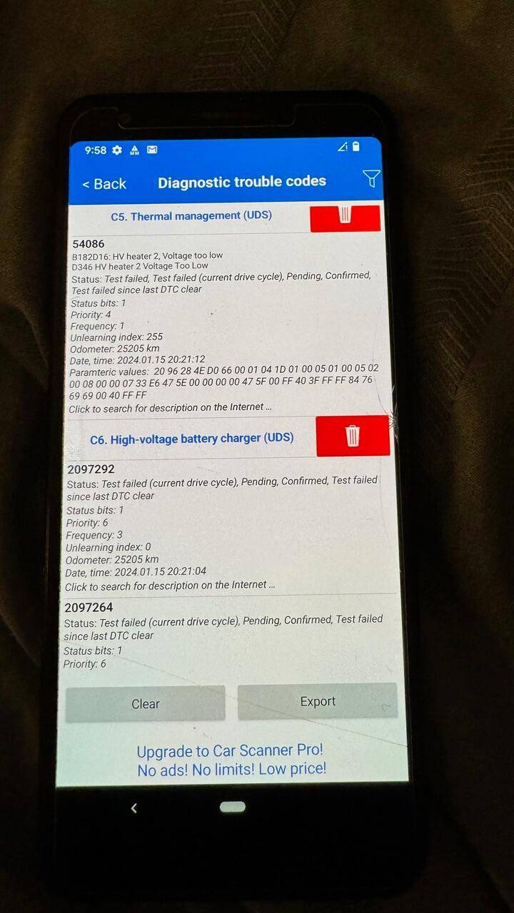

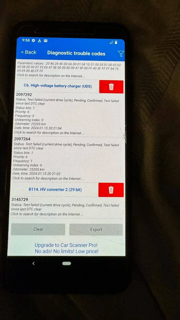

After the failed session, I plugged in a (borrowed) OBD reader to pull the error codes. These were the ones present that matched the charging session timestamp and current odometer at the station:
  1. Code 54086 – HV Heater 2, Voltage too low
  2. Code 2097292 – Quick battery charging (DC), Charging station incompatible
  3. Code 2097264 - Can't find anything on that one!
  4. Code 3145729 – HV converter
Porsche Taycan DC charging issue/failures 1705362261983
Porsche Taycan DC charging issue/failures 1705362269126

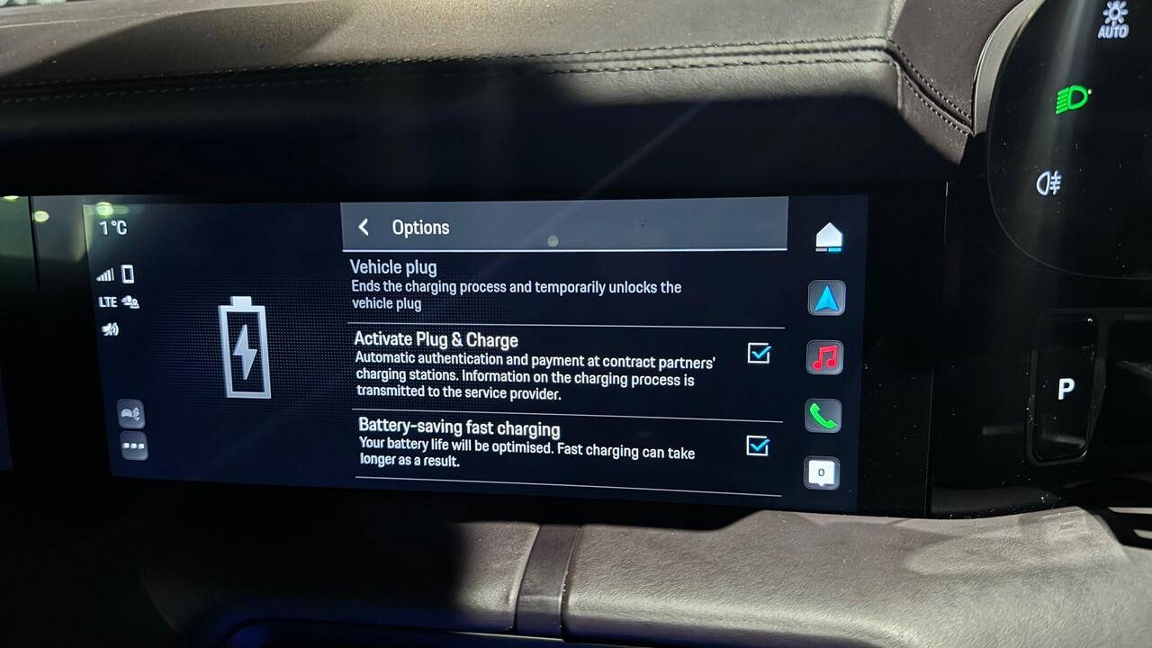

Additionally, I tried a session with "Battery-saving fast charging" mode enabled – to see if limiting charging to 200 kW would help. But that session also errored within 1.5 minutes.
Porsche Taycan DC charging issue/failures 1705362299954
I think next steps is going to have to be to go with Porsche Centre technician and workshop laptop to a public IONITY station and try grab live logs while charging.

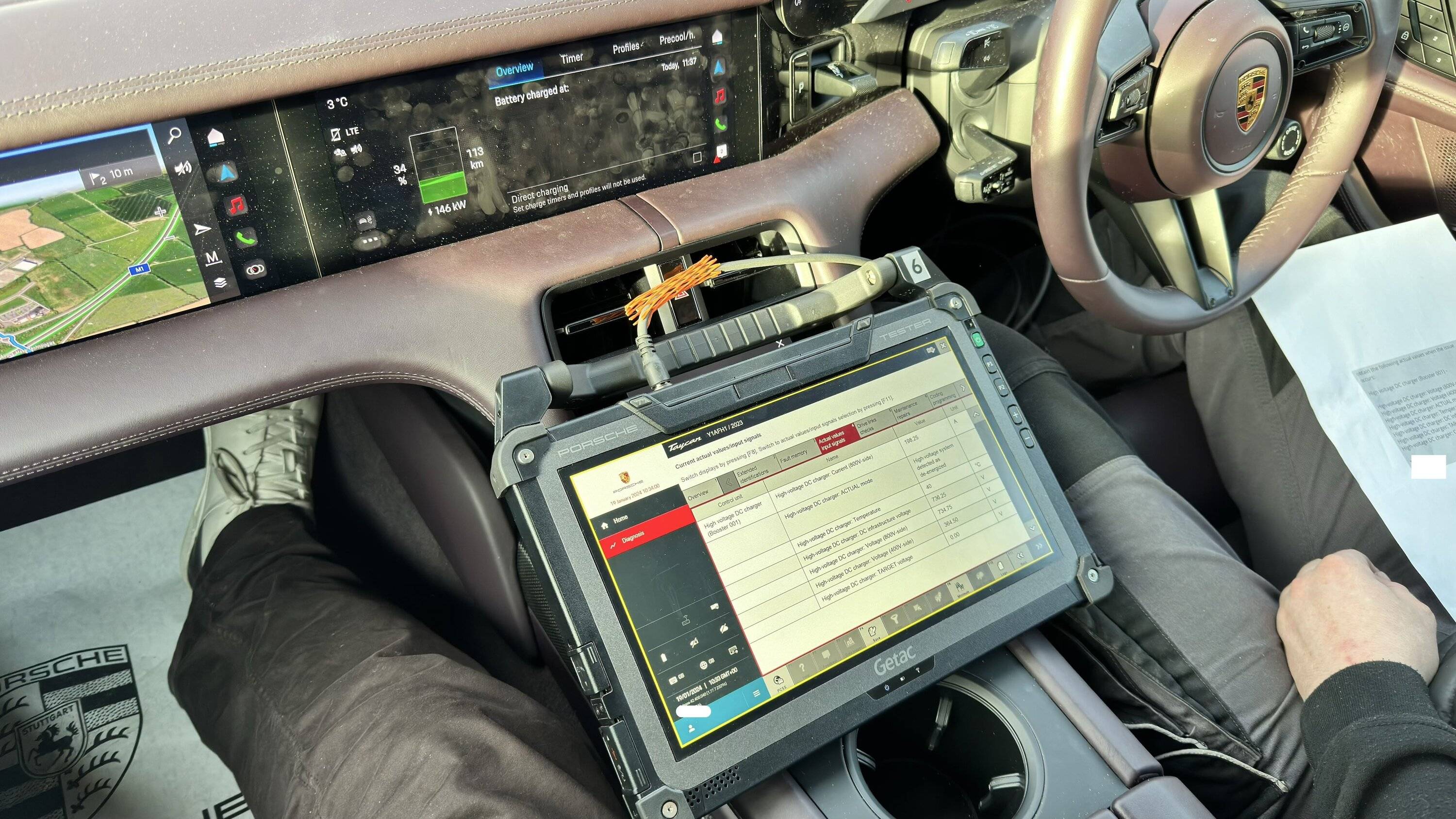

Today managed to get a Porsche Centre technician and a PIWIS to travel 40 km north of Dublin to the nearest IONITY station – to log some values while the failure happens.
Started to log the values that Porsche Germany need to know while the failure occurs.
And what would you know: the failure didn't happen! The first time I've been to a public charger and it not fail in a month!
The IONITY only delivered 147 kW – and we've usually seen the issue when its above 200 kW - so not sure if that was the issue.
So annoying and makes debugging this issue that bit more difficult. I really thought today we'd find out the underlying problem.

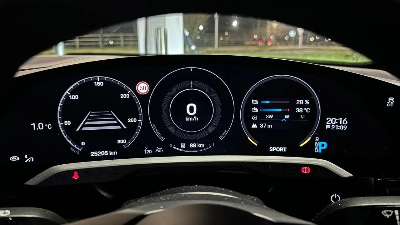

After the frustrations of earlier today I went back to the same IONITY station late this evening. Plugged in and the charging failed within 10 seconds of starting. OMG, why didn't this happen earlier when we had the logging computer plugged in?
I did have my own OBDII logging in place – so at least have captured something.
I walked away for 5 minutes to reset the charger – a short enough period – but I've seen it reset in that timeframe this week.
No luck, charging immediately failed again. I assumed, I had not given it enough time to reset – so I drove to a nearby hotel and had some food, leaving the car sit far away in the car park for over an hour.
Drove back to IONITY, tried two pedestals there and both immediately failed. Stopped in at a 150 kW 400V charger on my way home and it too failed immediately.
Parked up at home – expecting AC to also not work until car is fully reset – but its charging away on AC with no problem.
Right now at time of writing – DC charging is completely broken – and I really hope it stays that way – as it would make fixing this issue much easier.
I am waiting to get a few % of SoC into the car on AC – before going to one more nearby 400V charger to check if charging on AC has fixed anything
If not, I'll awake early tomorrow – try DC again – and if it still is failing – I'll test out at my Porsche Centre. Fingers crossed that the DC Booster was on its way out and has now broken. Please, please, just be regular broken !
