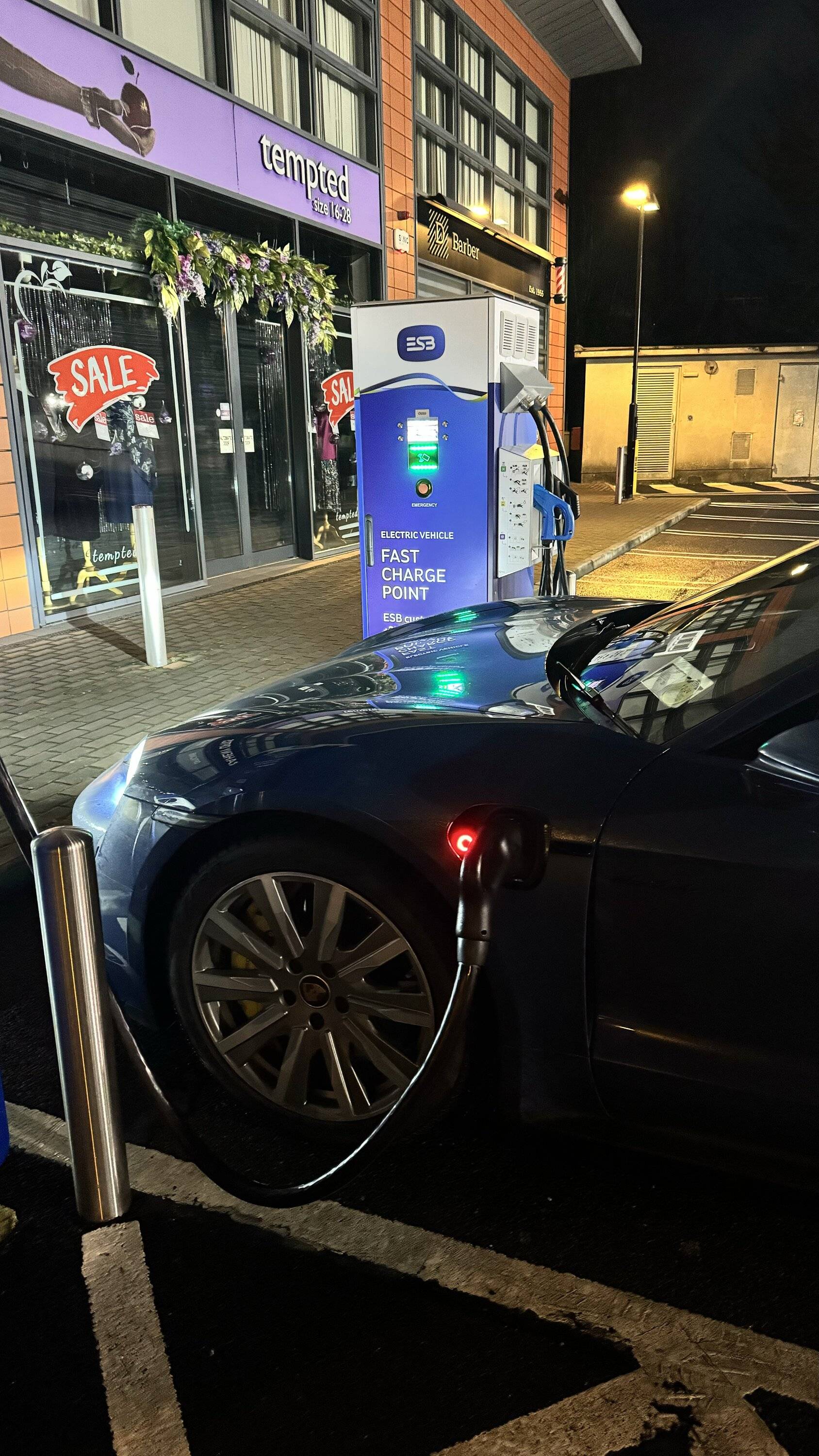

I am waiting to get a few % of SoC into the car on AC – before going to one more nearby 400V charger to check if charging on AC has fixed anything
After an hour or so on AC at home – tried a 400V 150 kW and a 50 kW near me and both instantly failed. So consistently failing across five chargers tonight.

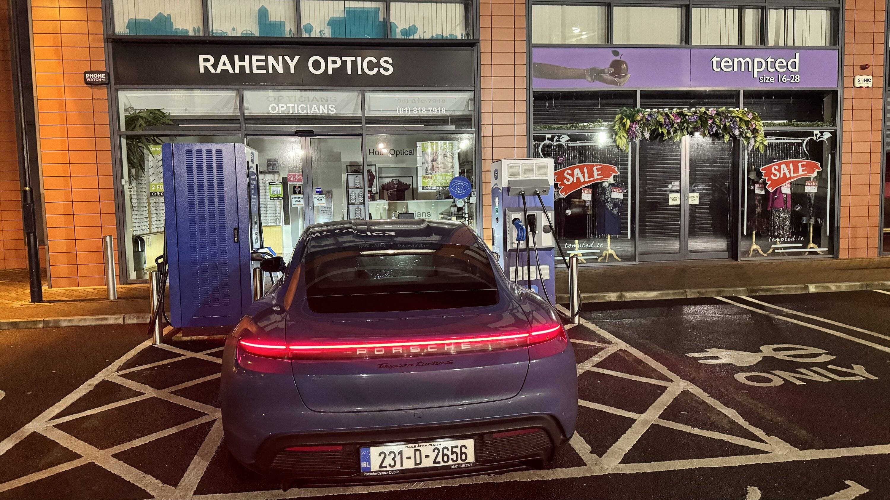

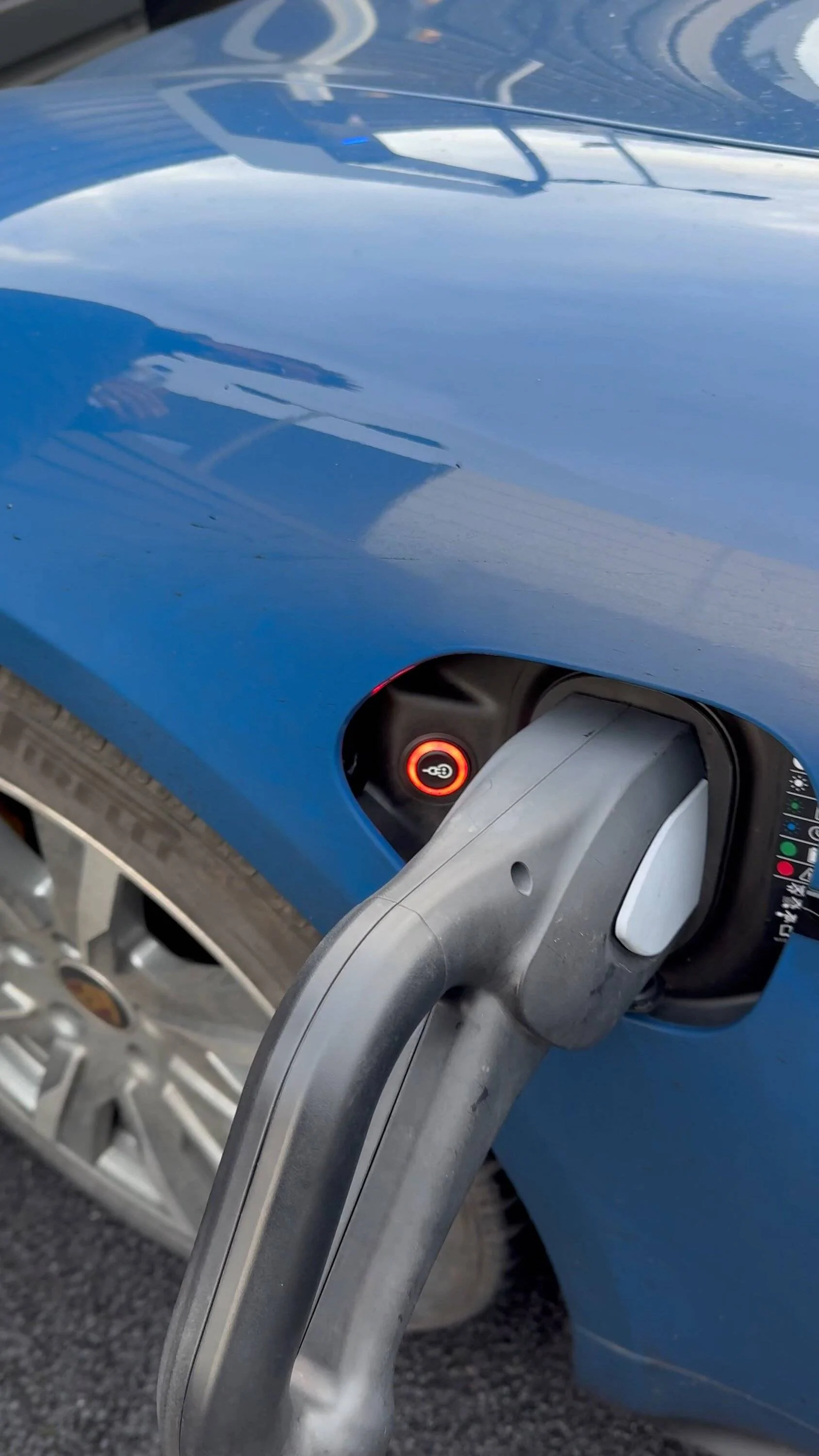

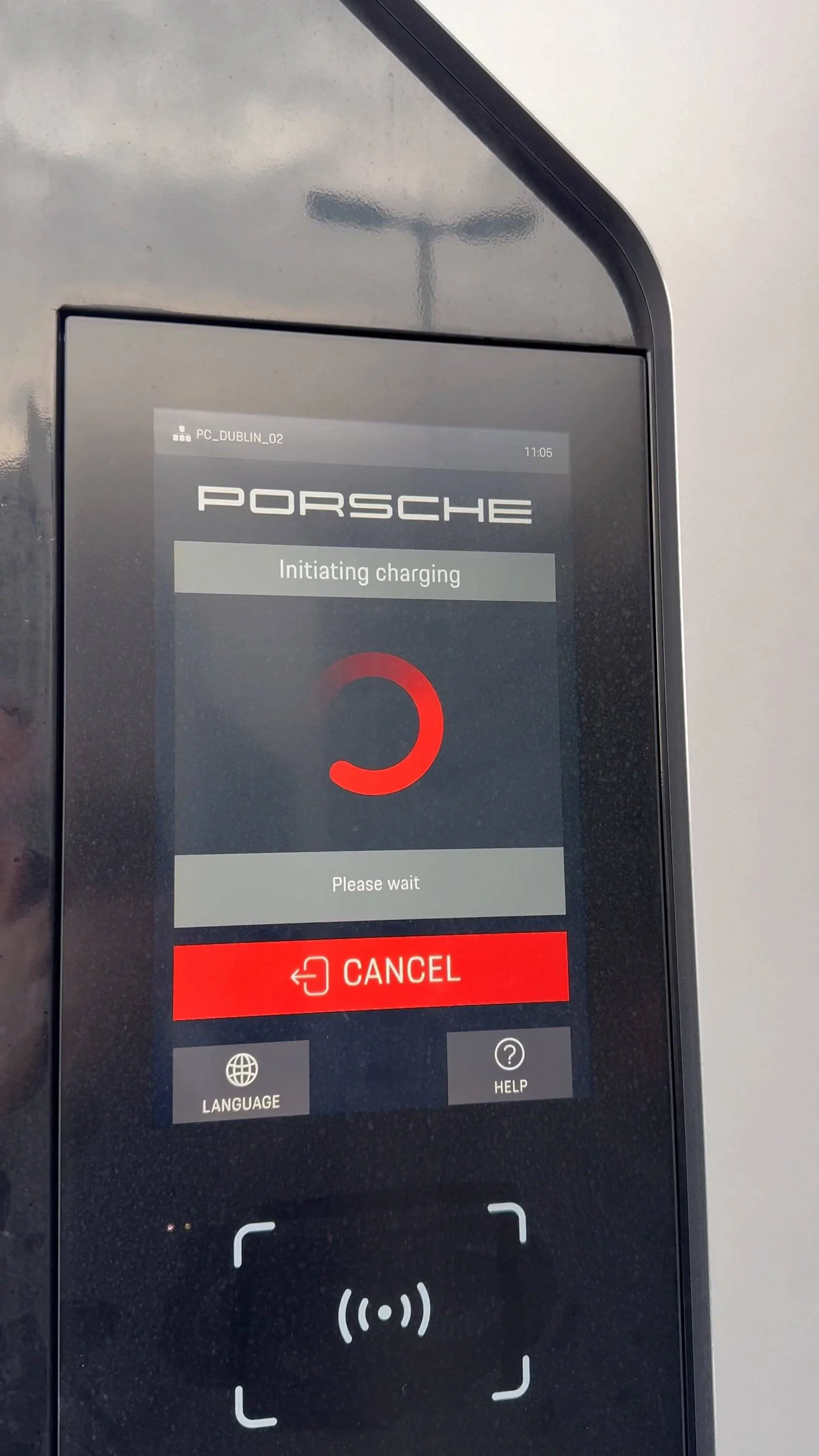

Performing test #11 this morning:

Just back from Porsche Centre and it was consistently broken there too – right where I need it to be.
This should make diagnosis much more straight forward. Now its a race against time to get replacement parts for our Feb 9 deadline to set off for Norway.

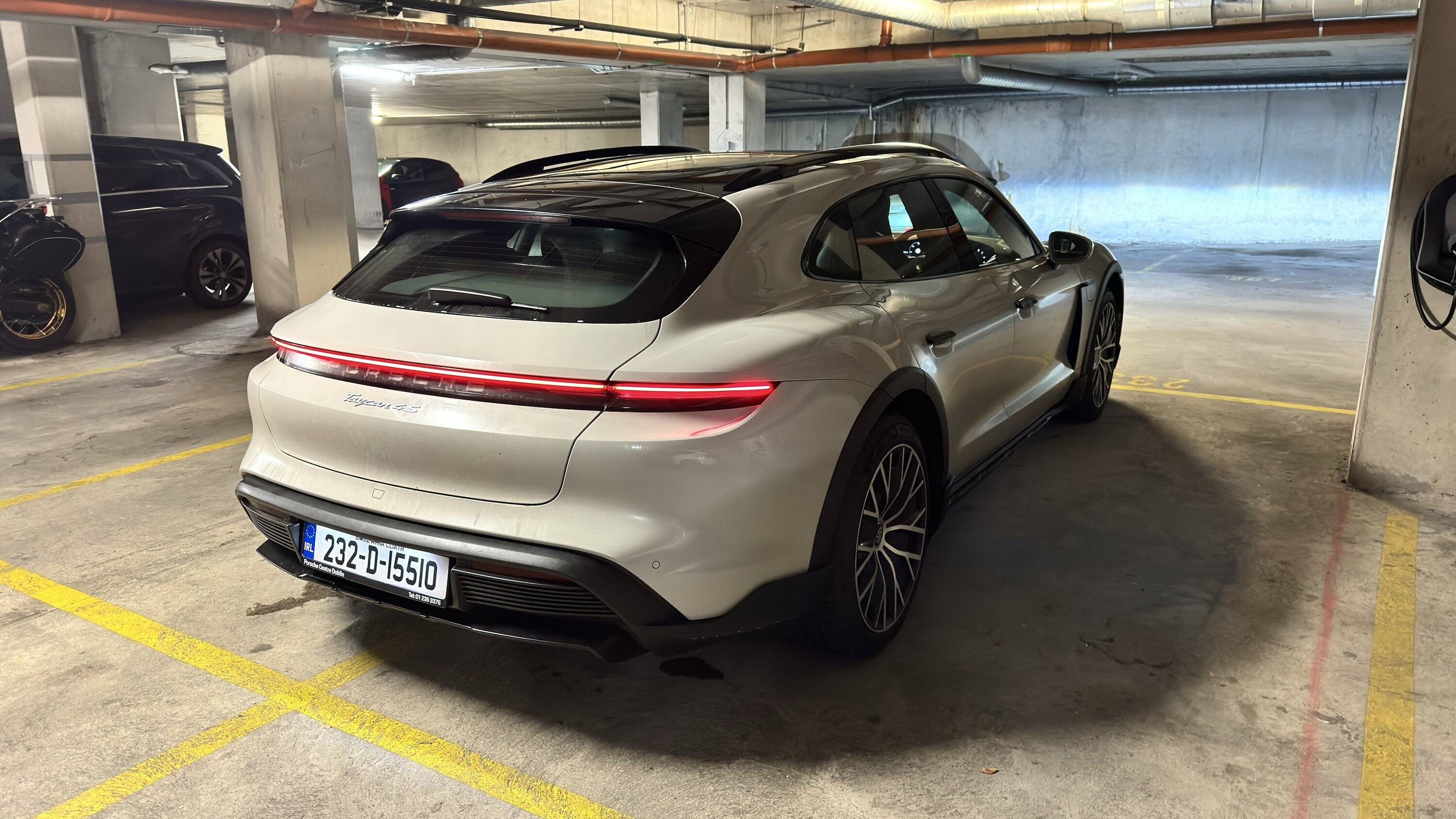

Left my car there and am now rocking a Taycan Cross Turismo – my first time driving that body shape. And it has the compass option – perfect for our roadtrips – I do wish this was offered on the regular Taycan body shape.
