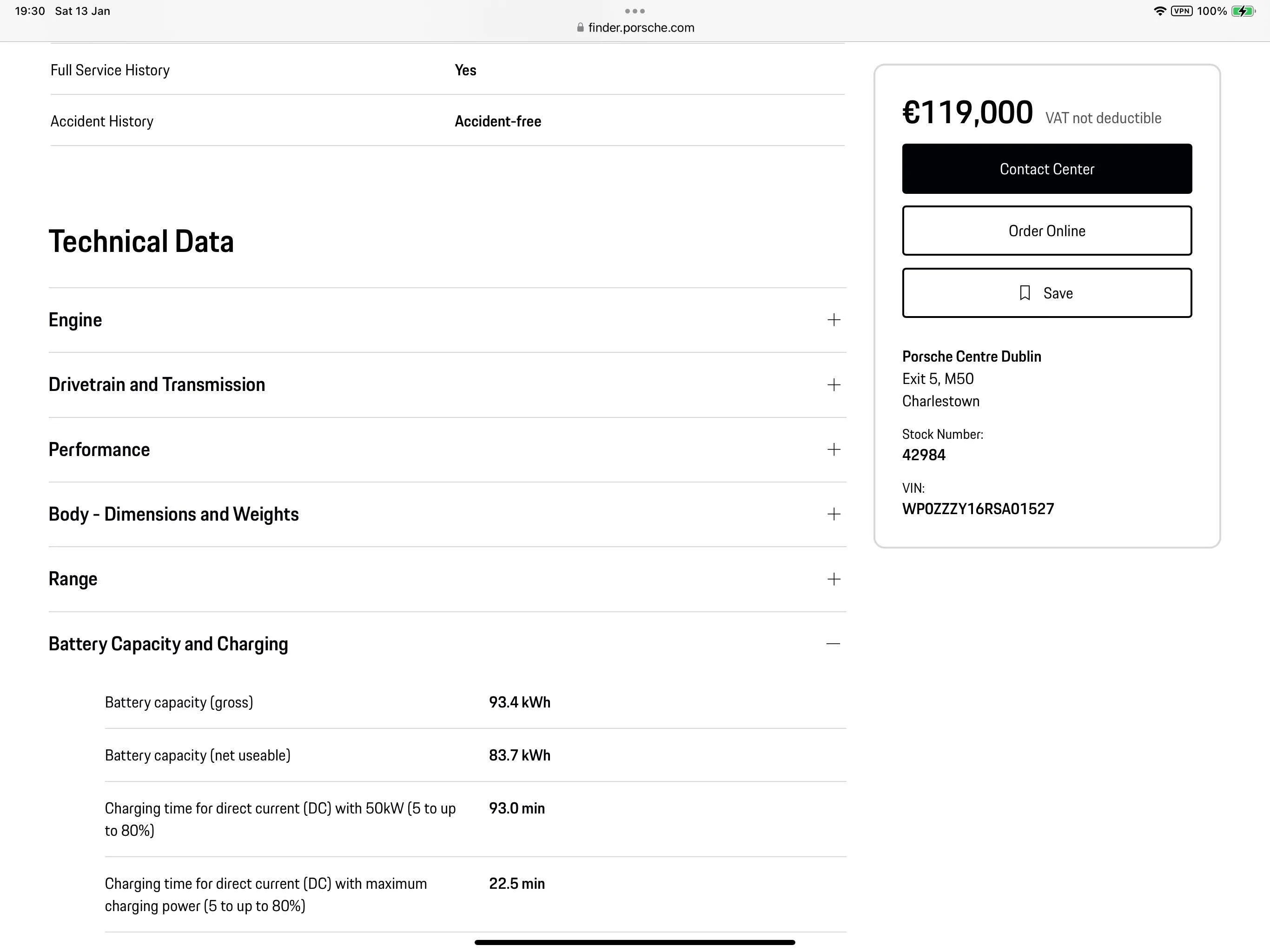

If you set of in a Taycan RWD, I would opt for a car with the bigger battery and also air suspension. Could be useful if snow piles up along your journey.
Thanks @cityhpper – appreciate the advice. The current car does have air suspension – not sure which battery it has. Car still has less than 150 km on it – so regen hasn't kicked in yet. I'll find out from Porsche Centre which battery it has.
3,907
3,552
I still hope you will get your own car back though. It is such a great experience to test the car in proper winter conditions.
